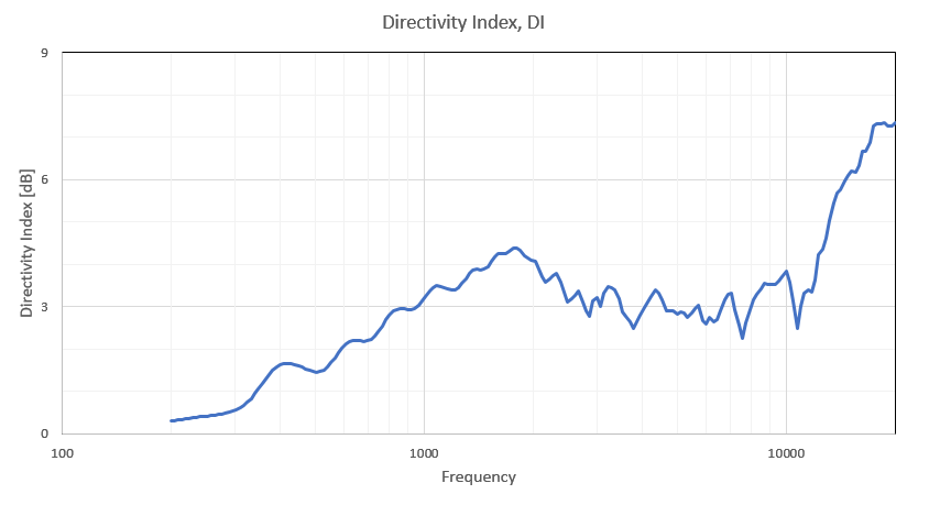

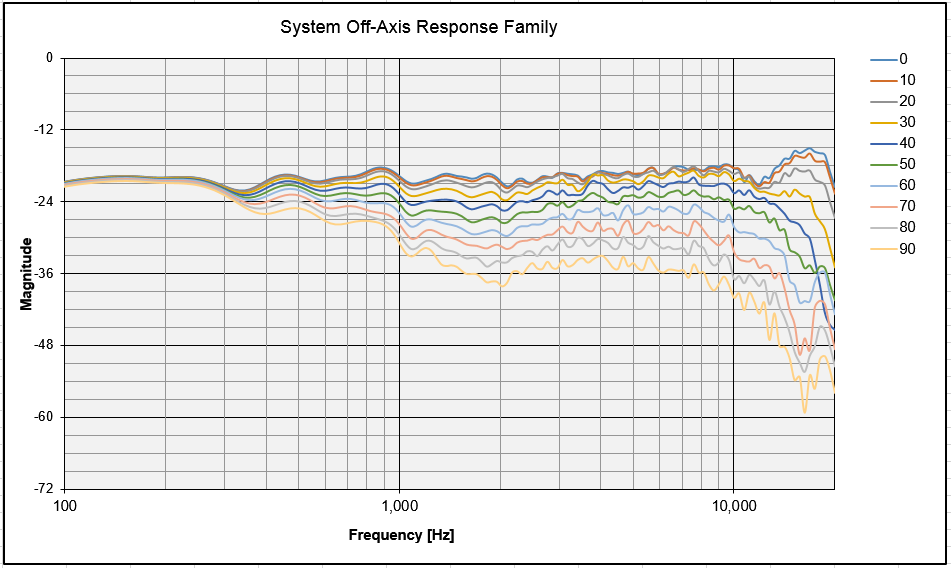

Well after a lot of hard work and re-work and head scratching I have gotten the Directivity calculations up and running. In the end I didn't use the method from the paper linked to above - it doesn't seem right to me based on the definition of the directivity index. So I went back to Beranek and implemented it based on formula 4.22, which seemed to make total sense to me from what I know about integrating a quantity over the surface of a sphere. The results are plotted both in terms of the directivity factor (Q, dimensionless) and the directivity index (the more commonly seen dB scale).
So, things are coming together nicely with this project. I need to review the heatmap plotting - I will be offering this in rectangular coordinates as well as in polar coordinates, which is a really cool way to view the data because it's actually representing physical space directly instead of stretching it as the rectangular version does.
One nice feature of my setup is that you can go back and gather more data and put it into the data entry sheet at the "end" (in the first non-filled column past all the existing data to the right). For example if you took data every 20 degrees and then realized that you need to increase the point density near 45 degrees to better resolve a feature in that area you can simply add in a couple more measurements as needed. It doesn't matter whether the resulting new set of data is evenly spaced or not (the angle between measurements can vary). After importing the new data, the user clicks a button and the data is re-ordered as needed and the directivity calculation is adjusted to account for the uneven spacing.
This extension can be used with the ACD tools to model multi-axis responses, or can be supplied with measured frequency responses taken in a measurements package. This makes it useful for a variety of loudspeaker related plotting needs.
Attached are a couple of plots from the multi-axis plotting tool. The first is your usual line plot, showing responses from one-half of the forward horizontal plane. The second is the directivity index for that same data. The speaker is a 2-way with an 8-inch woofer and horn loaded tweeter. Can you see the signature of the drivers and crossover in both plots?

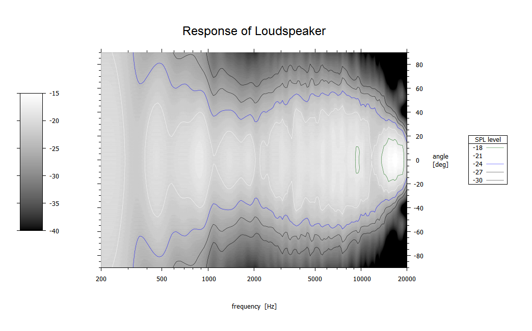

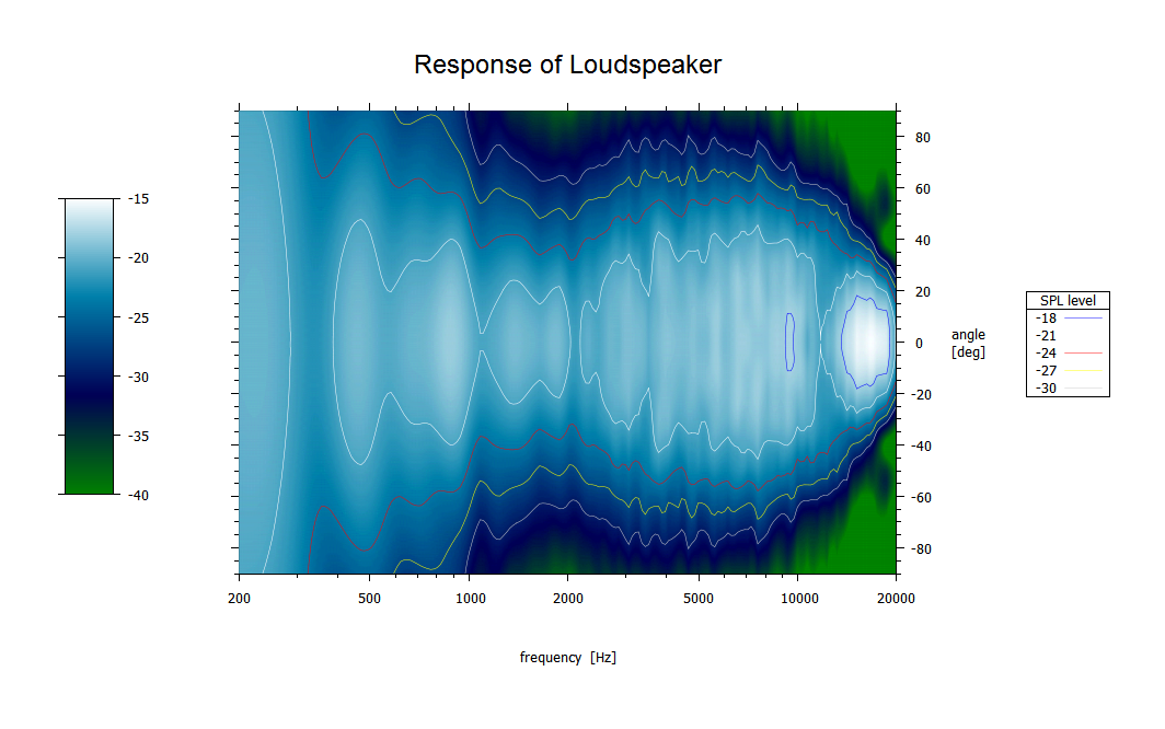

I spent the day working on a "heatmap" plot - a rectangular plot of the loudspeaker's response on multiple axes with SPL level shown using color(s). There is a thread I started back when I was getting into this stuff in the Software forum, but I thought I would post it here now that it is tied into the LADSPA stuff and somewhat PC/computer related.
I used the data shown in the line plot in the previous post and put it into the rectangular heatmap format using a GNUplot script that I had previously gotten working (see attached plots). Today I was working on how to position the color legend and the SPL levels legend, and how to control the colors of the SPL levels. GNUplot can sometimes be a bit of a PITA, but once you figure it out there you go. The user can now control these at will.
I am also able to allow the user to choose from a variety of color schemes for the plot. In fact they can read up on GNUplot pm3d color maps (there is a web page of examples for this) and come up with their own color scheme if one of these is not what they desire. I have given a couple of examples below from the wide array of possibilities.
Hope that this sparks some interest.
