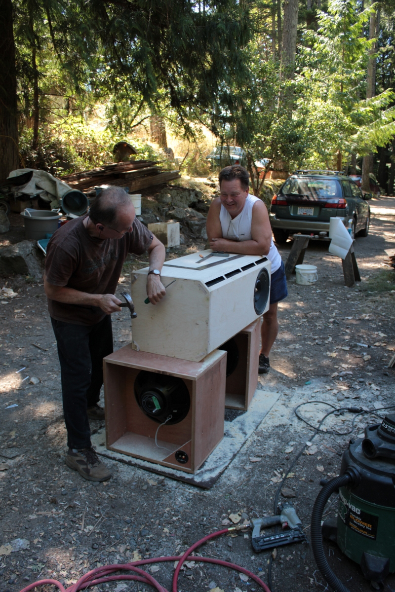

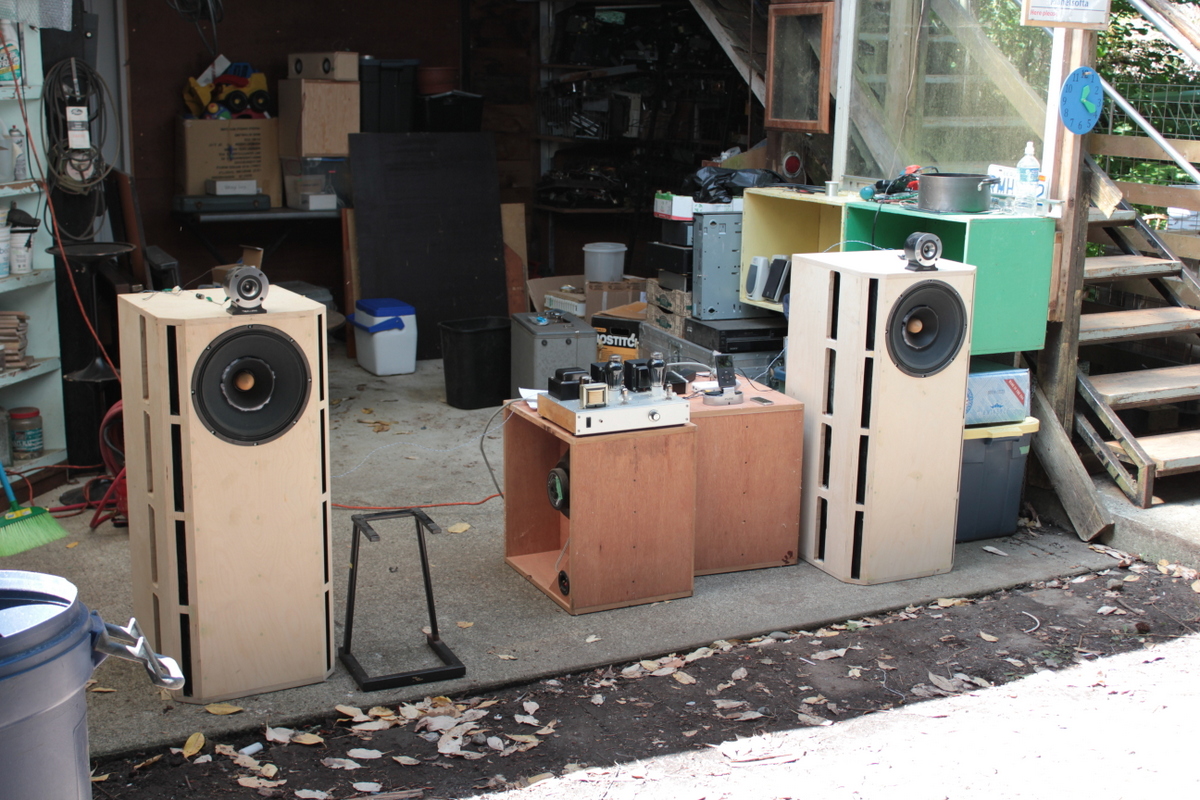

Yesterday as part of diyFEST, Chris redid the venting on our EmKen. Once done (besides a big pile of sawdust), and perched outside on the garage apron, driven by a 2A3 SE (they are proving quite amplifier sensitive), these were vastly more enjoyable... don't know whether it wa snew venting, being in a "larger" room, or the excellent amp.
Sorry to say no measurements can or did happen in the old config.

Here are some photos of the surgery and final winning configuration of the Emken. As Dave noted these were MUCH improved after adding a super tweeter and being hooked up to the amp pictured.
Kyle
