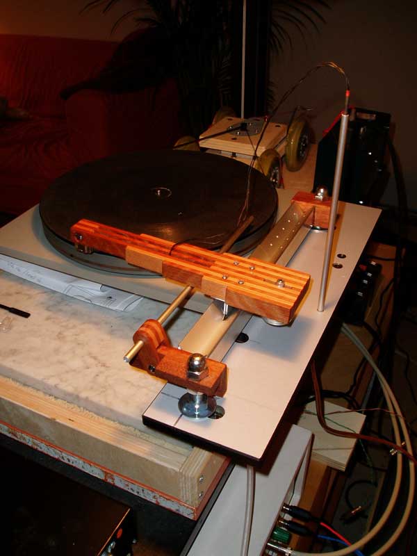

Yesterday I finished my Ladegaard.
Some pictures:
Well done, Peterr!
Looks great, may be a beat heavy? Have you had a chance to measure the lateral resonance fq? What kind of wood is it?
If you want to get its best from this arm, I would suggest to try carbon fiber (damped) arm someday.
My congrats with real world project; not many of speaking here have finished with implementation.
Thank you Livemusic.

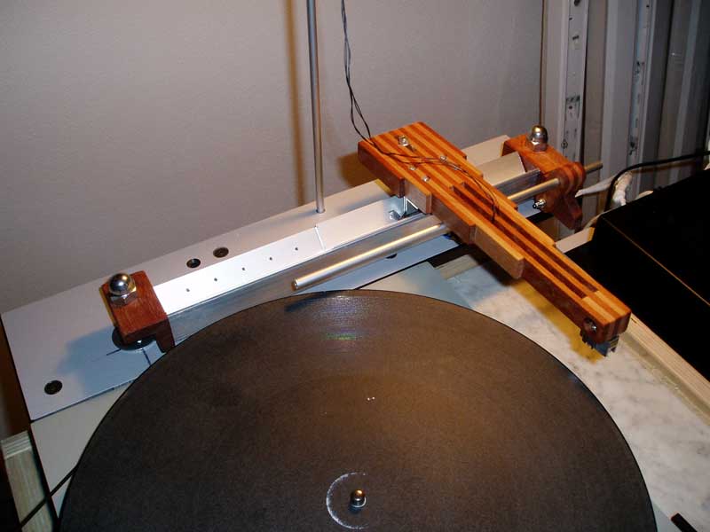

It is not the lightest arm but not as heavy as it looks. Wood is much lighter than metal. (the wood I used is Meranti, simply because the DIYmarket sells these strips).
I can't measure the res freq's but according to my calculations it should be about 12Hz vertical and 3Hz horizontal. These are both within the margins that Poul Ladegaard discribes in his original article.
Yesterday I played some non flat and eccentric records and the arm seemed to have no problems with them.

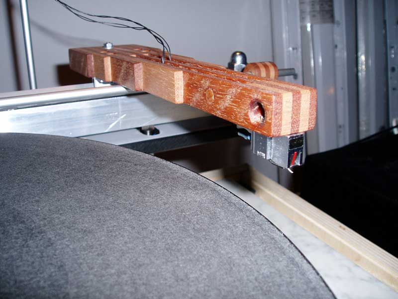

My carbon arm has above 5Hz lateral fq, and compliant Grado felt somehow uncomfortable on it, so it was replaced by D103 - much better. BTW, there was no problem with Grado tracking, the test record's tortue track did not cause any distortion, just I started to feel the sound is somewhat heavy and unnatural with rolled off hights, opposite to "effortless".
I tried five different arm of different design and materials, and the wooden "sandwich" was the worst, in terms, again, clear and effortless sound.
Good luck with your project, I'm sure you have lot of fan with it!

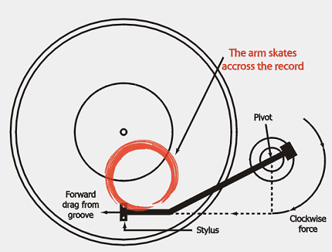

Contrary to what some people seem to believe anti-skating is only applied to classic pivoting tonearms.
Since the direction of support of the tonearm and the direction of force differ, an inside force represented by the formula Fi = µ Wg sin Theta is generated as shown in the picture.
If l=244mm, Theta = 20 degrees, d=14mm, W=2.5gr, and µ =0.4
Tangential tracking arms with a raised carrier rod only show that the initial stiction is too high or/and that the cable dressing is causing too much drag for the cartridge to follow the groove.
Either way, slanting the carrier rod will inevitably result in an azimuth error at all points of armtravel except for the point where it was held at rest and adjusted for.
If Sin Theta equals 0 degrees, as it should, then it follows that no lateral forces can be generated.
IOW the stylus tip will follow a line at the dialed in record revolution.
IOOW, someone's chasing figments of their imagination or is confusing arm assembly stiction with centripetal forces...
