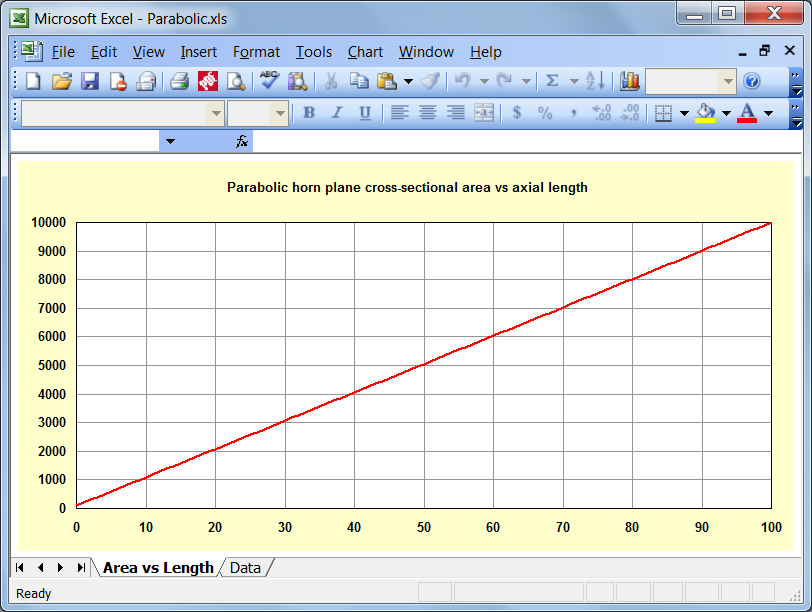

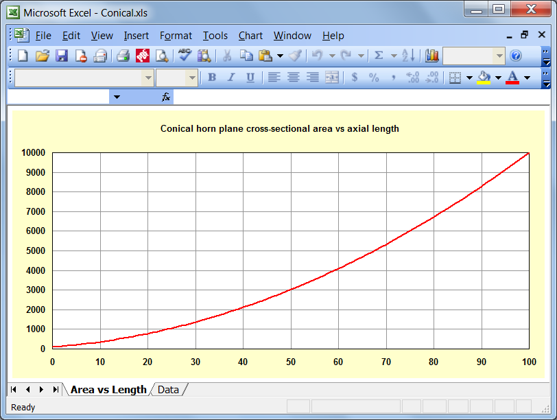

To clarify further.
Attachment 1 shows how the plane cross-sectional area of a conical horn varies non-linearly with axial length.
S = S1 * (x ^ 2)
Where S is the area at distance x from the cone origin or vertex, and S1 is the area at distance x = 1 from the origin.
Attachment 2 shows how the plane cross-sectional area of a parabolic horn varies linearly with axial length.
S = S1 * x
Where S is the area at distance x from the parabola origin, and S1 is the area at distance x = 1 from the origin.
Kind regards,
David

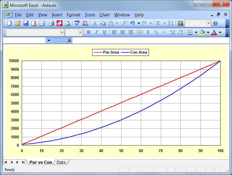

Hi Andrew,
It does - at least at the throat end :).
As can be seen from the comparison below, the plane cross-sectional area near the throat of a parabolic horn (red trace) increases at a faster rate than it does for a conical horn (blue trace). The parabolic and conical horns used in the example each have S1 = 100, S2 = 10000 and L12 = 100.
Note that the chart shows horn area, not horn radius.
Kind regards,
David

.......... the chart shows horn area, not horn radius..........
Thanks for sticking with me.
I wonder if this is where my confusion comes from? Mistaking radius and area in plots.
The red looks like a cone to me. That suggested conical. But is actually parabolic AREA!
And "par" in the data input is not parallel but parabolic !!!

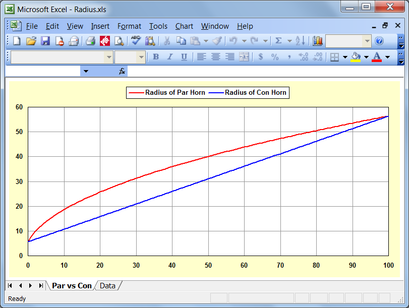

Hi Andrew,
You are correct, the area expansion rate shown by the red trace is linear or "conical". The corresponding radius expansion however (which defines the horn) is parabolic. A parabolic horn therefore has a linear area expansion. Perhaps it may have been less confusing if I had used the descriptors "Area of Par Horn" and "Area of Con Horn" on my initial comparison chart, rather than "Par Area" and "Con Area".
The attachment below shows the same two horns as before, but this time with the radius plotted, rather the cross-sectional area.

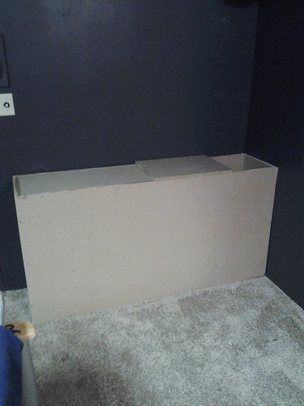

So, I did it.
The sims with the TC Sounds Epic 12 and a 5 mh series coil looked pretty good, so I ordered 2 drivers and built two of these over the weekend. 5 sheets of MDF, 2 full tubes of PL Premium and about 2 lbs of 3 inch screws later, here they are. Figured out a fairly decent way of doing the driver access panel, which was to take some of the front panel and glue it to a larger piece that went the whole width, resulting in a cute "cap" that can be unscrewed if the driver needs to come out. Mounted the drivers this morning and somehow managed to dolly 2 of these cabinets made out of MDF down into the media room. Almost no cussing!
I've ordered a MiniDSP to go along with this. I plan to eliminate the coil once it arrives and I can bust out the microphone and dial them in properly, but let me just say, running some medium level tunes through these just to start breaking in the drivers...the output with a pair of these is nothing short of breathtaking (almost literally).
I'm bound to raise a few eyebrows at gatherings and cause a few giggles during movies.
Color me impressed.
Thanks to everyone who had a hand in the cabinet design.
Edit: A pic of my celebration toast. Cheers!
