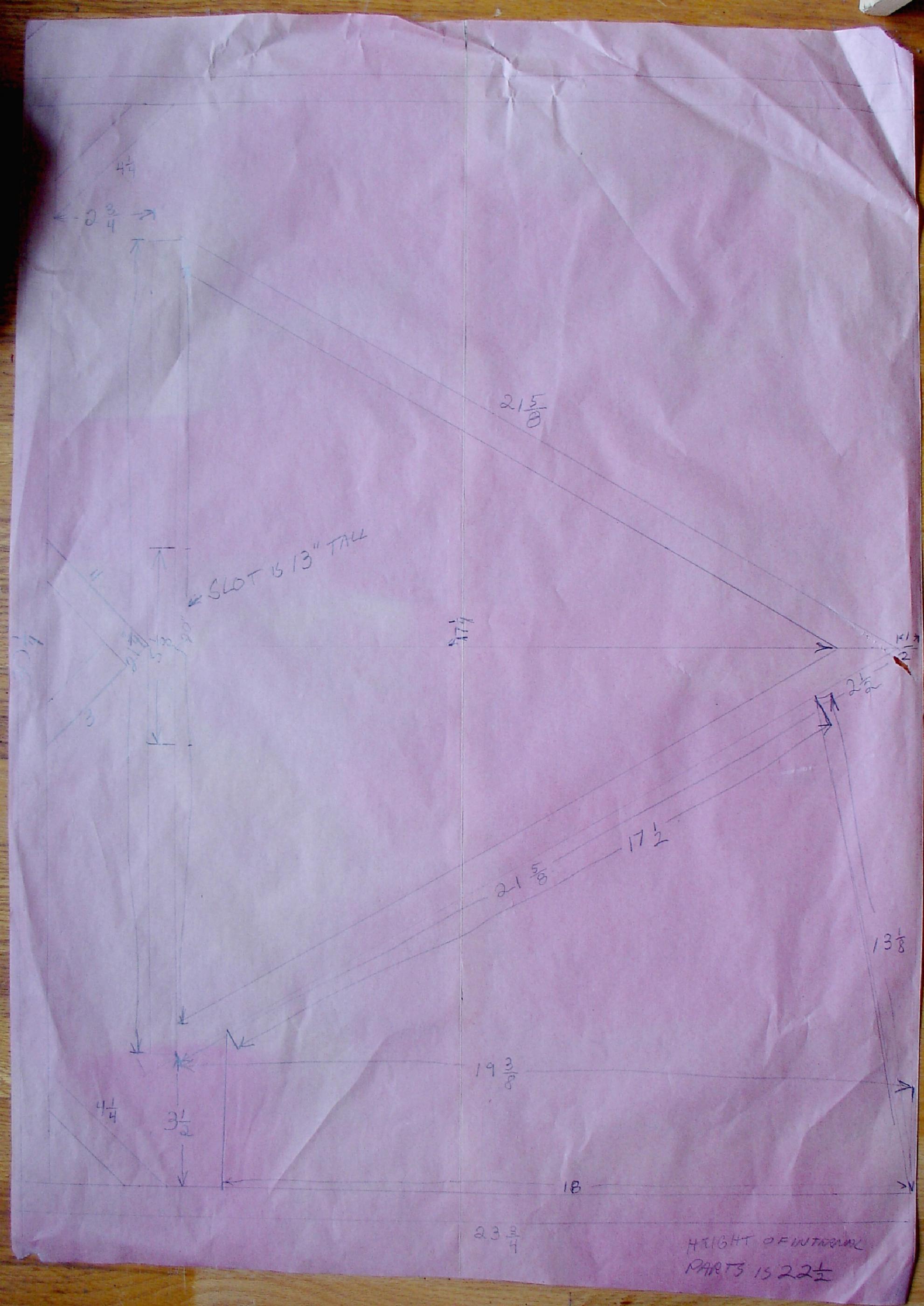

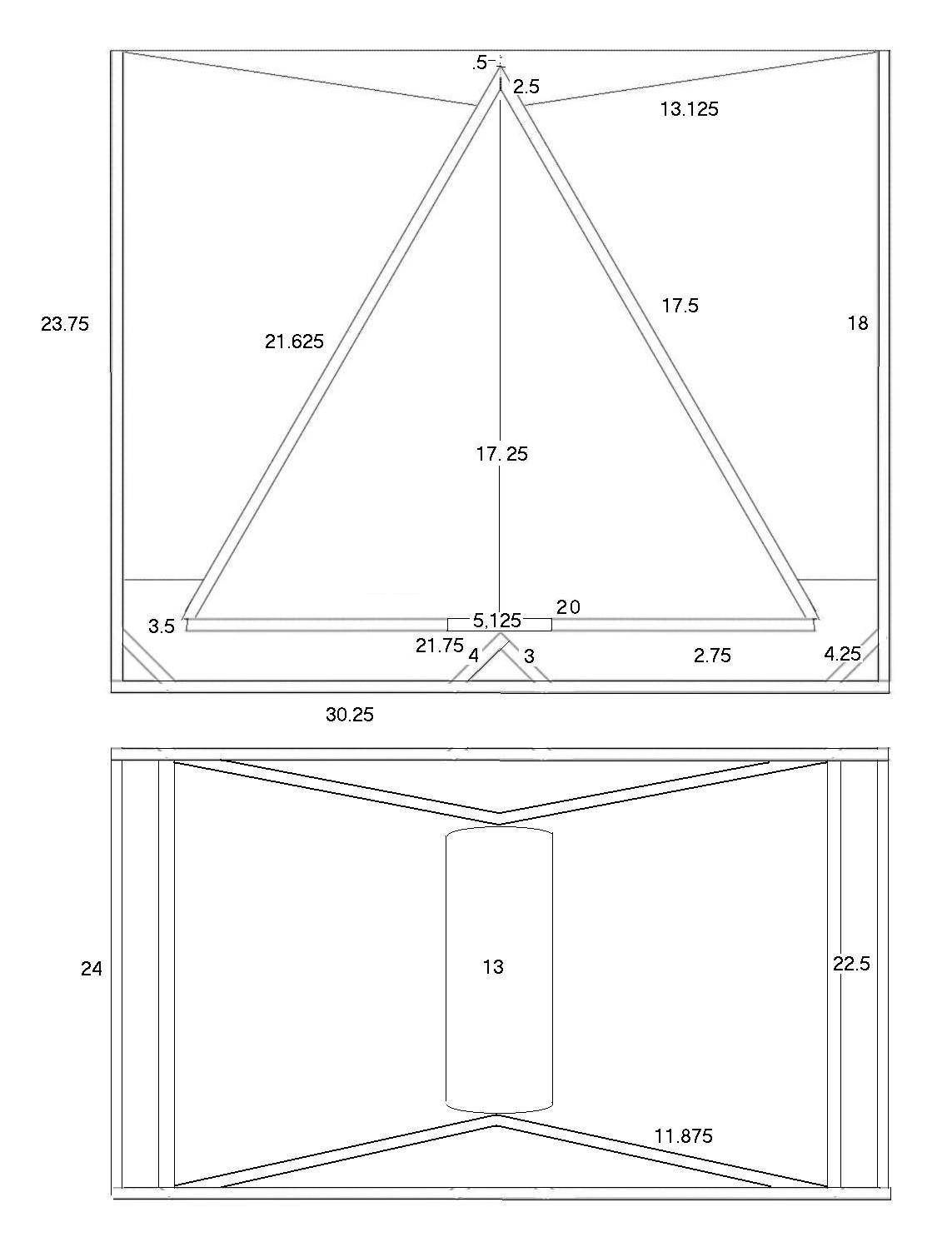

here is a drawing for a Peavey FH-1 which is a better version of the La Scala design, if you need additional info I have it. If you want to go with a purely Klipsch design then go with the Belle which is a better design than the La Scala though not as good as the FH-1. Best regards Moray James.
  • peavey FH-1 plan drawing 3 April 2012.pdf

Moray, would you elaborate on how the FH-1 is better than the Klipsch? I am interested in possibly using this with a Synergy horn for the top end. I realise that subs will be necessary for the deep bottom end. I was seriously considering a ported La Scala bass horn until you brought the FH-1 to my attention.
nothing does sub work with only one box a channel. I agree that people often mistake what an FH-1 does and it is a good design. For starters the FH-1 is braced the La Scala is not. The FH-1 is longer than a La Scala and it does not have the two parallel dead zones on each side of the dog house that the La Scala has. The FH-1 has a larger mouth area han the La Scala does. The FH-1 is what a Belle should have really been, they are almost the same design if you look at the two speakers. You can port a FH-1 just the same as a La Scala. A three way Synergy can get you down to 50 Hz. a FH-1 is the least amount of folding possible and lots of output in a very compact package. From what I am told the JBL is stunning in the FH-1 if you can find a pair to try do so and you can tell me. Good luck. Best regards Moray James.
