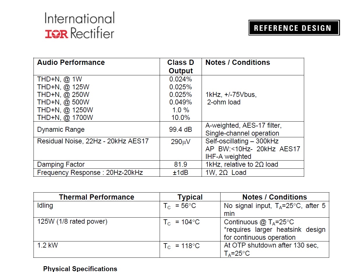

Are you sure you're making IRAUDAMP9?
+ - 75 v dc voltage, and use IRFB4227?
I see the IRAUDAMP9 document.
The temperature inside the report data is as follows
125W about 104 c
I use for a long time for testing.I for improved capacitor model.
All components including inductors, the temperature is below 65 degrees Celsius.
I think it is the ideal state.

Temperature difference. Is mainly caused by voltage.
IRAUDAMP9 hypothesis radiator, under the condition of same temperature is higher. This is normal.
In IRAUDAMP9 PDF document showing temperature under normal circumstances, greater than 104 degrees Celsius.
While L30D essentially no more than 70 degrees.
And work measurement is stable for a long time.
So I think there is no problem currently L30D.
