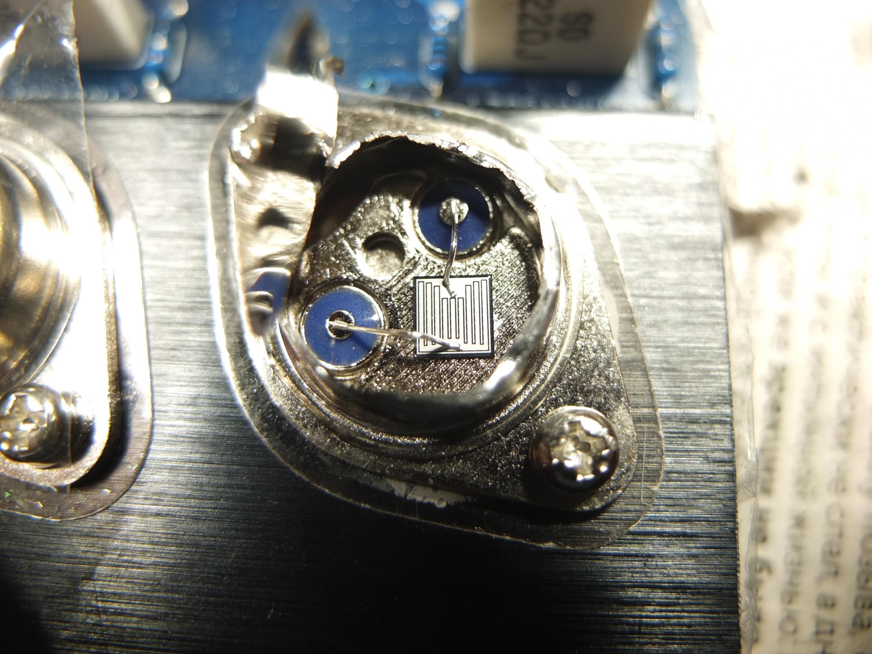

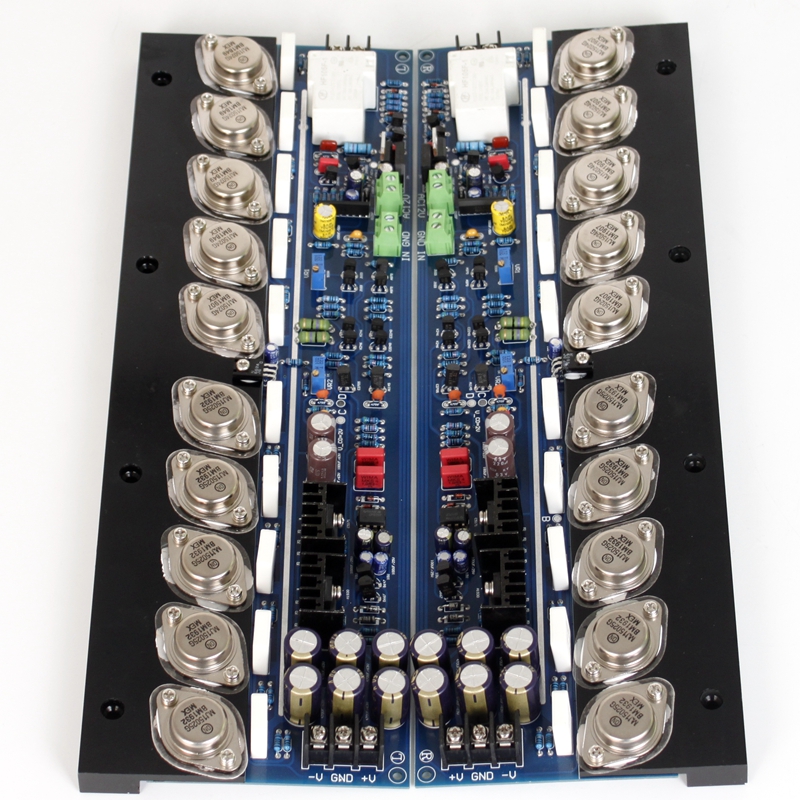

The last time I was checking out amplifier kits on Aliexpress/Ebay, they had a bad reputation due to the fake components and bad layout design. I'm checking out again but it seems that I'm seeing a quite different scene now. LJM kits tend to be most popular and well documented/measured ones. I think I have a little chance to regret on these ones.
There are many options to choose like those based on Accuphase, Krell, YBA designs. I really like the high quality looking of those ones with TO3 metal power transistors. A buyer confirms the authenticity of power transistors on E505 kit.

There's nothing to regret. These midgets are just fine and I will take 3 LJMs boards and populate them with components of my own choice. I intend to use them in a tri-amping system initially conceived on NHB-108 clones. Though, these aren't as good as some "published" results indicate. You should see a square wave response below 100 Hz. Not so great.
There are DIY-kits and you may replace almost everything with components you trust. I've built A60+ from a kit and have added my 5200/1930 and capacitors. I will rebuild it again, more stringently because they deserve more money.
I can understand that every seller on Aliexpress claims that their components are genuine but I doubt their understanding of the word "integrity".
If you plan to buy anything consider seriously purchasing just a board or a DIY kit at the most, otherwise your money is thrown away and you don't get the quality you've expected. That isn't prejudice, just experience.
