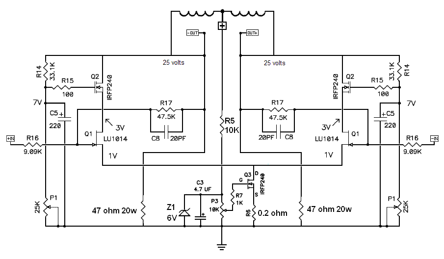

This is where I'm at: I recently recieved a couple Hammond 195T5 Chokes. I tested them in a single and dual JFET gain stage as previously described (1.7A & 3.4A idle current). I can report the curvature of the square wave is gone until down to about 25-30Hz. I guess that's the saturation area although idle current seemed to make very little if any difference... The tilt of the square wave "plateau" is still there somewhat below 100-200Hz??? I think that is the inductance value showing itself. I see a little ringing in the rising edge but that was running open loop. I'm going to aim for a gain of about 8 with 6db of global FB...
I'm currently in the process of collecting some additional components and laying out a PCB to make it nice and tidy. Not sure exactly how to do the chasis yet. Probably going the monoblock route though...
I'll include the latest ideas in a pic :D

Interesting schematic, Lee. Is the 2SJ a smoother sounding fet than the P3310? I was wondering if it would be of benefit to switch the two; let the 3310 be the current source?
Have you given your idea a listen, or are you going for the pcb first?

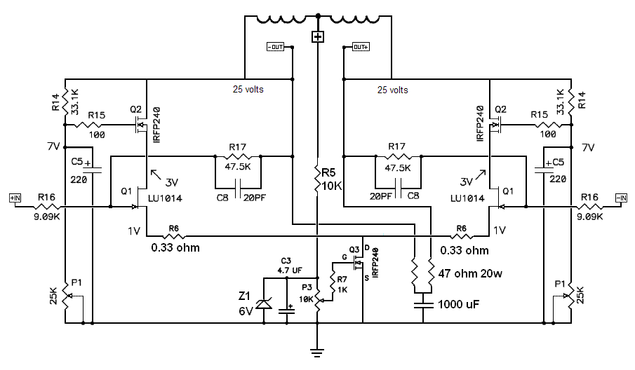

I have a mission:
I have previously played with a L loaded R100 Zen, but with my current speakers it has too high distortion at 100-200 hz. So now I want to build a more powerful and better performing amp with a similar sound signature. I also want it to be a current source amp with 100 ohm or higher output impedance.
As I also currently have 6x unused R085s here is my idea. The R085s are unmatched so I have setup individual pots for each.
My questions, however, are:
  1. Is there some flaw in the design?
  2. Does the R values look alright? I'm not sure on the 1R source resistors for the R085, should I have lower values or higher or does it look alright? Should I have higher values on the R085 gate stoppers?

why wasting R085 on cascode duty , when you can use regular IRFP there ?
say that you can use pair of IRFP150 , to cover 1A5 x 45V dissipation
you don't need source resistors there at all , current is defined with LU , while those up are just voltage umbrella
wanna trade some of your R085 for some of my LU ?

Won't they perform better than say IRFP240s? Or is the distortion caused by the upper parts is overshadowed by that of the lower part?
And in that case I guess it would be a better idea to try a R085 in the lower position and se how it compares to to the LU1014D?
Sadly I already have 10x LU1014Ds to play with. If you have a surplus of R100s or R125s lying around though I might take you up on that as I have previously found them less fiddly to sound good but I don't have as many of them.

if biasing of cascodes is done properly , they're pretty much invisible , while doing work intended
LU cascoded , or SS , as active part - you must judge what's better to your pleasuring apparatus
sorry , don't have SS surplus ; several pairs for my own playground , and that would be exactly enough

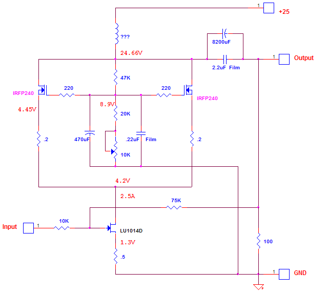

Or is it like this?
The think I don't yet understand though is how they play with each other. If we start simple and ignore modulated cascodes, if the top IRFP part now is just an umbrella does that mean that it does not contribute to the output signal and is equivalent to wasting the watts it dissapates.
Or do the two devices now act kind of like a single device, but where only the lower device takes care of the voltage gain and it is buffered from variances in Vds thus performing better? But both contribute to the output signal like if they were a single device so I don't waste say half of my output power.
And lastly, is there a general guideline for about how much % of my voltage I should put over each device?
