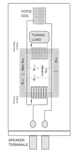

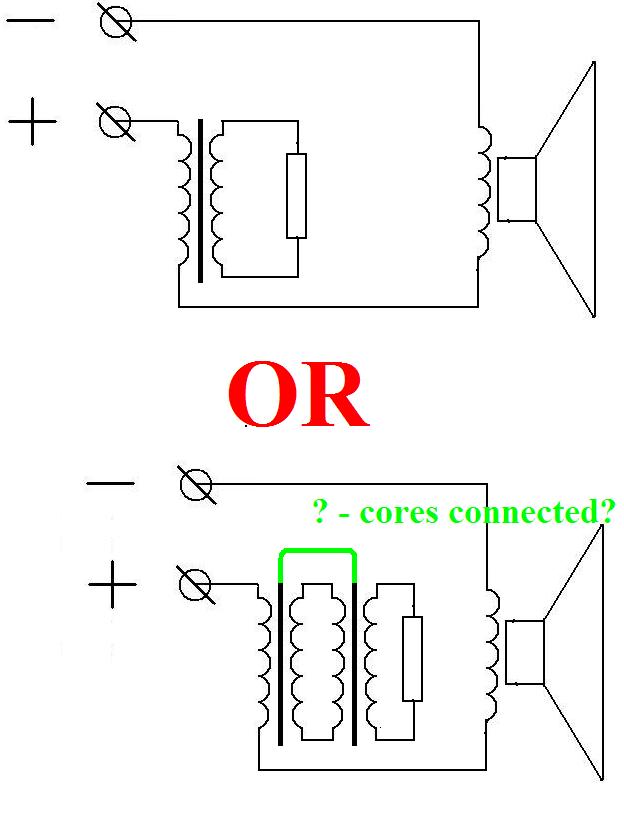

This thread is about a circuit used in those speakers: Audiophile Tube Amps and Tube Gear from DECWARE
Discussed in that thread: http://www.diyaudio.com/forums/full-range/180185-new-fr-ob-driver-decware.html
It is something new to me and I am curious. How does it work?
It seems to me that it has something in common with the T-Bass cirquit found here: http://www.diyaudio.com/forums/full-range/130679-t-bass-drive-ob-lf-drivers.html and attached below
Both alter the conductivity of an inductance through current/voltage applied to it's middle point or through magnetic inductance induced by coul - the last is the case that I'm interested in... and probably not only me...
Apart from the pure theoretical explanation it is also interesting for me whether it is necessary the two inductances to interact with the driver's permanent magnet or it can be another permanent magnet or a core or two air cored transformers.
I understand it might be naive, but if it is something useful and relatively easy to understand and DIY why not get into it's knowledge.

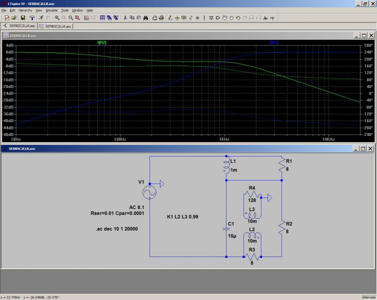

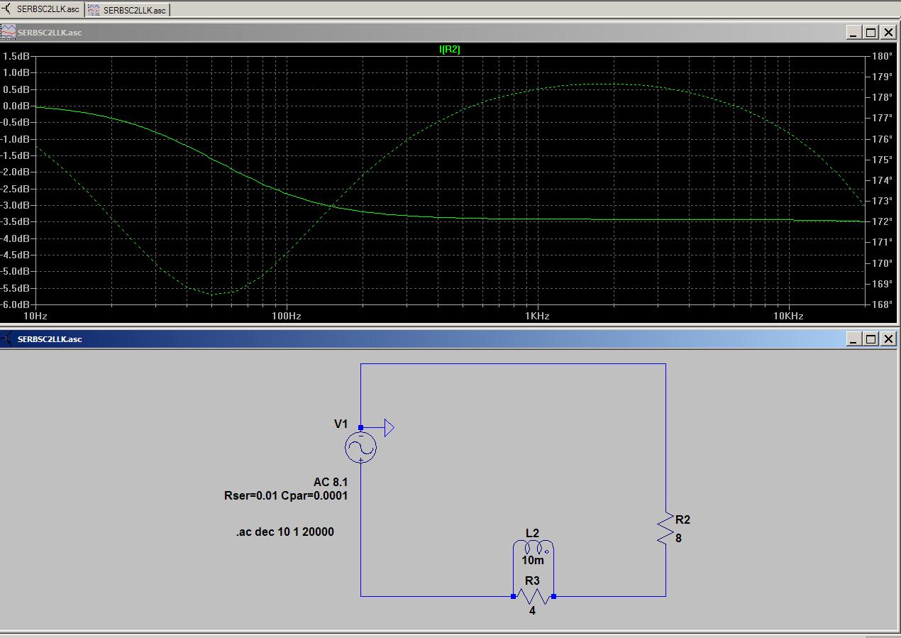

I did some thinking, I made some simulations and decided to use this "system" as a Continiously Variable Midrange Level Selector in my ongoing project.
It's symply a BSC with adjustable depth and I can't think of a proper name for it.
The maximum depth is adjustable by the R in paralel with the L (primary winding) of the BSC.
Now the transformes are ordered (laminated E-type Iron cores) and I will report when I have some practical results.
I have topic in Bulgarian language in my forum: ????????? BSC ??? Continious Correction Midrange
I apply two screenshots of two simulations, one with 128 ohms of loading load and one with 0.1 ohms loading load.
Additionally a selector for different additional capacitors can be added in order to maintain one an the same either acoustical or electrical crossover frequency.
Best regards!
P.S. Only a slight correction for the above statements. Core saturation is not the case here. Only ordinary transformer qualities. Bigger current draw=less impedance for the primary. So far no negative side effects predicted. I will have the system electrically measured for added distortion and what so ever once it is ready. - hope that is soon!

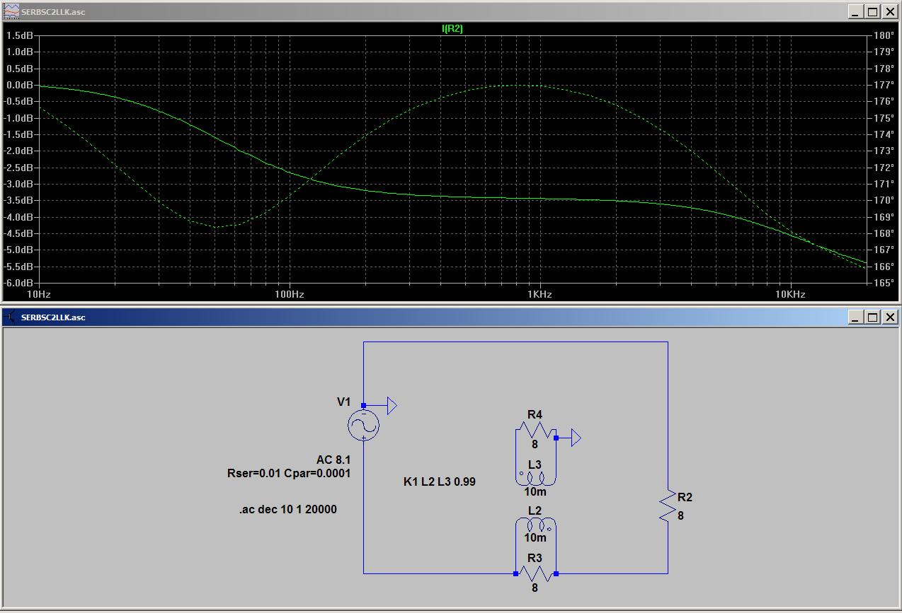

WAIT!
Circuits are not equivalent! I was mislead by sims with my intended crossover!
They are different (see attached screenshots) and it is now obvious that someone who is qualified enough must speak. - Because obviously I am not such person. :eek:
I almost mislead myself.
And in the transformer version the loading resistor and the bypass one do not get equal loading. They are equal to one point after which the loading one gets less current and the bypass gets more.
More thinking needed!
With different values of the primary and secondary windings it gets even more interesting. You can adjust the slope, depth of the first level region and the depth of the second step down.
Different bypass and loading resistor values lead to many opportunities along with the possibility to avoid the bypass resistor.

Transformers are just complex bandpass filters. If you make the coupling factor in your sim 1 rather than .99 you will see the second corner disappear. In simplest terms for an ideal model, the K of .99 simply puts a small percent of the total inductance in series with the primary which represents leakage inductance.
your version of the transformer can also be modeled with two series inductors and give you the same result. Of course the non-ideal nature of transformers could be used to your advantage but that really opens up a hit or miss situation unless you are able to know and spec the exact transformer you need.
It seems if someone wanted to follow this approach it would be best attacked with simulations and known easily measurable parameters which the series non-coupled inductors provide. As an extra plus, you could tap the inductors to allow for ease of tuning.
dave
You are right Dave. I tried that and the smaller is the coupling the bigger is the second step no matter of the loading.
For instance under 0.9 the loading resistor only alters the slope of the first step, but almost does not alter the depth of the correction.
Anyway, thanks for the input. But I have to say that i don't feel that I am the right person to investigate this kind of circuits and to share an all situations valid conclusions.

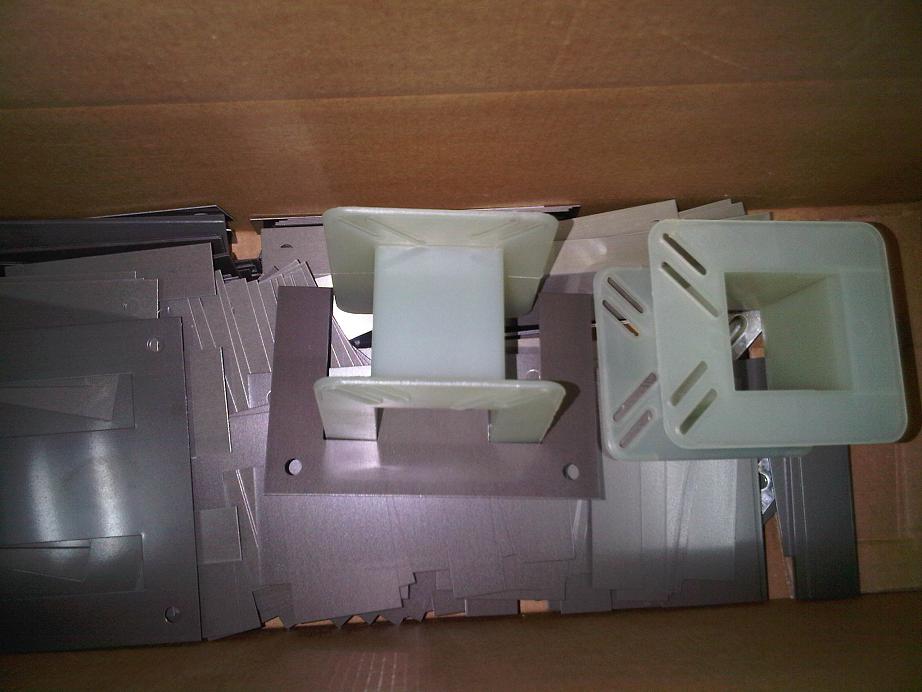

Never the less I progress :) Today I got two sets of laminated E-transformer cores with 36x36 mm central cross sections. The cores are handled to the engineers who will make the transformers and will measure their characteristics, which i will share.
The finished correction circuits will be incorporated in the project in my signature (where I could use and will appreciate any help on the bass enclosure :rolleyes: ) and I will share further data and listening impressions.
Here-below I apply a photo of the material for the cores -and choke coil.
Best Regards to all!
EDIT (forgot to ask) What coupling coefficient should be expected from this type of transformer and core? The segments are laminated (I read that in the Wikipedia, that the segments should be electrically separate in order to keep the losses and etc. low)

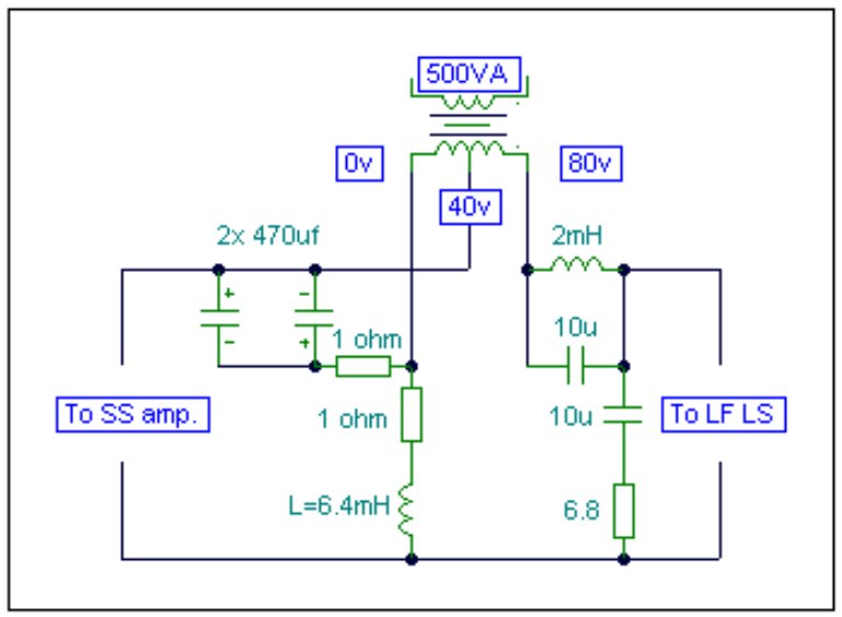

I used this type of approach with an air core transformer which I created by winding a 20awg secondary with about a 4:1 turns ratio on a large 12awg inductor form with about a 12mH primary winding. This allowed me to do some relatively narrowband attenuation EQ of the Iron Lawbreakers in the mutual coupling region of the air core transformer which was centered at about 150hz with only an additional resistor and film capacitor.
This worked out very well since the air core transformer doubled as a low pass series inductor above the mutual coupling range and allowed optimization of the frequency response at the same time greatly flattening the impedance throughout the bass to lower midband range with minimum parts count and low signal loss. In fact, this approach, in addition to special internal speaker damping I used that included adsorbents virtually eliminated the upper BR impedance peak (18 ohms +/- 20% from 40 hz ~ 250hz without any 'Zobel' networks) which I believe results in significantly clearer sounding bass. The 'downside' was that the whole development process was very empirical - there were few if any 'guidelines' to work from for using an air core transformer as part of a speaker xover.

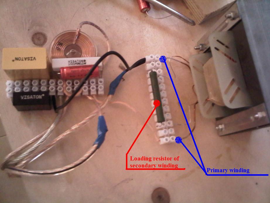

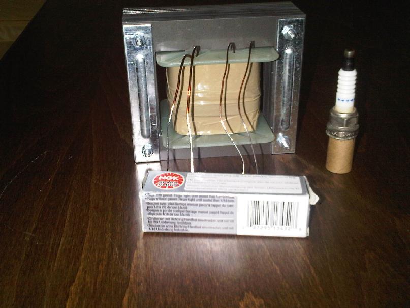

Transformers ready! :)
Primary winding 120 turns of 1.2 mm wire;
Secondary winding 120 turns of 0.8 mm wire;
Resistance of primary - 0.33 ohms;
Resistance of secondary - 0.79 ohms;
Inductance of both windings in final variant with 1.5 mm spacer - 10 mh;
Inductance with fully closed core (E+I) 31.7 mh;
Inductance with only E core - 4 mh;
inductance with full core (E+I), but with 1.5 mm separator between the top and bottom sets of E+I lamellas - 10 mh;
4.7 to 10 Kohms load on the secondary leads to maximal primary inductance of ~10 mh;
Short circuit of the secondary leads to almost none inductance of the primary;
Experiments with secondary winding with 30 turns have been carried out and dully documented as follows:
Secondary on short circuit leads to primary inductance of 0.235 mh;
Secondary loaded with 10 ohms leads to 8 mh of primary;
Secondary loaded with 27 ohms leads to 8.92 mh of primary;
Secondary loaded with 37 ohms leads to 9.33 mh of primary.
I am very happy with the results! :):):)

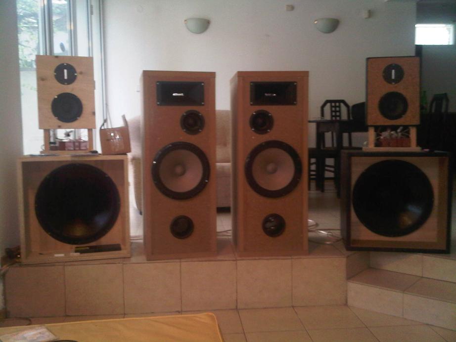

Because I am curious and my friend who made speakers with the same bass drivers as those from the project from my signature was curious too, we tried connecting the 10 mh as a simple BSC with 6.6 ohms bypass resistance and optionally with 1 mf capacitor. - We are very pleased with the results. We got ~29 hz at 0 db this way :) the bass became better articulated and detailed too.
Experiments with variable loading of the secondary winding in my project are coming (maybe on Easter...) as well as listening impressions...
I apply some photos.
p.s. By the way, i have never heard a BSC before... :eek: - good thing is this! :)

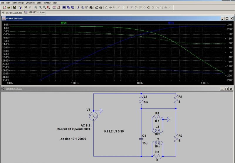

From series I went to parallel, because I found out that with the software used for simulations, serial circuits are not being simulated correctly. - the flat zone of the full range below crossover frequency should not be there.
Another interesting fact is that 90 degrees of phase difference at 1250 hz i quite a challenge for alignment. Both drivers in phase lead to ~ 20 to 32 cm (8 to over 12 in) required acoustical center offset. And full range out of phase leads to about 6 cm required offset. Curious fact is that on this frequency the delays are very easily detectable and noticeable.
Also I moved the constant inductance from before the variable BSC transformer to downstream from it.
It seems that with varying the loading of the secondary winding and thus shaping the electrical signal energy distribution, it is required to alter the value of the capacitor for the high pass for the full range. This is due to a probable actual crossover point shift.
Very funny such a simple circuit with so few parts to present such complicated challenges. Another challenge is the flat area in the electrical response of the variable BSC, with small value load all is normal and the signal falls with 6 db/oct after say 1000-1200 hz, but with 8 or 15 or greater load there is a flat plane where before was a slope.
Probably I will have to consult an engineer again for those issues as I am very optimistic about the results from a well engineered network with that device implemented in it. The listening tests were quite promising with only one flaw apart from the required acoustical centers offset - discrimination of complicated signals around crossover frequency - sound from falling thin metal objects is greatly jammed - this is ringing, tangling, jingling and etc. - great example is the Dire Straits song "Private Investigations" - there is such passage in it...

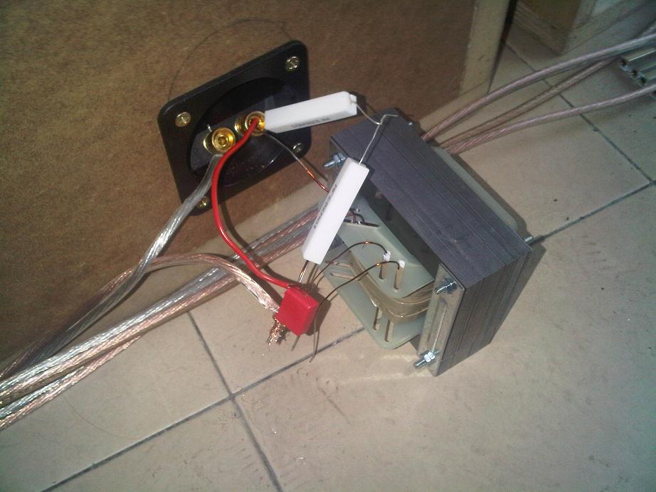

I apply a photo of the test crossover auditioned. Later it received a powerful potentiometer (two out of three leads of an adjustable L-pad used) and it made even more obvious the difference between settings.
Note that in the photo you'll see a zobel network not shown on the simulated circuits above, because the software is not able to simulate an R (driver) bypassed by a zobel. The zobel is 10 ohm and 8.2 uf and is for the bass driver.
Best regards to all!
