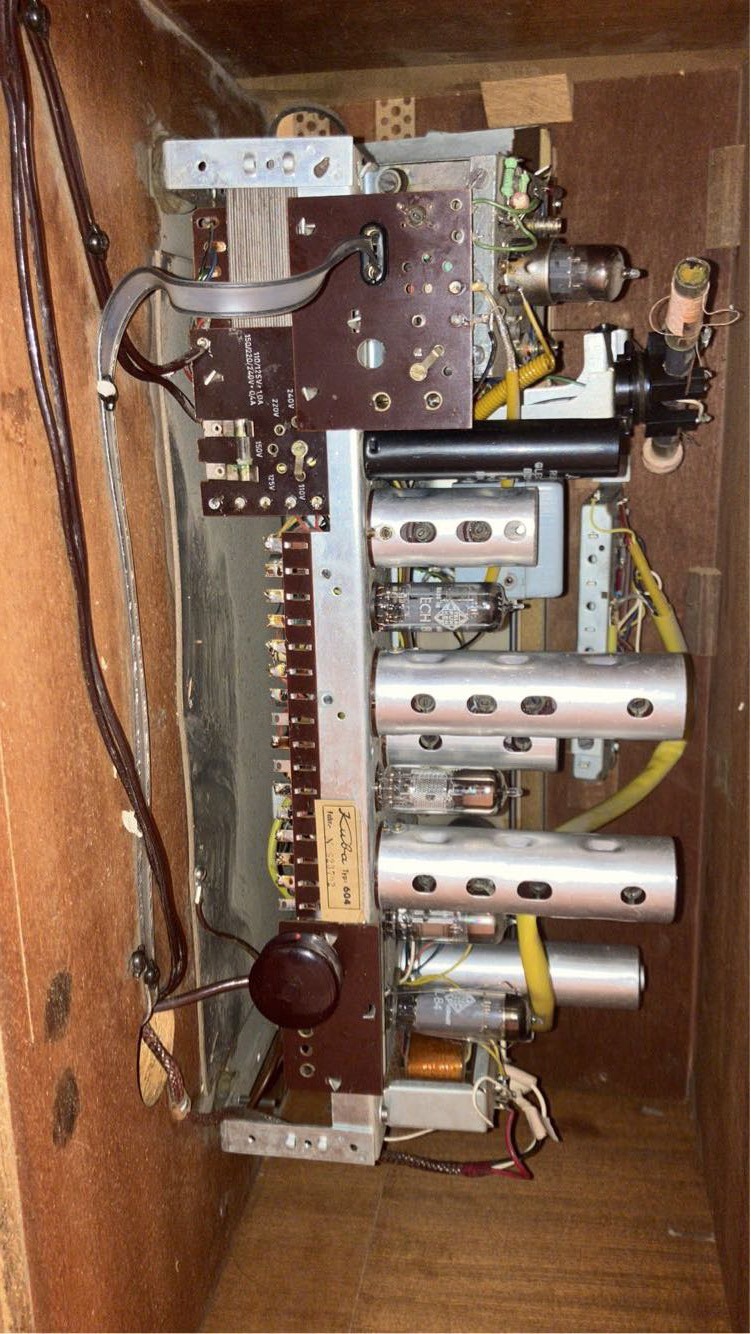

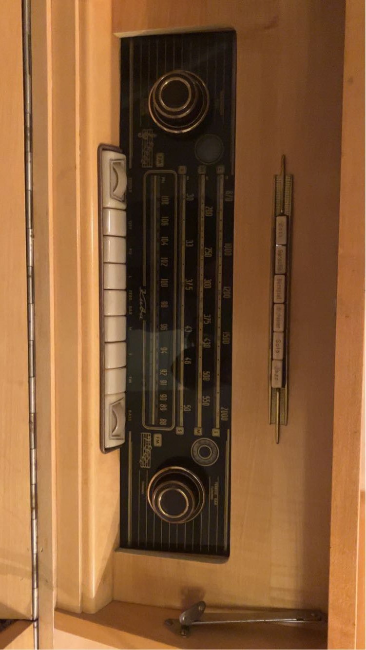

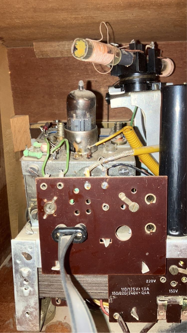

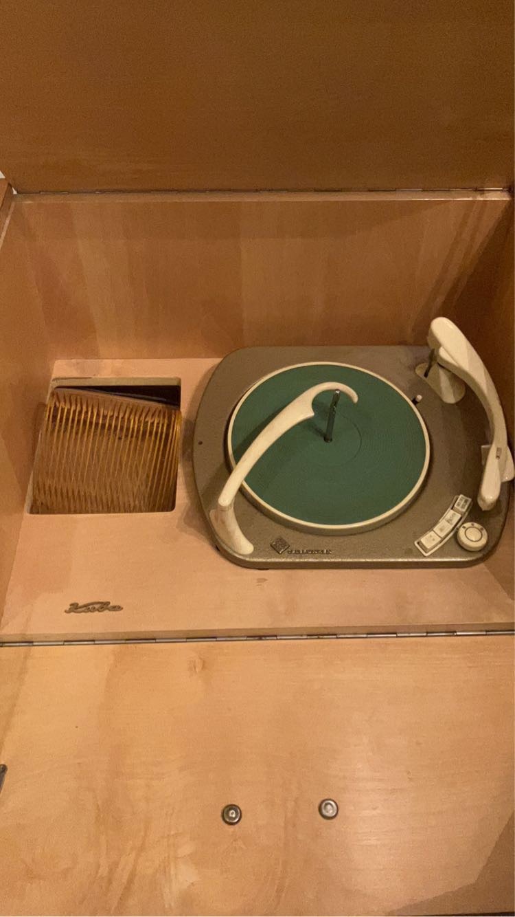

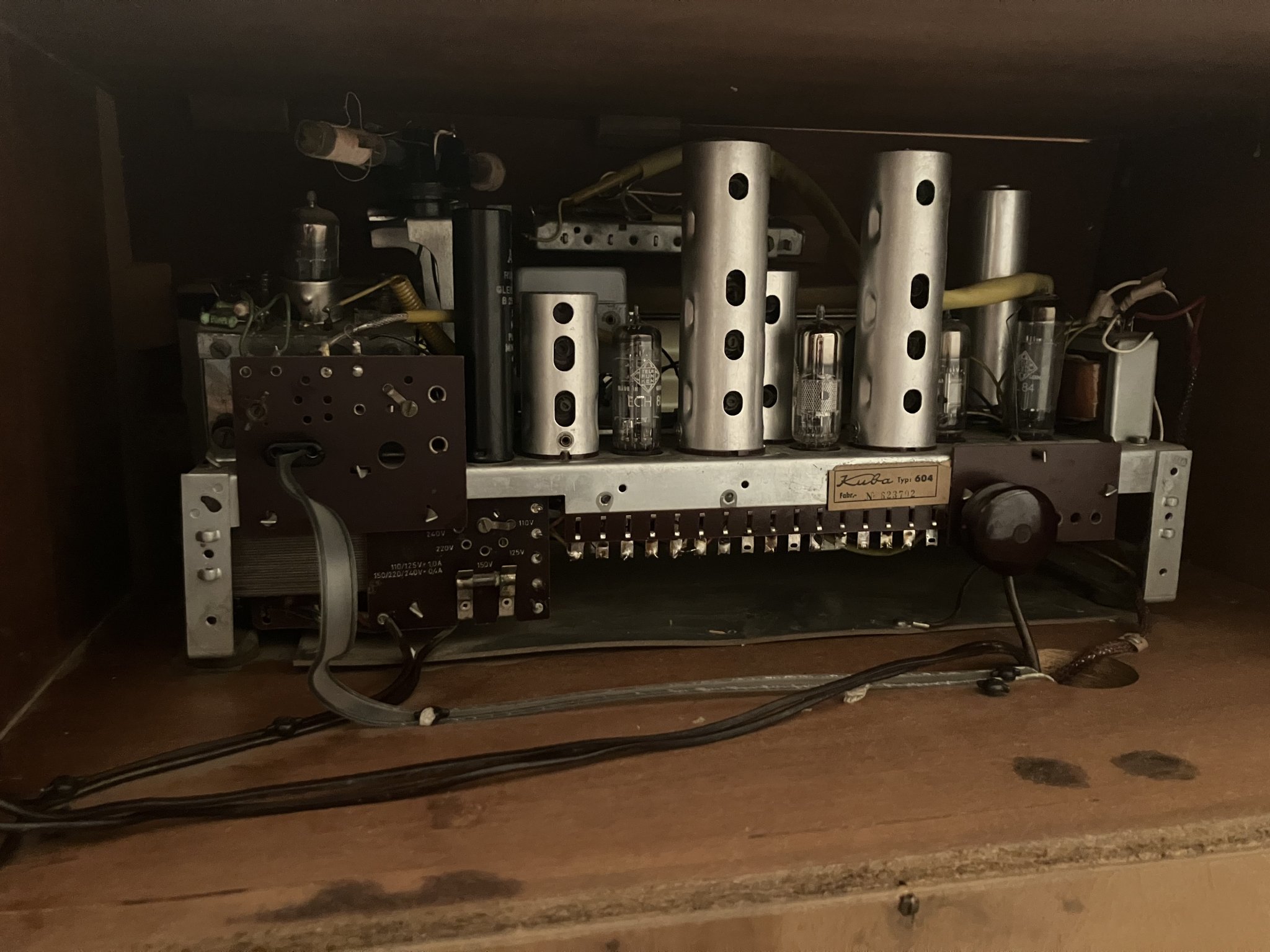

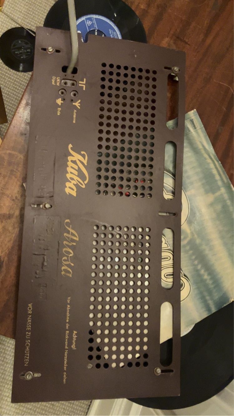

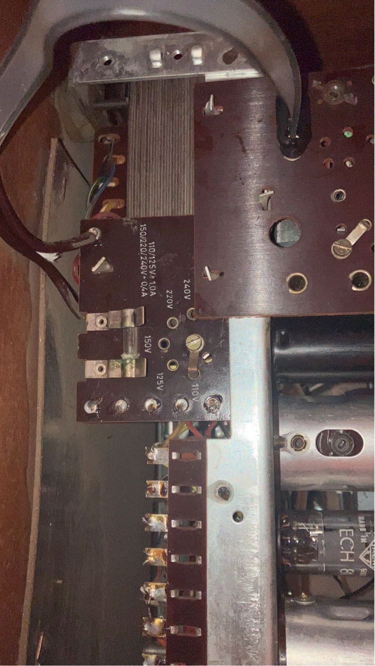

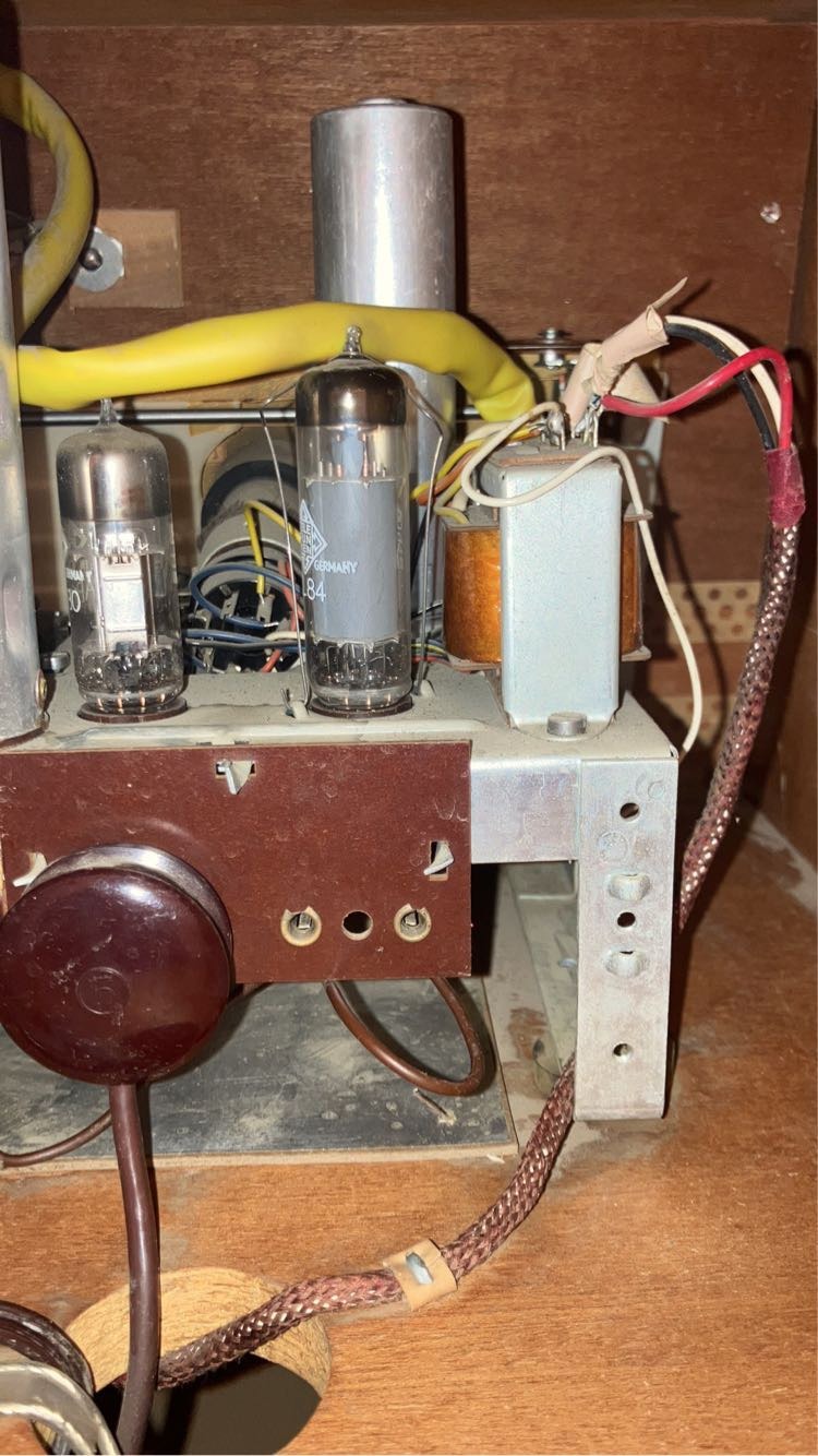

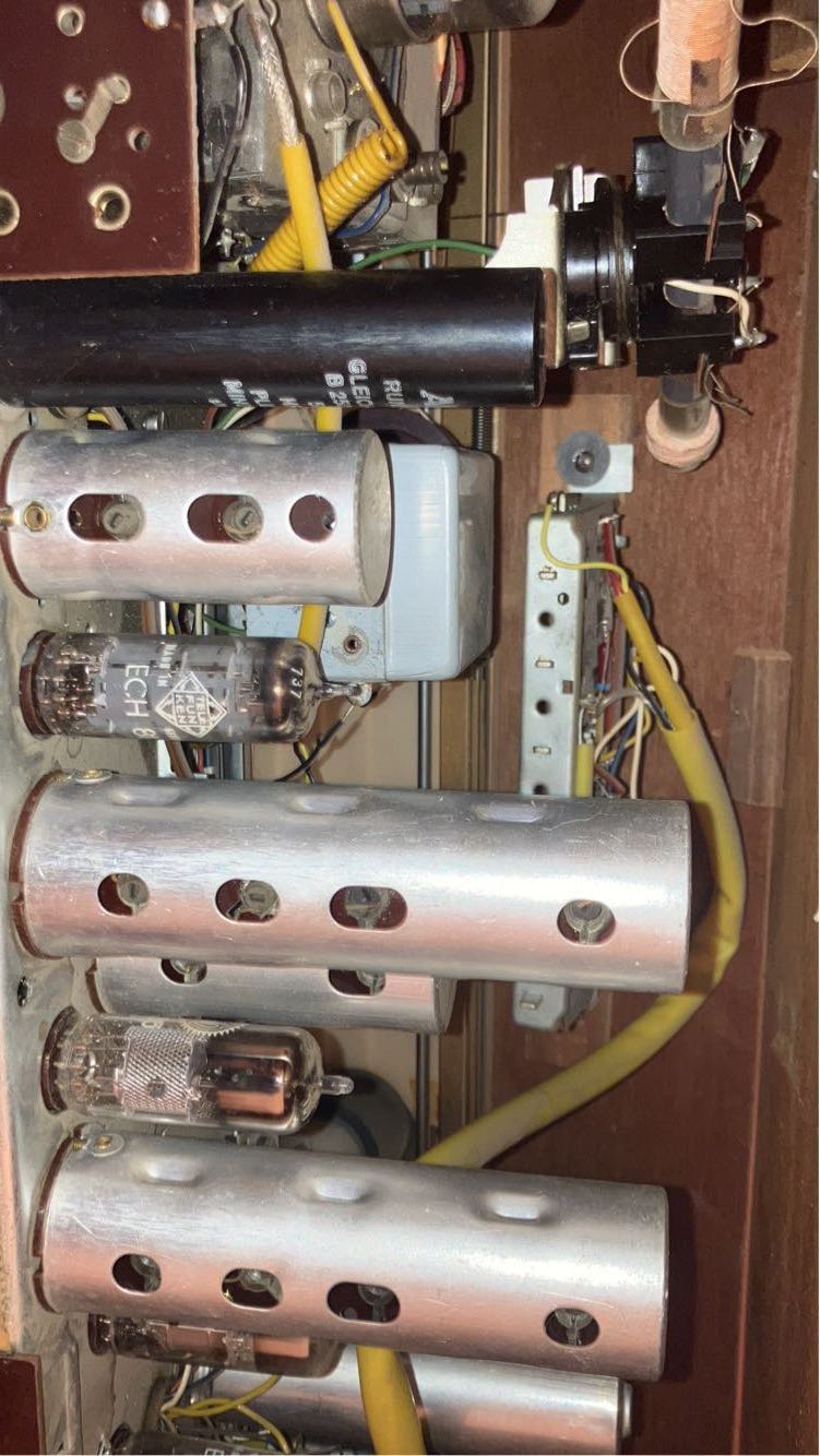

I recently acquired a Kuba Arosa stereo/record console with a Telefunken Turntable in rough condition. From a few quick searches, I’ve found that it was produced from 1958-59, but little else. I know very little about vintage radios and turntables and even less about vintage wirings, parts, etc, but there are some obvious flaws which i will attach pictures of. Does anyone have any insights as to the potential issues with these systems?
I still need to purchase an updated plug, so as of now I have absolutely no idea how the systems function. If anyone has any suggestions about parts to buy in the meantime, it would be greatly appreciated. Thank you!!

Which issues does your appliance show? How many EL84's do you count? If it has indeed been built in 1958/59, there should be two of these tubes, but in PP, not in stereo configuration. Previously built ones only show one EL84 in SE (of course).
This unit of German provenance has been sold via mail order by Neckermann or Quelle then.

Hi katie

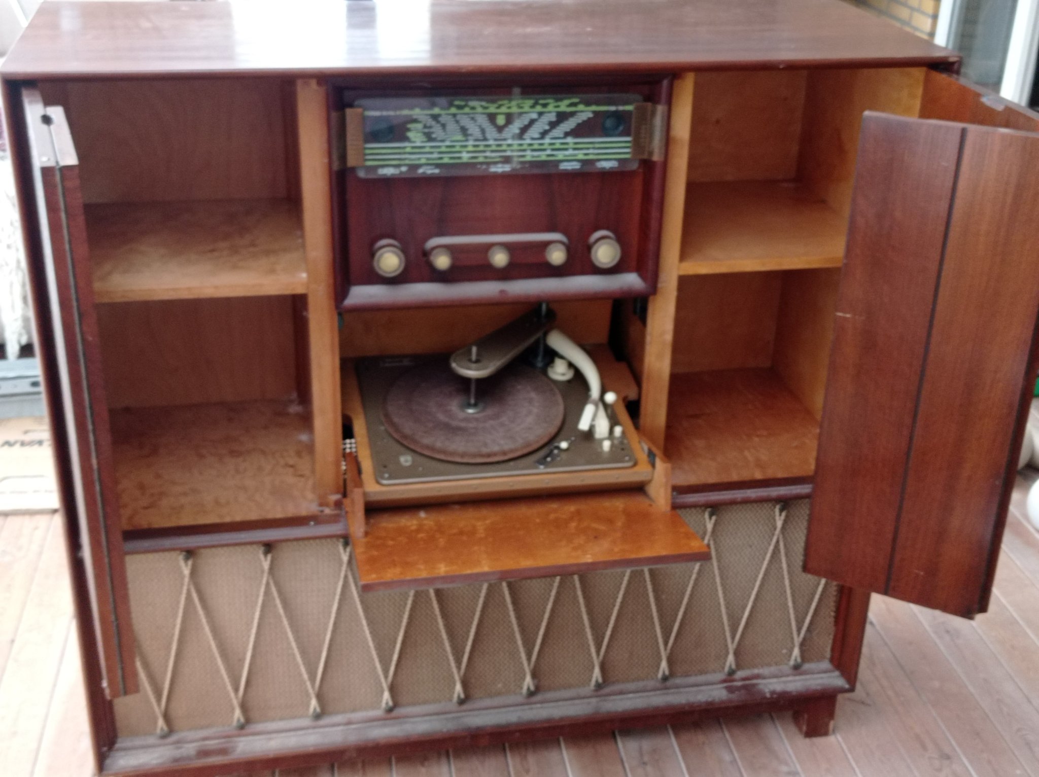

Firm Kuba was producing some fine looking consoles
https://web.archive.org/web/2016012...r-alten-radios.de/geschichte-kubamsm-128.html
Kuba was using electronic hardware from other W. German brands.

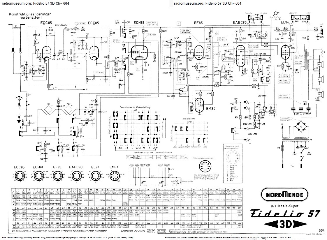

The one you have aquired has the chassis of the Nordmende Fidelio 57 3D (chassis 604).
It is a mono unit with three loudspeakers.
Radios of that age need a full restoration.
All small paper capacitors to be changed and many if not all electrolytics as well. Selenium rectifier too.
Then adjustment/alignment of radio sections.
There is some 260Vdc inside and you have to know what you are doing if you have to work with it.
George
