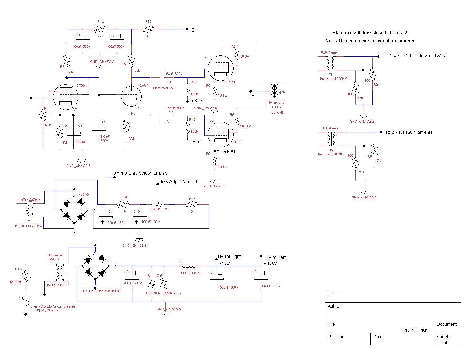

I'm building up my KT120/KT88 amp right now. I have already had this running with KT88's and it really did sound nice. I found the KT120's and had to try them and also wanted to upgrade the power transformer to something a little beefier. I will be able to switch back and forth between the KT120's and the KT88's so I can do a "shoot out". I have visual analyzer working so I can measure distortion now, where I couldn't when I first built this as a KT88. Maybe it will have terrible results for both tubes I do not know. Ah, this is what makes this hobby fun!
Oh this will be all triode with no multistage negative feedback. PSU II calculates about 470v B+

I like the design of your amp very much..Couple suggestions you may want to try..Change the 12au7 to a 6cg7.Your distortion product will fall by 30 to 40% at plate of the 6cg7..Also,the .68 k40y or the Russian kBG paper in oil caps there are superb in that position.You can also add 35uf@500v or a 100@600v poly filter caps..All these things will make phenomenal improvements.

full wave rectifier on a 356V transformer would produce 534V. Your using 500V caps and indicating 470V as B+. Would the 1.5H choke drop that much voltage?
No,He needs 600v caps..That was a typo on my part..He can use motoruns that are rated 370vac which are good to 745dc before they start to breakdown

The circuit you are using is very marginal to drive triode connected KT88's or KT120's
This circuit would drive pentode connected KT88's but only just; you need an extra stage.
Also look up the data for the KT120 the max grid resistor with Fixed bias is only 50K not 100K; that's if you want your tubes to last. You need to add a push pull driver stage. changing to a 6cg7 will not make any difference, but you could use 6CG7's as the push pull drivers, much better sounding than12AU7's

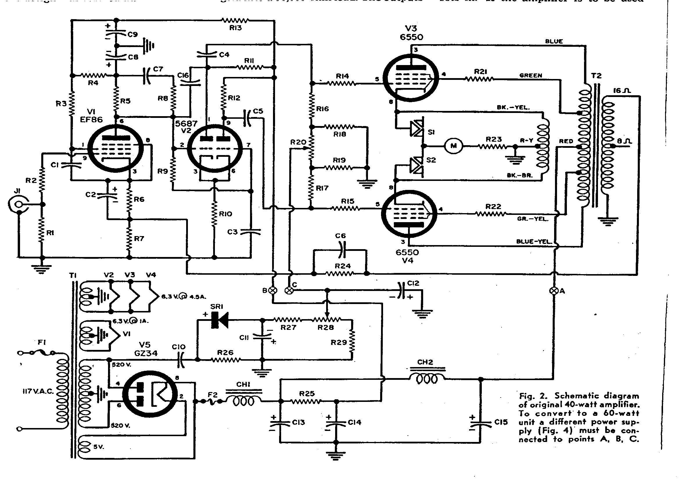

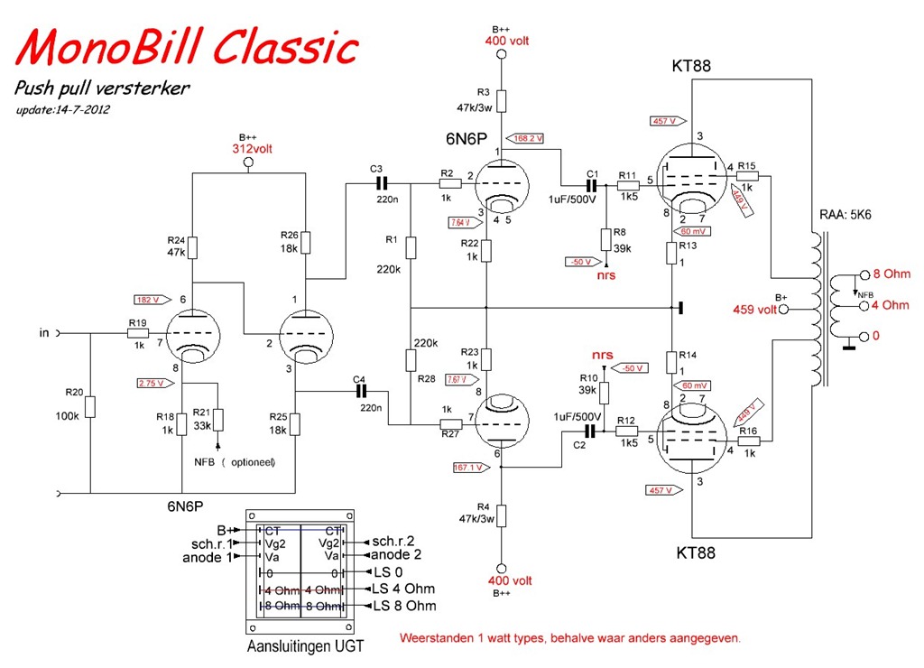

The circuit with the 5687 can drive cathode connected 6550's so will easily drive triode; the best circuit would be the one with Russian 6N6's.
best to only drive class A if direct from the phase splitter.
Hi Speakerfritz:
I get 470v as does Multi with a 200mA load. The DC resistance of the 356v tap is 22 ohms and using 1N4007 diode bridge in PSU II gives 470v.
Phil: Your second circuit gives you ~4.9 mA of drive current. My circuit gives 4.2mA of drive current. Will there be that much difference?? I am going to stick with the 100k grid resistors as my bias is individually adjustable. If I were slamming them into a guitar amp where you need "matching" pairs then ya better be at 50K there.Hi Melb

Michaelsamra: I have tried "oil" caps and really don't like them. I will stick with MKP types for coupling caps. I may look into some poly filter caps for sure!
What's with this magical 6CG7? I found a couple on Ebay for cheap so I will try them.
