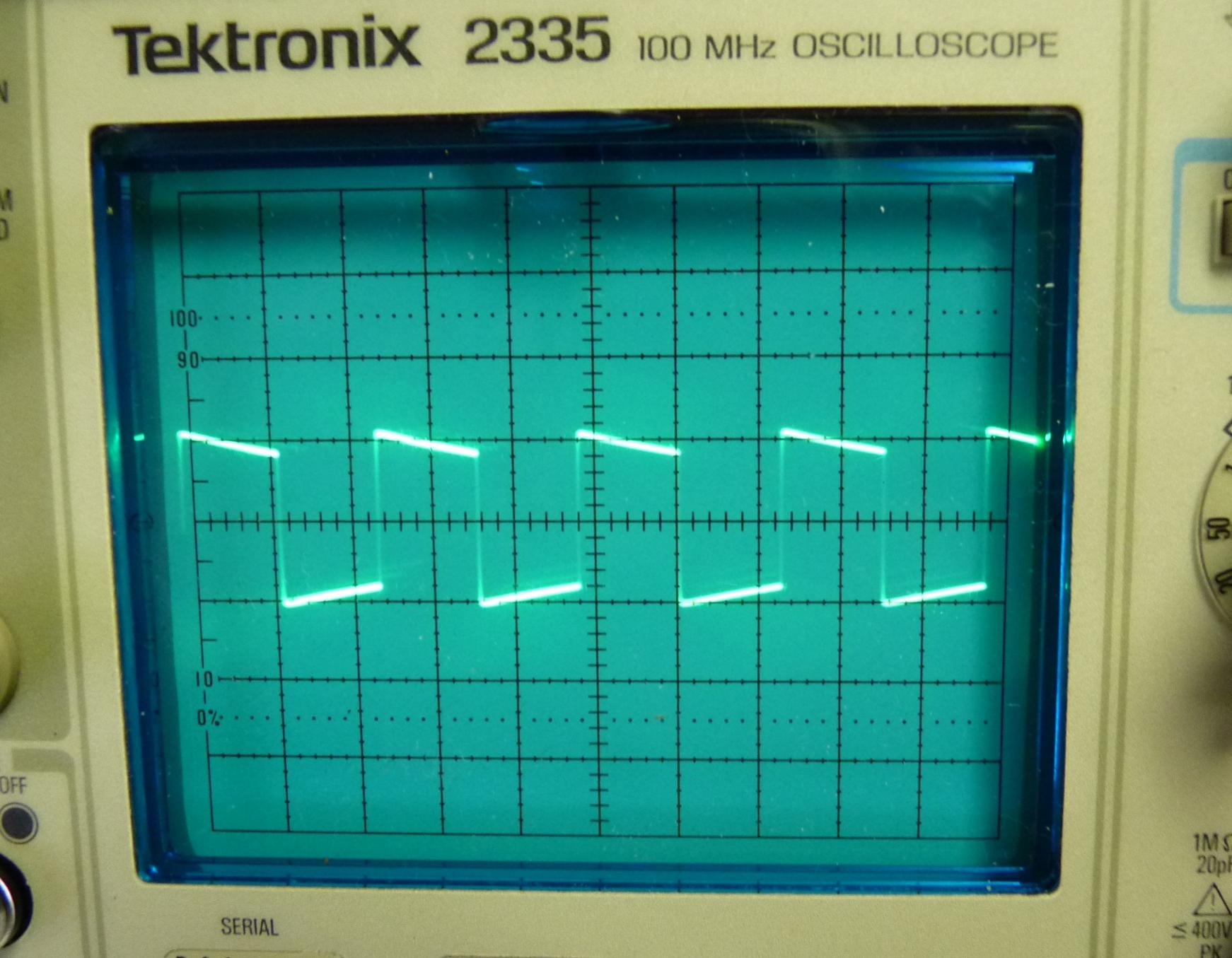

Square Wave
Here are a couple of photos of the square wave response of the amp. One at 200Hz & one at 2kHz.
