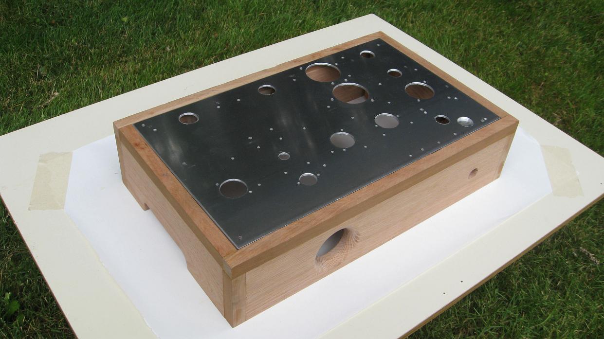

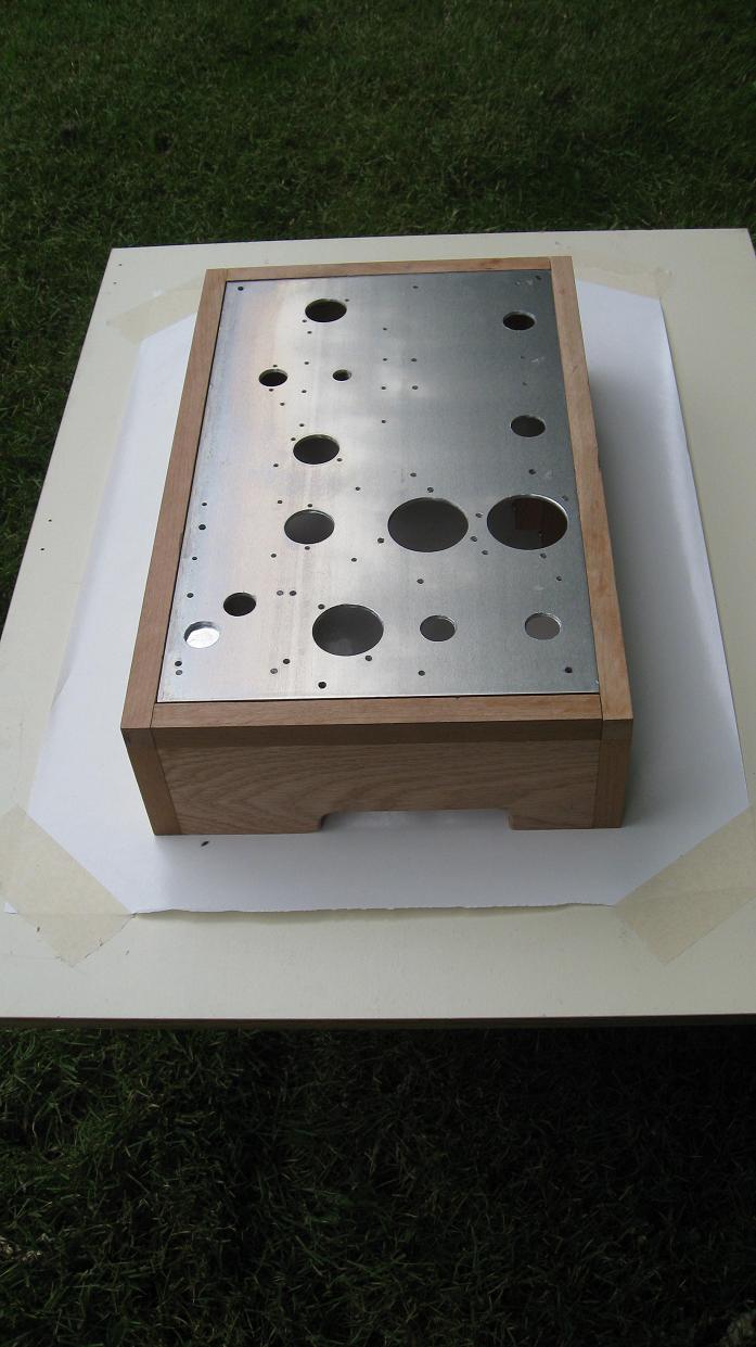

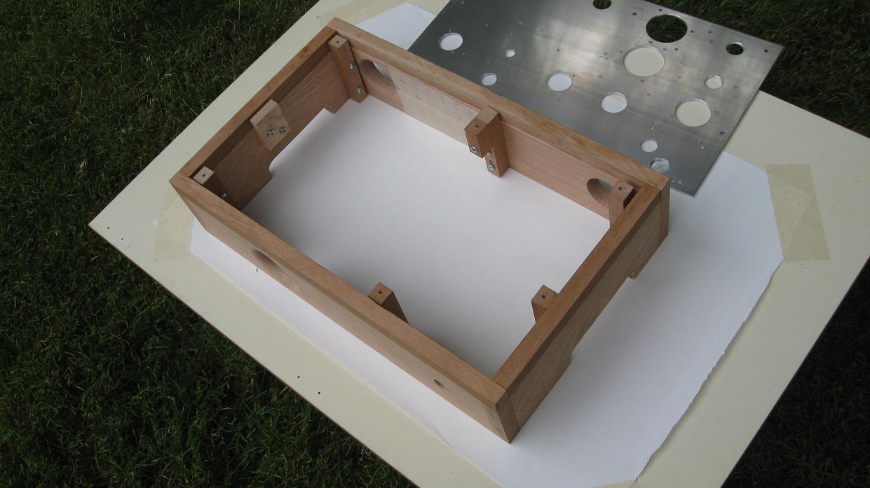

progress update
Thought I'd send a progress update on my tube amp project. This is my first time at an amp, so I'm not setting any speed records. ;)
Here are a few shots of the chassis complete in its raw form. Still need to do the finishing work before mounting everything and doing the wiring.
Wooden base is oak and cherry construction to match my speakers. The top plate fits in the frame, with the supports set down 1/8", so that the plate is flush at the top.
Instead of mounting feet, I decided to cut a hand hold on each side. They are indeed centered -- near the center of gravity -- which is offset mainly by the transformers to be mounted along the back.
Going through all of the details (so far!) has been tedious and laborious, but now that it's all to this point, it's nice to step back, take a breath, and enjoy. Anxious to get it all together.
More pic's as progress is made.

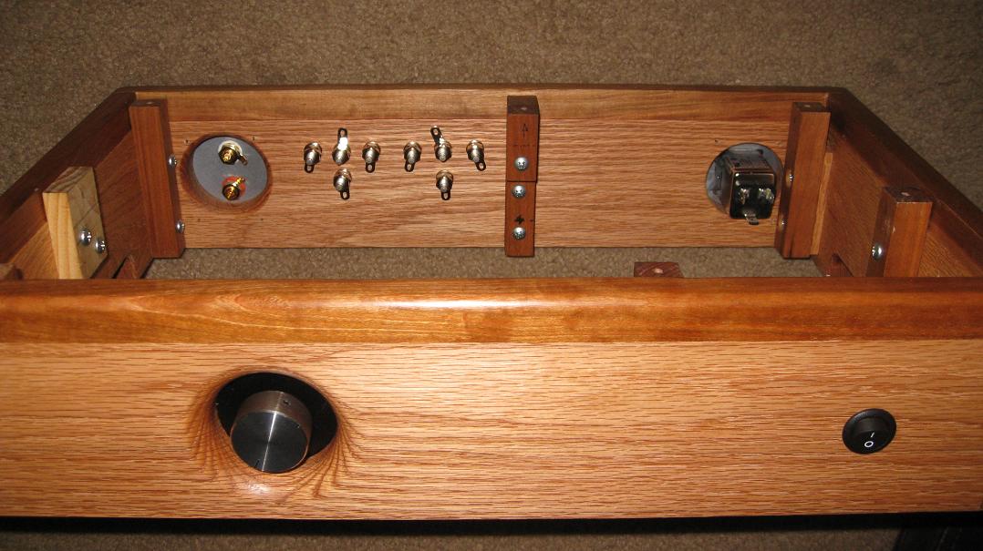

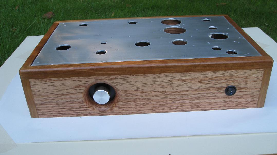

More progress . . .
The wood base is finished, and the top plate is finished with a clear acrylic coat. The oak and cherry base was finished with (natural) Danish oil, and coated with a furniture wax for a low gloss.
The volume control is mounted on a piece of sheet metal on the inside of the wooden frame. The through hole is cut with some clearance, and finished with a generous roundover for my fat fingers. ;) Of course, the wood grain is more interesting around the flared opening as well.

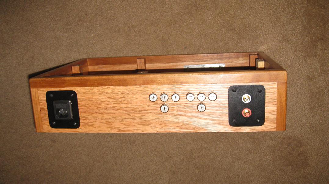

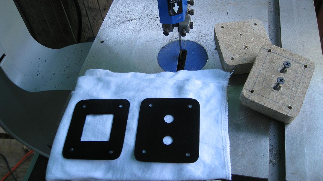

Figured out how to make the rear mounting plates with a nice finished look. One is for the electrical power jack, and the other is for the RCA-type (L&R) input jacks.
The sheet metal was clamped in place between the 3/4" particle board blocks. I cut the blocks out on the table saw, then ran the corners through a roundover bit on the router. This technique provided a good way to cut the sheet metal with the band saw, as well as final filing down to the wood edges. It also made for a nice drill block for the 4 corner screws.
After priming and painting, I thought the plates came out pretty good. The topcoat is satin black.
more later . . .
just a clarification to post #50. (someone was confused, and thought others might be too)
Only the wood blocks were cut on the table saw and radiused corners on the router.
An over-sized piece of sheet metal was clamped between the finished blocks. The metal only was cut down on the band saw, and then filed down flush to the wood.
A couple shots with the input and output hardware on the back. I'm using different output transformers with 4,8,and 16 ohm taps (hence the "T" arrangement for the binding posts).
Now on with the wiring. :spin:

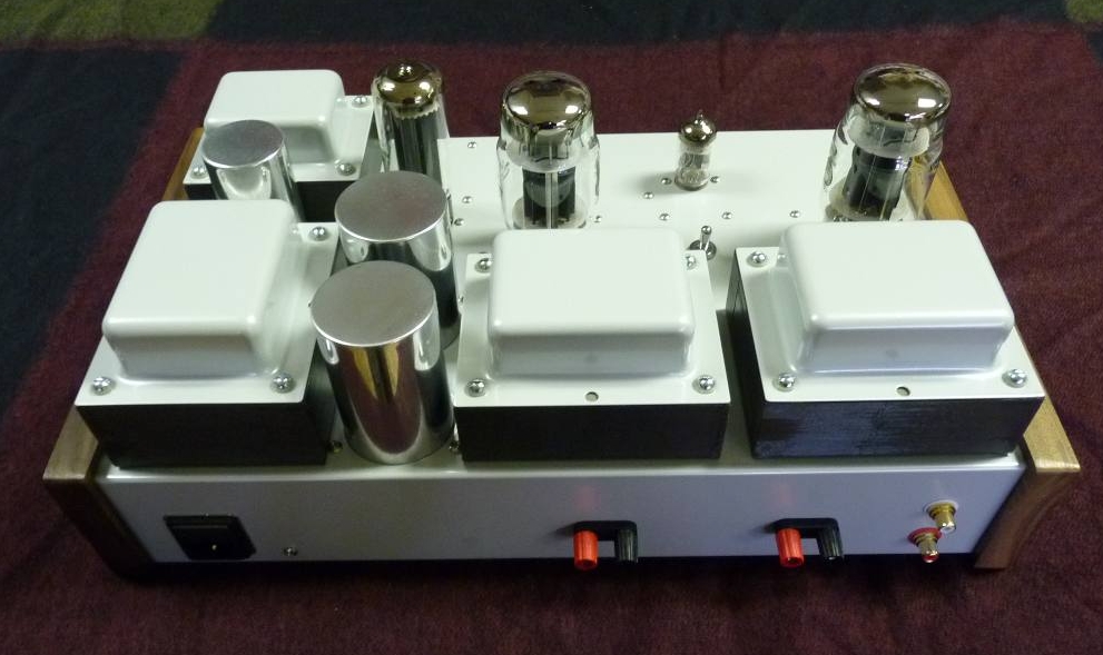

This amp is now available for purchase fully built and tested, on request, at the price listed and as shown in the photos. Other RAL colors are optionally available for the chassis and transformer covers at an additional charge.
If you are interested please send a PM. If you are in the NYC area you are welcome to audition the amp in person.

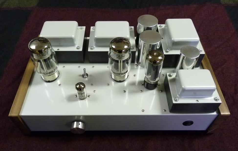

If you have been on the fence as to which SE tube amplifier to build, as a kit, or to buy as a complete unit, this amplifier will more than provide complete auditory satisfaction. You will hear details in your favorite music that you have never heard before.
The careful attention to detail and superior components selected for this amp will provide a sensational listening experience.
The fully built amp is available in any color or finish that you desire.

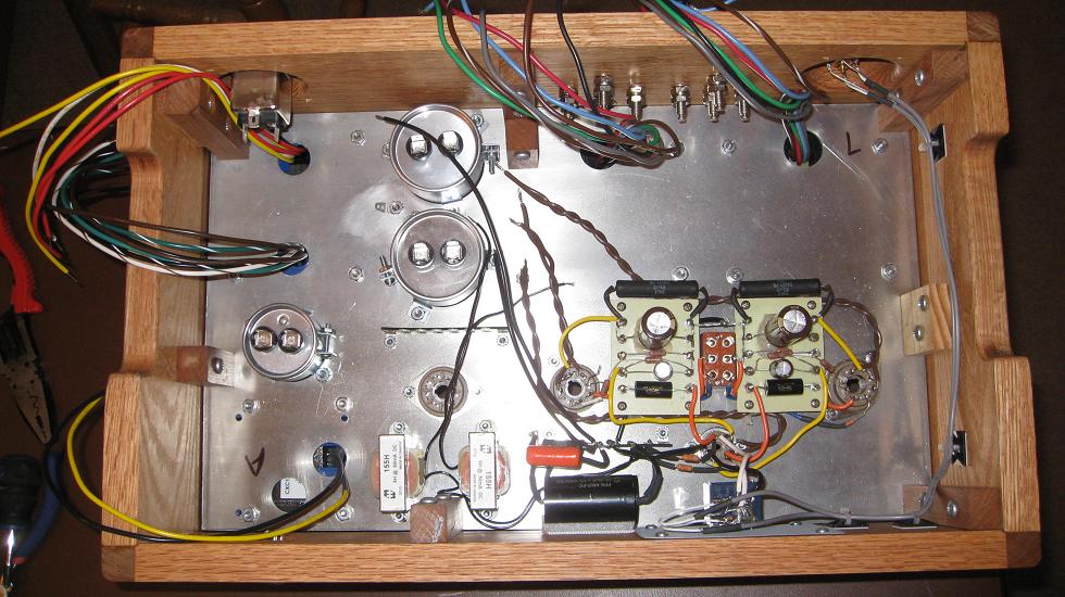

Hope everyone's had a nice Christmas, time to enjoy family and friends . . . and maybe some time off!

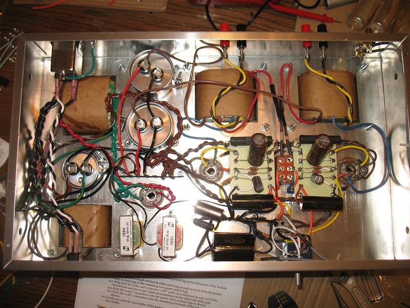

Finally . . . got some of my own time during the Holiday break to finish this project!!! Things got busy by the end of the summer both at work and at home . . . so it goes.
Yesterday I pulled out the pieces and started in again. Thought I'd post a couple of pic's of where I left off today. Should be mostly done tomorrow and ready to crank it up soon. :D
Wiring is done. Yippee!!!
:happy2:
Testing tomorrow, and hopefully some break-in tomorrow night.
I've built many speakers, but this was my first amp build. It took me a little longer than others have mentioned, but the kit instructions are very detailed and complete. I'd guess it took me around 25 or 30 hours total for the wiring. The quality of the parts and the packaging was top notch.
Update tomorrow after testing. Really anxious to hear my speakers with this amp pushing them.
Here's a picture of the completed wiring.

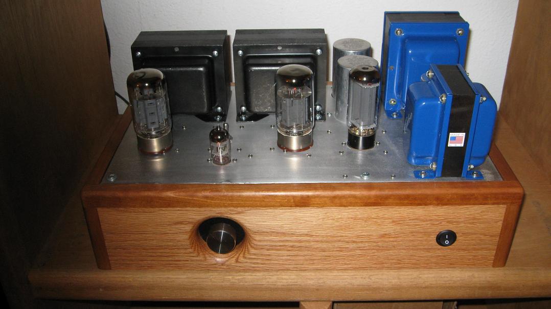

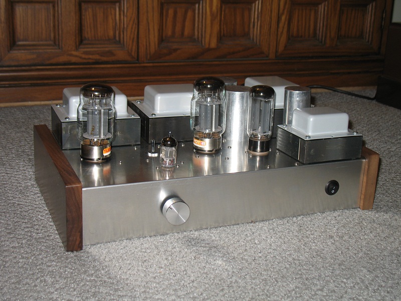

The amp tested out fine, and I've had them hooked up for a couple of hours this evening.
I hooked them up to a nice little bookshelf pair and noticed immediately how detailed the sound was. The upright bass sounded very detailed, and had a nice presence.
One other thing that I noticed was how impressively quiet this amp is. Very nice provisions in the design to accomplish that.
I need to check them out for a few days before I give a more detailed review, but for now, I am very pleased with what I hear. This amp is a very good choice, and well worth it, in my opinion.
Here's a picture of it up and running. Yes, they glow! :D
