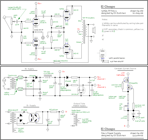

Good suggestions have been made. Do what's necessary to get a modest gain "sand" front end that's linear. Then, you will have enough Volts to use a 12AT7 based differential splitter/driver, like that found in "El Cheapo" (schematic attached).
UltraLinear mode "finals" will get you the power you desire. Enough loop NFB is present to provide a decent damping factor and a THD under 1%.
The 'T7 sounds good with 200 to 220 V. on the plate and an IB of 3 mA.
Edcor's model CXPP100-MS-3.3K O/P trafo will give good results, without making you destitute.

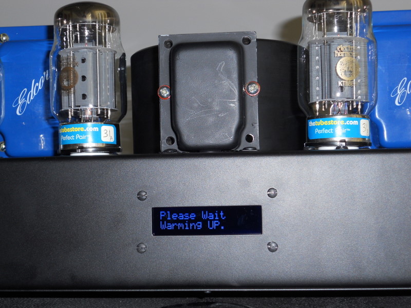

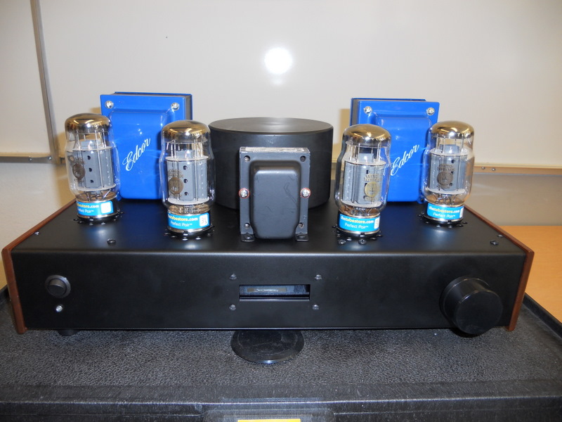

Hello All!
The amplifier is done so I thought I would share it with everyone here.
Overview

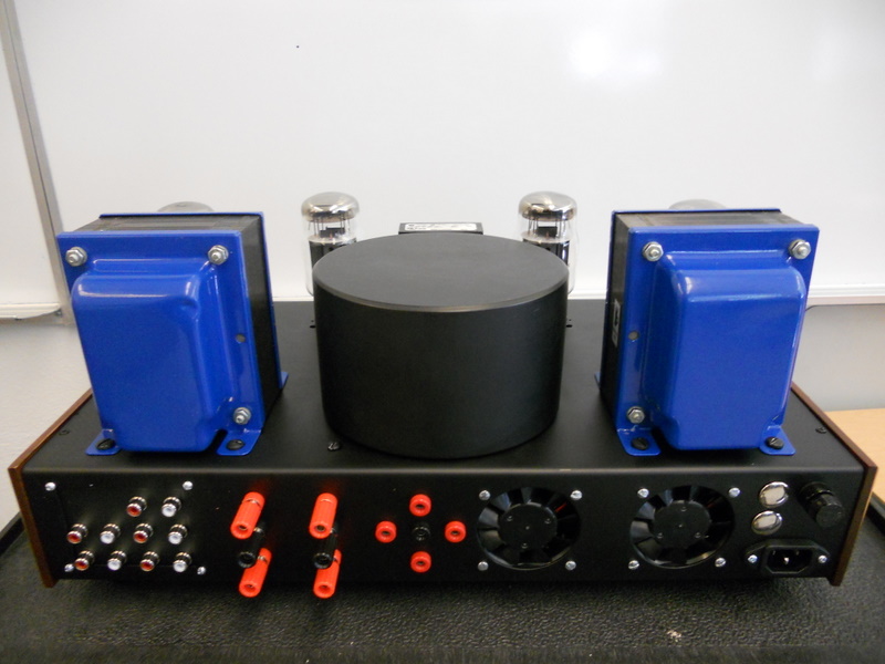

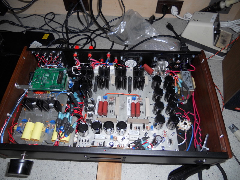

The power amplifier is a stereo push pull ultra linear configuration using KT88's. The plate voltage is set to a regulated 480V and provides 45W of power. The output transformers are EDCOR 5K 100W with 16, 8 and 4 Ohm secondaries. The power amplifier design is taken from AudioXpress magazine where the designer Bill Christie used an LM4702 to drive the KT88's.
The entire pre amplifier is solid state and microprocessor controlled. I used the TDA7439 audio processor chip for the preamp. It has a 3-band equalizer (bass, mid, treble), 4 input multiplexer. volume and balance control. A MAKE controller with the ATMEL SAM7x microprocessor controls the chip.
The user interface was designed to be as sleek as possible. One quadrature shaft encoder allows the user to change the audio settings. Pushing the knob switches between the menus: volume, bass, mid, treble, balance, input select, LCD display contrast and pre-amp bypass. Turning the knob then changes the settings. The pre amp bypass allows the user to use only the power amp if an external preamp is available. A separate RCA input is at the back of the amplifier for the power amp only.
All voltages are regulated except the filament voltages. Each channel has its own Maida regulator. The voltage on the LM4702 is set to +/- 65 volts also using a Maida regulator.
I bought the basic chassis over ebay and punch and drilled the holes myself. I then had the chassis powder coated. There are two low noise fans that blow air into the chassis and out through holes drilled around each tube for added cooling.
I am a student in an Electronics engineering technology program and this amplifier was for my capstone project. I was in a group of three people and I was responsible for the power supplies and the tube power amplifier. It is the first tube amplifier I ever built and definitely not the last. It's not perfect by any means but sounds really good. I would like to thank all of you who gave me their advice and ideas. This project would not have been a success if it not were for this forum. Here are some pics!
