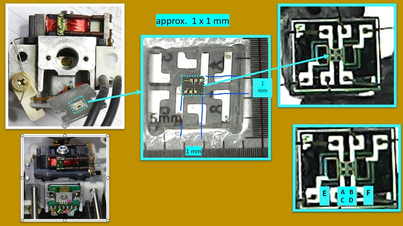

Still, the goal would be to get the laser beam in the center of the diode array - and that is the tricky part.
Attached details might give you some idea about how delicate this is. Therefore, an alignment tool, some measuring electronics and oscilloscope is needed.
(p.s. the picture shows the optical pickup from a Technics SL-P2 )
@ASAMS Thanks for reply. As I have only a PC based osciloscope and some DMM, I will not be able to properly setup the laser. Regarding laser diode, the operating current is 52-70 mA, according to datasheet. Most laser pickups show ~60 mA on the lable. Next I will look for a laser power meter.

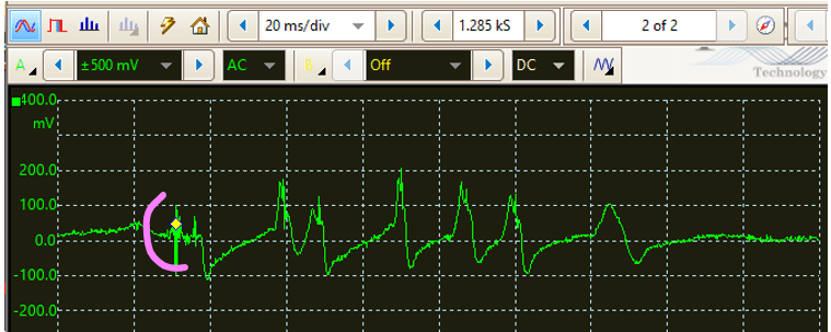

Did you actually measure the 'RF' signal already? You may see a kind of S-shape response when the pickup/lens tries to focus (= moves up and down).
As this stage, the electronics tries to detect the if the signal contains also a higher frequency (= refection from 'pits'). That most likely does not happen here, but looking at the 'RF' might give at least some idea.

@cupitza , of course you would see some signal here. If there isn't any, the light beam would not even be close. You will certainly NOT SEE the typical eye pattern, if this was present, the disc was already detected. You may see something like this - and even in this example, there is already some indication that the 'pits' are seen (please note the scale: 20ms - these are the attempts of the lens to focus) .

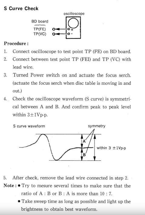

@cupitza : I am not familiar with this pickup, but what just came into my mind when reading ManoloMos' comment, there is a little chance that maybe only the angle of the lens needs adjustment. If not done, take note of its current position (measuring distances) and maybe give it a try. Apparently, this CD player seems to have a kind of test function you could use (like the test above) where it may only try to focus.
