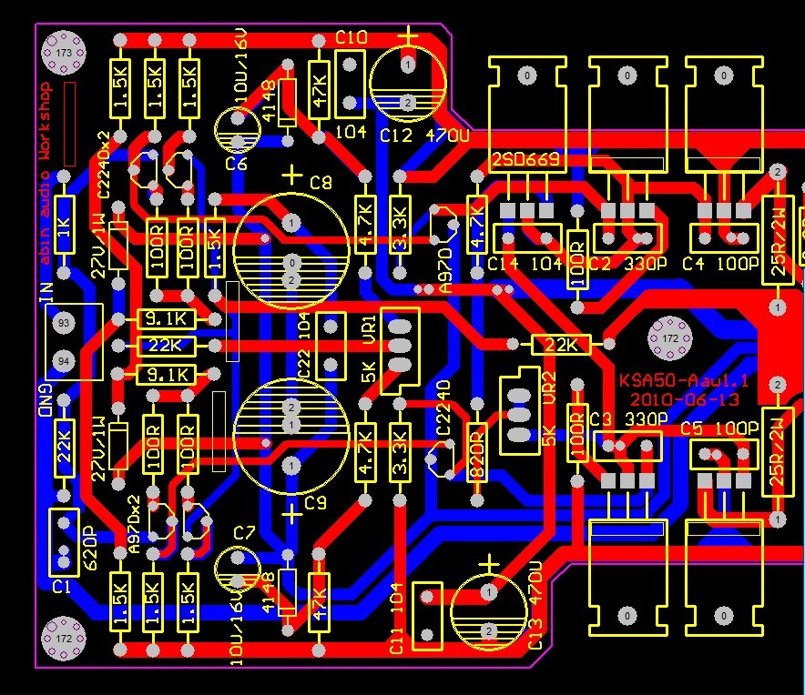

KSA50 IQ about 2.5 A.
They will be divided into two or so share to four only diode. Common silicon diode voltage should be in 0.55 V.
Rectifier diode general fever should be approximately 1.25 * 0.55 * 4 = 2.75 watt
Although there will be some hot but not be damaged. The best way is to the tube mounting a tiny radiator, we can ignore the existence of the diode.
