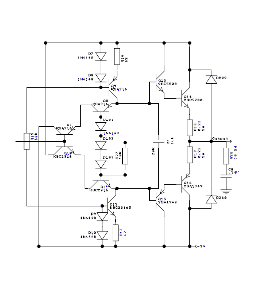

Can we post results of similar or exact circuits as long as the circuit is close to the original, and the schematic and picture is posted?

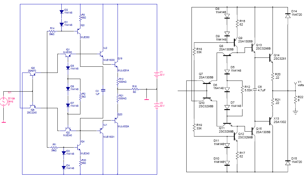

Here's mine next to the one originally posted by Steve at the start of this thread. For my purposes, this was close enough.

When did R29/R30 (56.2 ohms) in the collectors of the bias transistors appear? They weren't there in the earlier schematics.
Were they used in the circuit with the claimed low distortion?
The difference in circuit operation is non-neglible.
The 1st ones I can find at 56.2 ohms are from 11 Feb Schema.
He started adding this trimmer network on 2 Feb. but the values were 220 ohms.
If you are using an older schema make sure that you have R9 (68k) going to GND and not -36 Volt regulated.

OK, MJL, I thought you were being divisive in building what you did & then saying it was close enough. You can see how I felt that some major elements were left off what I considered the circuit we were all talking about, hence my accusations towards you & my request to understand what you were trying to prove!
Apologies if what you built was a genuine effort to build an accurate Krill OPS! No hard feelings, I hope
Edit: Can we all agree on a definitive schematic for the 50W, 100W & 200W output stages? The VGS isn't important, its the OPS that is unique & interesting.

By MJL - Here's mine next to the one originally posted by Steve at the start of this thread. For my purposes, this was close enough
You had to change values since you didn't use steves parts
a "nobrainer".
Same with using the 2sc/sa 's for the drivers , my krill
oscillated , so I added resistors.
I also used the KSA's for the bias gen, but had to up the
CCS currents to 10mA to get crossover distortion to
a acceptable level. VERY predictable outcomes.
None of this "bastardizes" the original design , since the
outcome is the same...it works.
OS
megajocke said:MJL & ostripper:
It depends on how much bias voltage is needed for the output stage, the devices used and so on.
Again, I wasn't looking for audio nirvana here, just to see if this configuration behaves as my sim suggests.
The sim indicated "relatively low distortion"- this is not visible on a waveform on my scope - check.
The sim said "stable" - this is definitely visible on the 20k squarewave - check.
Sums up what I wanted to know for now. I may build a more permanent version (but, like everything else I build, it will not be the "by the book design").

By jkeny -Can we all agree on a definitive schematic for the 50W, 100W & 200W output stages
That is matter of device choice. I have noticed that in
the most popular DIY amps (DX and quasi amps) they
use MJE340/350 or TIPXXX almost exclusively. The reason for
this is worldwide availability.
In most of the diy amps a substitute can be used (standard EF)
with no problem, but not in the krill.
maybe multiple groups of krills (power levels / common devices)
this would allow more to build it.
OS

Great idea. I've decided to build the output stage (OPS) and for testing purposes I will use an OPA445 as the voltage gain stage (VGS). I am working from Steve's post #805 and BOM from #809 for the 50W version.
Given the OPS tests well, I plan to use a much different VGS and use 2 amps in bridged mode.

By jkeny -you don't want to build the Krill OPS just you're variant or are you just trying to defend your original circuit?
Nobody seems to "get it" here. if you use different devices
you MUST make a variant of the circuit. It is not "improved",
,but needed for proper operation with
different devices.
The same as if you swap LTP devices , your input stage
would require different degeneration resistors and/or
a different compensation scheme.. not improved , but
required for proper operation.
OS
