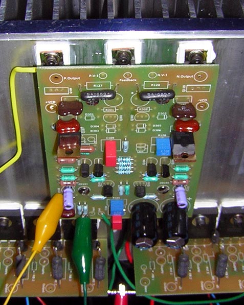

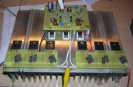

I use Jan's boards, the first ones, with correct traces.
About heatsinks, I will put q111 with outputs on main heatsink and drivers on separate heatsinks. I hope this 3,8 K/W will be o.k. (four heatsinks for four drivers) for 37 V rails and 1.8 A bias. If not, I can always put biger ones.

Neychi, driver power...
..at idle is a little less than 2w. At full power into low impedance loads this could quadruple, so you could see as much as 8w going into the driver heatsinks.
It is also proportional to the rail voltage and idle current. The figures I'm quoting are for the 37v/1.8A idle current case...
With heatsinks rated at 4c/w, you would have an increase of 32c above ambient, for a total of ~55c, hot but not too hot, so you are fine with the heatsinks you've shown us.

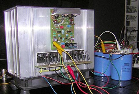

Mark has made a channel or two using them, though AFAIK he is now trying out the new pinkmouse layout...
Yes, Both baords work just fine but the Pinkmouse version is ALOT more flexible and ALOT easier to deal with the driver transistors, I prefer all the heat generating devices to operate together on the main sink. If you don't want to mount the drivers on the main heatsink as I have done with both versions of the boards then with the Pinkmouse version you can do it either way..... you can leave the driver board attached to the main board and just place soome short jumpers to connect the two boards together or seperate it from the main board and have the flexibility of mounting the drivers right near the outputs. This later method keeps the wiring between boards to short lengths, not over a 4" piece of wire.
Also the advantage of having the outputs spread farther apart with Pinkmouse's board is a large advantage in dissipating the amount of heat generated.
Mark
The present state of the Jan board version True Monoblock..... both drivers and bias were moved to the main sink. Extending the driver wiring this way then mounting the devices with silicon grease and then mounting the board over them was a real pain and a mess but works out well. Pinkmouse's version eliminates all the hassles of extending the drivers/bias and gives you a choice as to where and how to mount them!
Mark
Mark

Stuart Easson said:..at idle is a little less than 2w.
Doesn't this depend on the type of output device used, Stuart ?
If i look at the data of the MJL21193/4 hFe is around 90 at 0.9A bias per device.
With a couple of volts on the base of the output devices the current for the bias and the 25R resistors is already good for 4 watts of dissipation in the driver.(37PSV, 2 in parallel, 0.68R)
With 7A bias, 6 devices in parallel, i am looking at nearly 7 watts continuous dissipation for the driver.
(with the good fortune of having high hFe G-type Sanken's)
For the 25R resistors i picked Caddock style types, mounted on the heatsinks.

Yes, 200watt/2Ohm, already mentioned much earlier in the thread.
Per channel:
4 times 25V 300VA toroids, 6 Siemens B41564 LL 47000uF capacitors,two 2.5mH choke coils, two 0.21 C/W heatsinks with four 4.75" Papst fans, 12 Sanken 1216/2922.
Voltage regulation for the front end with two 9Vac toroidal step-up transformers.
(bought the 300va toroids by the crate at a few dollars the piece, using 8 of the same for the 10 device Leach's, and 8 for the bridged 6 device Leach's, all new identical computer types with long sleeved primaries, posted a picture of the heap at a Pass thread.)

I suppose I startred all of this discussion about steel with my pic of my P101 ground plane. I will happily change out the nuts and bolt to brass or copper next time I have it appart. I have to wonder though about those who said they use a lock washer on the conection. Aren't those made of steel and wouldn't that defeat the purpose?
Another thing, I see in Marks post #2809 that he only mounted Q109, 110 and 111 on the main heatsink. Don't Q107 & 108 need heatsinking?
Also, can Q109 & Q110 share the same heatsink with out being insulated or would I have to use Kapton tape and plastic washers?
Thanks, Terry
Thanks, Terry

Also, can Q109 & Q110 share the same heatsink with out being insulated or would I have to use Kaptom and plastic washers?
Yes, they have to be insulated with what ever you prefer to use...... These devices have full rail potential on the collectors(metal tab). I use ceramic-alumnium oxide insulators on all my devices cause I can get em cheap at surplus.
Mark
