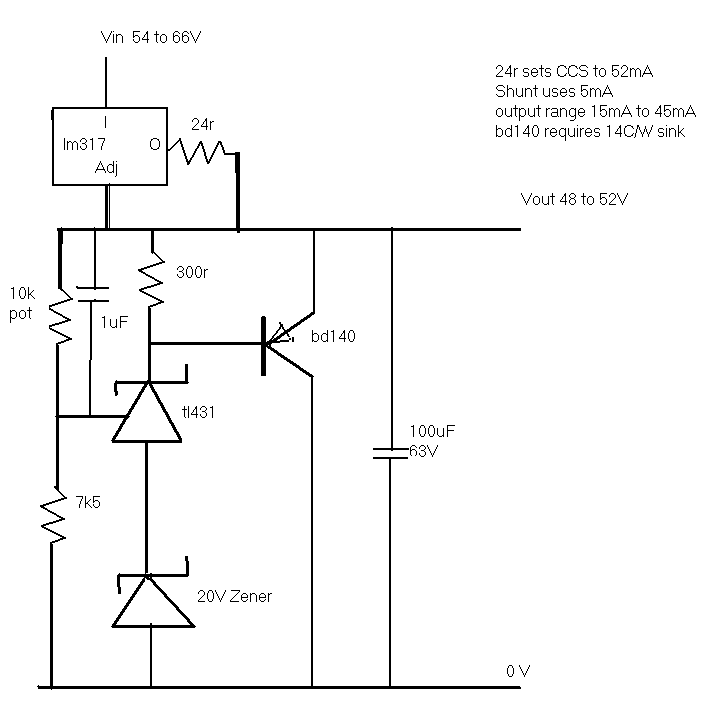

I have been experimenting with PMA's CCS + Shunt regulator.
By adding a Zener to the TL431 tail I got a fairly good 52V out of it.
Noise on the basic 15V version is about 0.3mVpp on the scope.
This 52V version has quite a bit more noise at 1.5mVpp.
Might be worth putting an extra cap on the Zener and maybe a small one across the electro on the output.
Output drifts from 51.80V @ start-up (cold) to 52.14V when hot.
Very simple and cheap components.
The Klone requires about 32mA for the front end, excluding the drivers, and Pwatts arranged for the PCB power to be split to just suit this short circuit proof low current supply.
I've seen the stacked Zenners + Follower.
Any other suggestions for a low current regulated supply?

A cap in parallel with the zener will help a lot. Try 100uF and upward. A small resistor in series with the zeners also help, with the cap still in parallel with the combo.
I had very good results with the stacked zeners (two drops the noise very low) but its regulation is not ideal due to its lack of feedback. Much better than just using the main supply though, and Krell regulated its KMA's supplies rather nicely with a single zener follower for the drivers and front-end.
Just building it for the 39V supplies instead, i.e. replacing the 39V zener and 1k resistor on the board will also help and be easier due to the lower power dissipation.
For the 39V supplies though, an excellent method is a high-precision voltage reference, a low-power opamp (for inverting purposes) and one OPA547 per rail. The positive rail adds the necessary gain for 39V from the reference in non-inverting mode, the opamp inverts the reference and the other OPA547 adds gain for the -39V. With the small opamp it allows the negative OPA547's to only use its negative terminal powered since their maximum rail difference is 60V. TI has a high-voltage low-power opamp capable of +-39V rails so it's not necessary to subregulate its supplies. Only pity is that TI has recently taken the OPA547 off the sample programme and they're quite pricey.
The same method can be used for the front-end and drivers too, but then the OPA548 or OPA549 would be necessary. For the 39V supplies it also isn't necessary (although still recommended) for a separate power supply; the opamps good regulation and high PSRR makes it suitable to be driven from the output stage.
