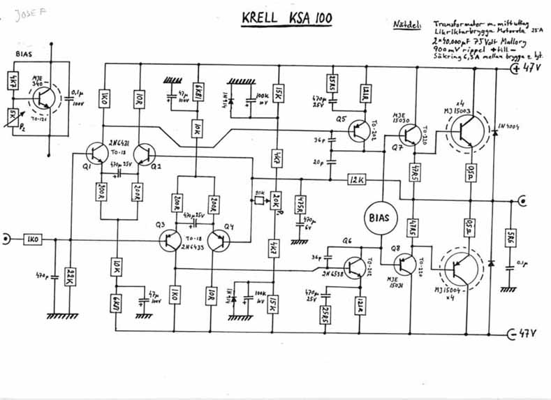

my mouth is still open with the scmatic of KSA 100.
First of all a run of the mill project that not even use corrent sourses in the LTPs but even worse use a electrolitic capacitor with no dc voltage across the emiters of the LTPs.
Amazing world!!!

Has anyone been able to figure out the right transistor types
on the posted Krell KSA 100 schematic? Looks interesting.
