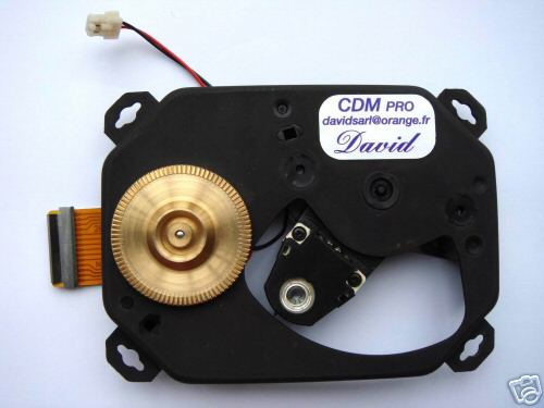

I am looking for a part for my Krell KPS-20i Cd player. The transport and servo board went bad on me imagine that from a 10K CD player!!
I need help... Does anyone have one of these or know where on earth I can find one?

This cd-drive is called Philips CDM-9-pro and is not available anymore.
If you're lucky you stumble across a new old stock part that was kept in a shop or private somehow/somewhere.
But who says it's the drive that broke down? Did you have the unit checked out?
thanks for your response - much appreciated
You can use the Laserunit of a CDM9/44 (the Krell KPS20 i uses the CDM9/60 or CDM9Pro) The motor on the pro (CDM9/60) is a more expensive brushless type.

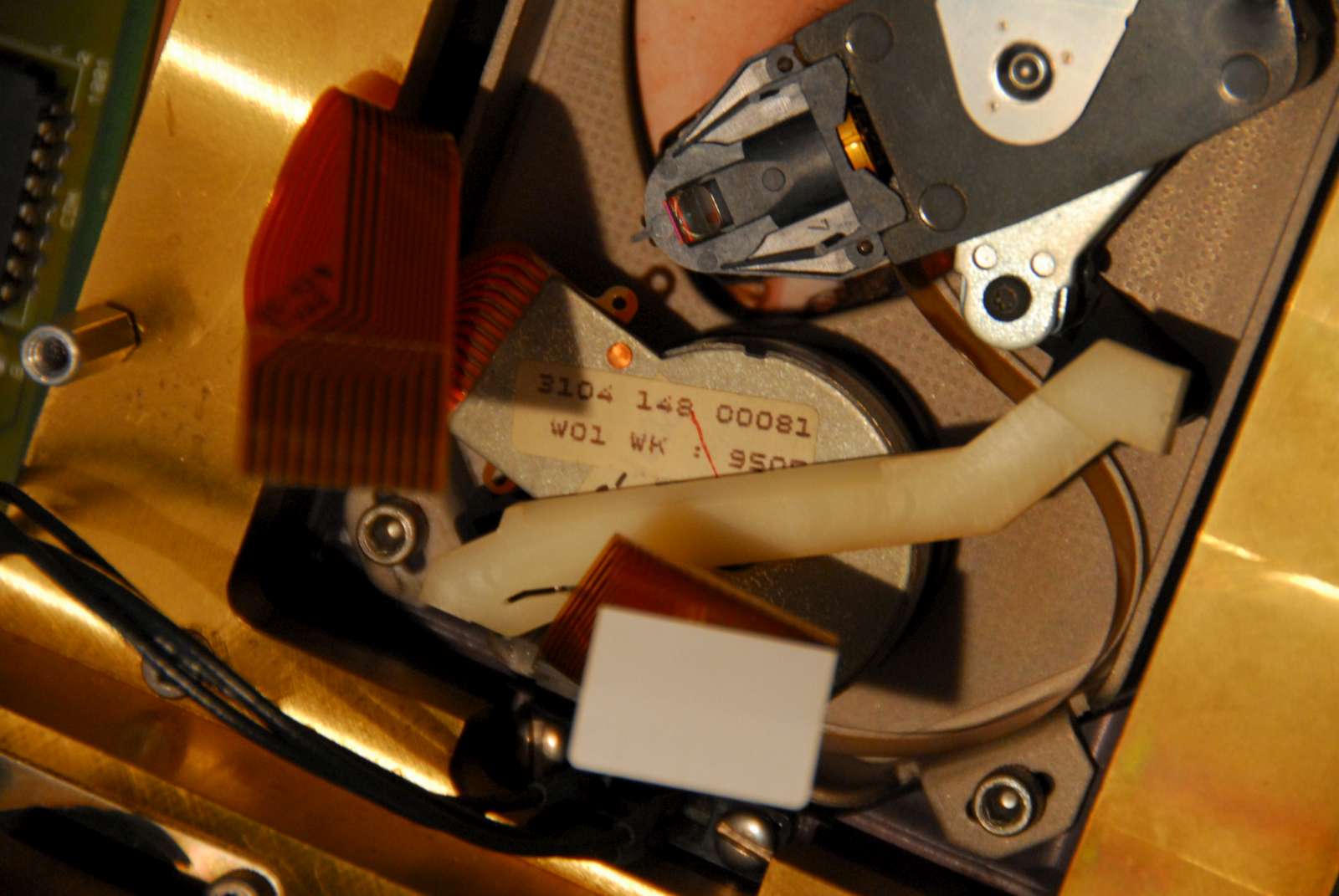

I have the same problem and had a so called original Laser but after I swapped it it still did not read any data.

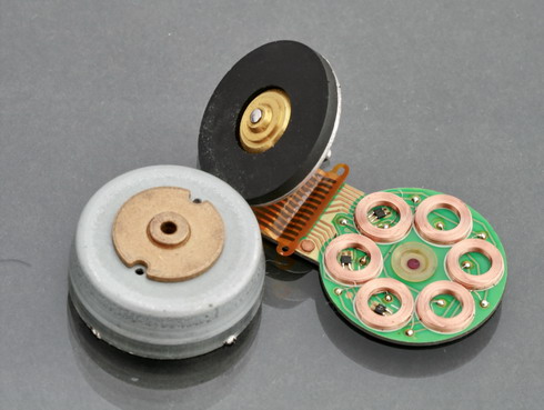

I just bought a CD Player with a CDM9/60 unit to prey on but Krell also altered the platter on top of the spindle of the brushless motor....:(
I'll keep you posted on my progress or failure
Don't expect any help from Krell.
The last time I contacted them about this matter they just said: "Buy a new one" period.
The brushless motor should be a Mabuchi brand but nobody knows the exact type.
