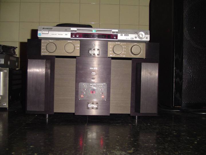

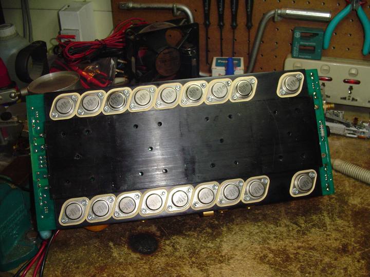

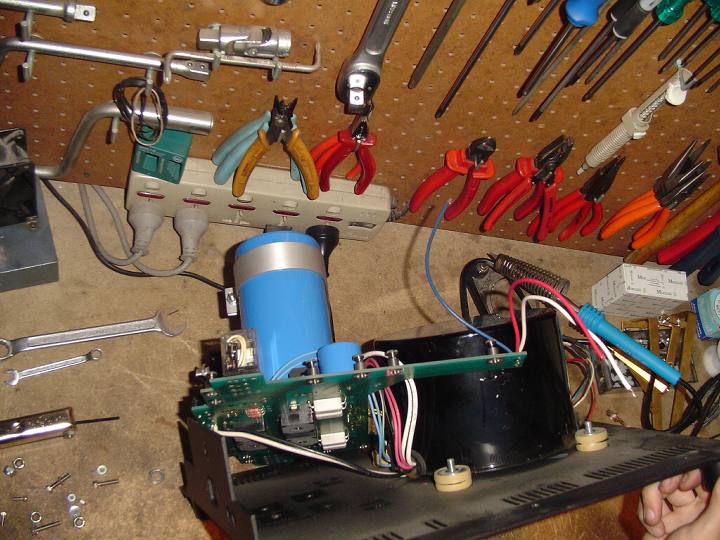

There are a few photos od my Krell KSA 100s. Manufactured on 1993. Each channel have a 9 Krell 484081 and 9 Krell 484002, then each channel have 18 power transistors, 36 in all Krell. I have broken only two Krell 484081 on one channel. What I must to do? Only change those two? use MJ15003 or MJ21194 ? Or change all the transistors of the channel?

AndrewT said:
Is the 100s the same as KSA100mk2?
I think the 100S have the "sustained plateau bias"
I think the two transistors out on their own are the drivers.
The other sixteen are an 8pair output stage.
I suspect that the 8 in each pair are matched.
If the drivers have gone then replace with individual transistors.
I cannot see how a singleton among an 8pair could fail and leave 7 working.
But if one of the 8 has failed then I think you must replace all 8 with a matched set.
Will Krell supply a matched set?
Or will they insist on $$$$$ for an approved repair.
Let's hope it's the drivers.
But, don't use a slow driver with fast outputs.

The KRELL is WORKING!!!!!
I replace the 3 x Krell 484081 with 3x MJ15024 and the Krell 484002 with MJ15025. All transistors are from output stage. Krell sells the transistors orginal´s $15 each.

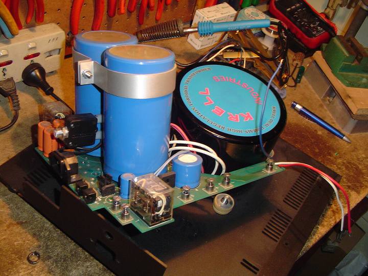

Also replaces all nichicon capacitors that are destroyed by siemens capacitors.

if the replacements are 15024/5 and they are working correctly then the original 484081/002 cannot be equivalent to 3281/1302. They must be equivalent to some other type.fepablo said:The KRELL is WORKING!!!!!
AndrewT said:if the replacements are 15024/5 and they are working correctly then the original 484081/002 cannot be equivalent to 3281/1302. They must be equivalent to some other type.
How long will it work?
How does it sound?

Hi guys. The original replaces of 484081/002 are 3281/1302 100% sure, but they are discontinued. The 15003/4, 15015/14, 15024/25, 21193/94 are very similar family of transistors. In the ECA VRT manual, MJ15015 is a direct replace of MJ3281, but i dont use this because he have 180w and the MJ15024 have 250w like the 3281.

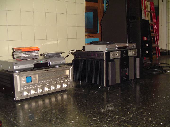

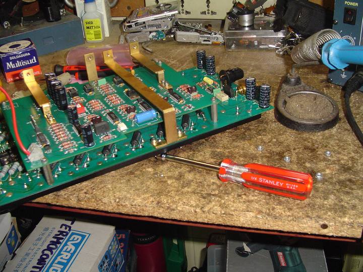

The sound is better, i replace transistors of one channel, caps of both and work same the two channels. I have a Martin Logan Sequel II Speakers.
I use the amp few night for many ours without problems or high temp. I attach more pics of the process and my other baby, Marantz 2500.

the 3281 is very different from those others. They are not equivalent.
The gain higher
The gain droop @ high current is lower
The speed is higher
The SOAR varies between types
The power and current ratings are different.
I still think you should have bought a matched set.
I hope this modification works out OK.

Hi Friends, finally, 2 years after, i buy the original transistor at Krell.
