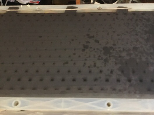

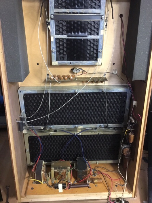

Stretch wires, those that go directly to the emitter from the panel number 1 (right channel) to the panel number (left channel) 2, or it is technically possible to remove the panel, change places, you can transfer the stuffing electronic, swap. Choose what is easier for you and write a result here. It is very difficult to read minds at a distance, more tactile and photo information. Be careful, the wires coming from the electronics to the panel carry a life-threatening strain. Your emitter can be repaired in Hungary and Russia. There are my friends.
