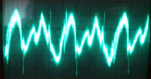

Kofi Annan in: "Oscillatin' in the Bevois Valley'"
What's the square wave frequency in the photo? (Or, better yet, time per division)
The asymmetry between the ringing on top and bottom suggests that the transformer isn't perfectly balanced side-to-side in terms of bandwidth.
Transformer imbalance is very common in less-than-top-end iron. And sometimes there, too. Generally, it's fixed by bringing things to the lowest common denominator, that is, crippling the better side so that it matches the poorer side. If you measure the DCR of the transformer primary from center tap to each end, one will have a higher resistance. That's the side which is likely to be poorer. Across the other "better" half, tack a small high voltage cap, say 680pF/1000V. See if that makes the top and bottom of the square wave more symmetrical.
If it does, you'll have a couple options to get that bit nailed down, one of which is the old Dynaco trick of running a small feedback cap from the UL tap of the "better" side to the feedback summing junction.

Kofi Annan said:
Also, I noticed that my plate voltage for the first stage is a little high-- about 310VDC. This could also be causing a problem, I'd guess, so maybe I need to drop a few more volts.
I hope you don't really mean the voltage on the anode of the first stage? I hope you really mean the HT for the first stage that should be 285V? It's a little high, but probably not worth getting too worried about.
Your square wave isn't amazing, but it's probably as good as you're going to get.
Edit: I was going to add "without fiddling with the output transformer" but I see SY has beaten me to it.
Well, let's make sure we're talking about the same thing here. I set the function generator to a 10K square wave with the cool mad-scientist dial thingee to "1.0", which I'm hoping is a multiplier for the frequency which, in turn, would mean this is a bona-fide 10KHz square wave.
So, messing with the transformer may yield some positive results, eh?

OK-- so I finally received my new capacitors and soldered them in yesterday. Everything is working and the oscillation is gone, but it took a little fiddling even with the measurements.
I had initially used alligator clip jumpers to test the 68pF mica capacitor paralleling the feedback resistor and it worked fine. Once I soldered it in, though, some oscillation appeared. I added a 38pF in series and the oscillation went away.
I thought that this was odd, but I guess maybe I'm picking up some crud near the socket that I didn't pick up when I had the cap alligator clipped into place. Anyway, the oscillation appears to be gone and I think we're in good shape.
I tested the square wave from the right channel for the first time (I had assumed that this would be similar) and it was quite dissimilar to the left channel. One thing I noticed is that the top of the square wave seemed to roll off (it angled downward a bit instead of being horizontal).
I noticed that when I put the amp back in service, the bass was more pronounced such that I had to rearrange the speakers in my room to avoid excessive boominess (this is likely due to the Buschhorns' rear firing bass port in a small room) and that the highs seemed a bit rolled off.
I think I'll reduce the value of the grid stoppers (currently at 1.5K) and see if I get some of the highs back.
Any thoughts?
Kofi
