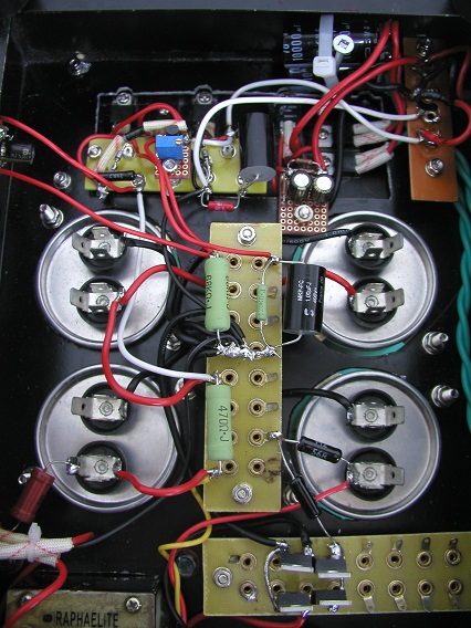

external power grounding
Just finished the external HV shunt as first step, I tied the case to power supply ground together with the shield of the power transformer. The power output is actually floating right now in reference with power supply ground. I noticed there was about 50V AC between the chassis and power output ground, should I link them together with 0.1U capacitor? I have concern of ground loop if I connect the power output ground directly to the chassis.

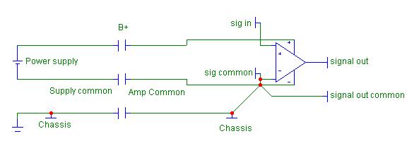

Best to show a schematic of exactly how the commons and earth are tied together.
But here is the general way to do it. Let's talk about "common" and "earth" as two separate entities. Commons are the power and signal current returns. Earth is only the safety earth connection. I suggest that you earth the power supply chassis. Also run an earth connection from the RIAA chassis to the earth point on the power supply chassis. Star connect all your supply and RIAA commons at the RIAA amp (no common to earth connections at the power supply chassis). Run a single connection from this point to the earth connection in the RIAA chassis.
If you want, you can lift the common to earth connection with a resistor (10R or so), or with an anti-parallel diode pair. You may also want to use a small film cap across the resistor or diodes to shunt any RF noise to earth. I have found that if I am careful with the commons, that I don't usually need the lift. The exception may be, when you have interconnected devices that are on different mains circuits.
Sheldon
Here's an example. Ignore the circuit complexity and just look at the commons (denote with a C) and the earths (earth symbol). The supply and RIAA amp are in separate chassis. The supply commons are connected with an umbelical cable to the RIAA common star. The star is connected the the RIAA earth. The Riaa earth is connected via the umbelical to the earth point in the power supply chassis.
Hi Sheldon,
Thanks for the diagram, that explains everything perfectly.
So far I only connected power supply chassis, transformer shield and power plug earth together. Just need to run a seperate cable for Power supply chassis to Phone chassis (common ground). Since my power-amplifier (comercial one) already has RCA to earth, I guess I can ignore the common chassis cable as well.
