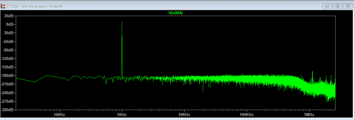

May i ask which settings do you use when simulating opamps ?
I understand that settings can make or break the analysis ... and i am quite ignorant unfortunately
I am getting practically the same exact THD graph by different op-amps I really do not know how to proceed
I am attaching an example
Thank you very much and good evening

Hi Ginetto, your start with Fourier analysis is not the easiest one to choose. But Google is here too your friend, there is a wealth of information and videos that can help you. See for example the video FFT analysis basics and chapter 8 of the downloadable book analog design techniques.
I'm not a specialist either but if I can help you further you may send me a private message.
In my experience, THD simulation of discrete circuits using good transistor models can give you comparatively useful results (i.e. this topology vs. that topology), but forget about predicting accurately the performance of the actual circuit, it's not unusual for simulated values to be one or two orders of magnitude lower than the actual measurements.
As for opamps, I've never even bothered. The models are usually too simplistic to account for the various distortion mechanisms of a real opamp (they're more about other things like transfer function, offsets, stability, etc.), so I'm not surprised you find negligible THD with most of them. If you want to know how real opamps perform in terms of THD, a very good source based on actual measurements is Samuel Groner's excellent paper on opamp distortion.

Agreed, but simulation may still be interesting for learning about design differences for audio. See, for example, small signal audio design by Douglas Self or when making overdrive guitar amplifiers. The point is that the input signal must be distortion-free in order to measure anything meaningful. In practical terms (equipment) this is very expensive, and in LTspice it is not self-evident. How to do this within LTspice is explained very well in the YouTube video.

Of course, I didn't mean to imply that opamp simulations are useless, I've done hundreds if not thousands of them... It's just that ginetto was trying to evaluate opamp distortion and, for that purpose in particular, simulation isn't very useful, given the way opamp models are built.
For many other purposes it can be extremely useful, but, as is always the case with LTSpice, it all comes down to how accurate / complex the model you're using is. I find the table in the Burr Brown application bulletin I linked above very useful to see what exactly each model can simulate, and some people have taken the time to tweak models to match reality much better than the stock ones, like fellow member Nazar Shtybel, see here.

Hi ! thanks a lot for the very kind and valuable advice With the excellent support of Mr Mooly i have already used LTSpice to simulate some simple line stages and buffers of commercial units I tried with old Naim preamps and failed Very strangeHi Ginetto, your start with Fourier analysis is not the easiest one to choose. But Google is here too your friend, there is a wealth of information and videos that can help you. See for example the video FFT analysis basics and chapter 8 of the downloadable book analog design techniques.
On the basis of what i have done so far the choice of settings is fundamental to get a reliable result
With the setting i am using (that can be found in the attached file) almost all good quality opamps behave pretty much the same
The problem is that the results are not realistic (see attached fft)
at this point i am looking for some advice about best settings for opamps simulation

thanks a lot for the very precious advice Yes that was my impression But at least sim SW can say basic important informationIn my experience, THD simulation of discrete circuits using good transistor models can give you comparatively useful results (i.e. this topology vs. that topology), but forget about predicting accurately the performance of the actual circuit, it's not unusual for simulated values to be one or two orders of magnitude lower than the actual measurements.
like a circuit that cannot work ... the calculated working points and power dissipations ... the effect of changing parts and supply voltage values
in order to get a feeling about how reliable the results at sim can be i have started simulating commercial products of which i have read the lab measurements And yes i have founr the sim results too optimistic vs the real measurements In some case exagerately optimistic and even not realistic
thank you very much indeed for confirming a very fundamental point As i said above from what i read in the lab testing is very difficult to beat opamps with a discrete design In some cases almost impossible like the mythical ad797As for opamps, I've never even bothered. The models are usually too simplistic to account for the various distortion mechanisms of a real opamp (they're more about other things like transfer function, offsets, stability, etc.), so I'm not surprised you find negligible THD with most of them. If you want to know how real opamps perform in terms of THD, a very good source based on actual measurements is Samuel Groner's excellent paper on opamp distortion.

I learned that there is a plethora of things that can go wrong with simulated THD measurements. Just to name a few:
You may get too bad results in case of too low resolution of the simulator, such as to too big timestep.
Or measuring too early before a steady state is reached, which may occur likrly with big coupling caps, for instance.
You may get too optimistic results in case your low THD relies on exact match of transistors or
specific compensation techniques to cancel non-linearities that rely on exact one set of transistor parameters ...
You have to fiddle with a lot of LTspice settings and I recommend to play with them to learn their effect on your results.
Furthermore in reality there maybe parasitic effects like ground loops etc that are not simulated at all.
Anyway, each simulation is only a gross approximation of reality, you have to learn the limitations.

Hi thank you very much for your very valuable adviceI learned that there is a plethora of things that can go wrong with simulated THD measurements. Just to name a few:

Personally i have been much more worried about too good results that cannot be true from a scientific point of view ... like HD down to -150dB etc.
Bad results for me are the norm ... i am used to those But when the SW puts out results that cannot be realistic ... then i get puzzled
completely true and a truly fundamental point. As soon as I downloaded the SW and saw a video on YouTube and I tried to simulate a simple circuit and make an fft. The graph that came out was pitiful especially from an aesthetic point of viewYou have to fiddle with a lot of LTspice settings and I recommend to play with them to learn their effect on your results.
Then with the precious help of Mr Mooly who provided me appropriate settings, such beautiful curves came out that I fell in love with the SW.

So i start to simulate some circuits taken from service manuals of commercial line stages and buffers of units lauded for their sound.
One thing i have noticed.
When there is voltage gain the HD usually goes bad also in commercial units. I cannot get 2n harmonic distortions lower than -100dB
Instead for buffers providing up to 2V into load of 5kohm i can go lower than that And so i am focusing buffers

However, it is now more than clear to me that settings are fundamental. But to choose the best ones you need to know what you are doing
I need to find a publication that explains what a timestep, resolution etc. is. etc.

To answer your last question: I like to use LTspice for very fast evaluation of analogue circuitry ideas.
I used it to design my personal latFET amp and played with it for about a month.
Then I designed the hardware using KiCAD.
Happily I can say the simulated outstanding performance simulated was close to the measured results.
But this was a long road of fiddling with LTSpice and the circuit design as well.
Another great advantage is you can explore circuitry and understand how things work.
The capability to measure currents in the femto-amp region and bandwidth far beyound audio lets you explore things you never dreamed of in reality.
