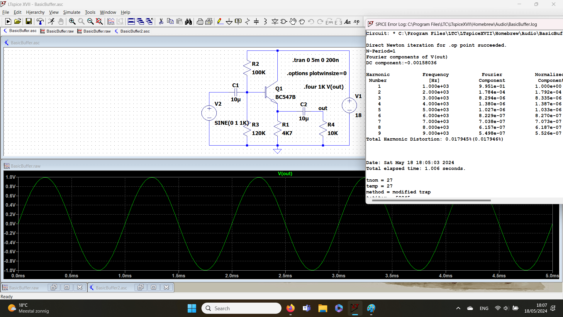

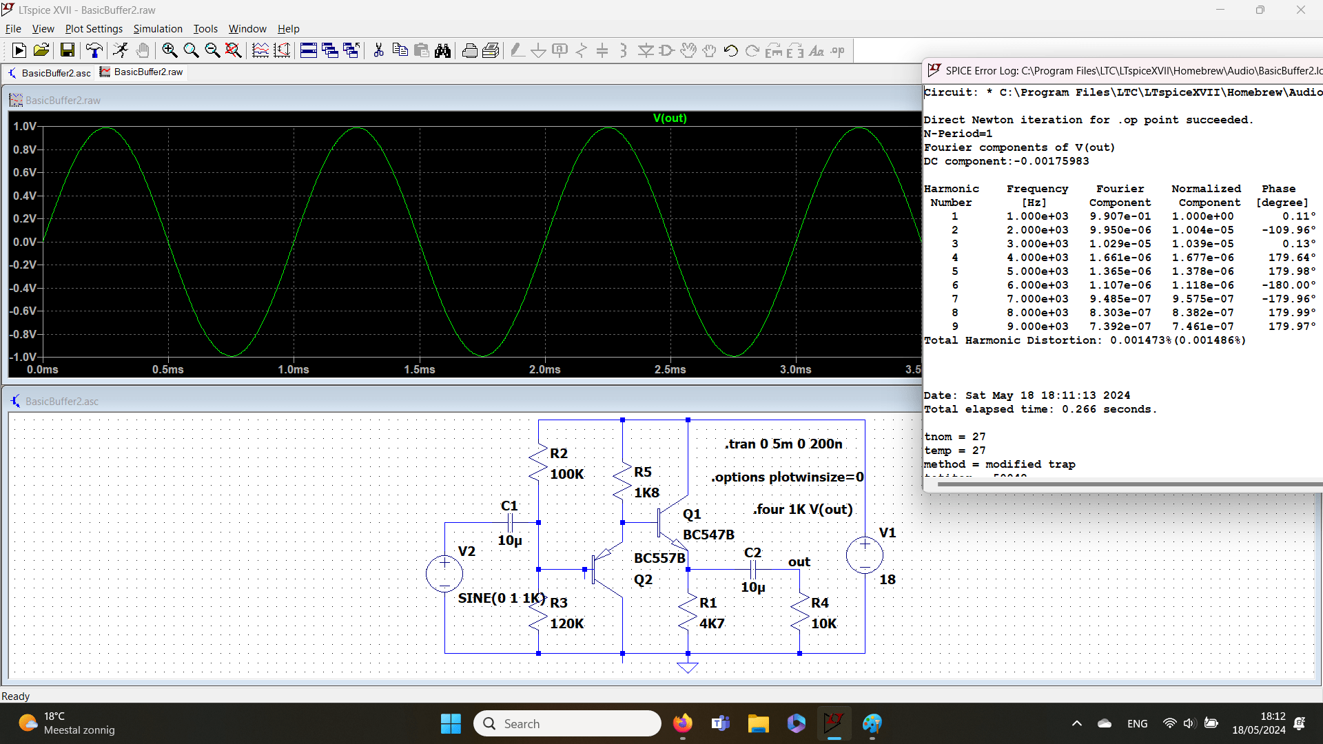

Another 2-Bjt option is the repeater or duplicator circuit.
It relies on cancellation to reduce the THD.
This is the simple follower, for reference:
The THD is 0.018%.
If a complementary transistor is added in front, cancellation occurs and the THD is reduced by more than 20dB:
Of course, the resistance ratio's have be carefully chosen for a good cancellation to occur.
It is also possible to connect the collector of Q2 to emitter of Q1, but the resistors values need to be adapted
