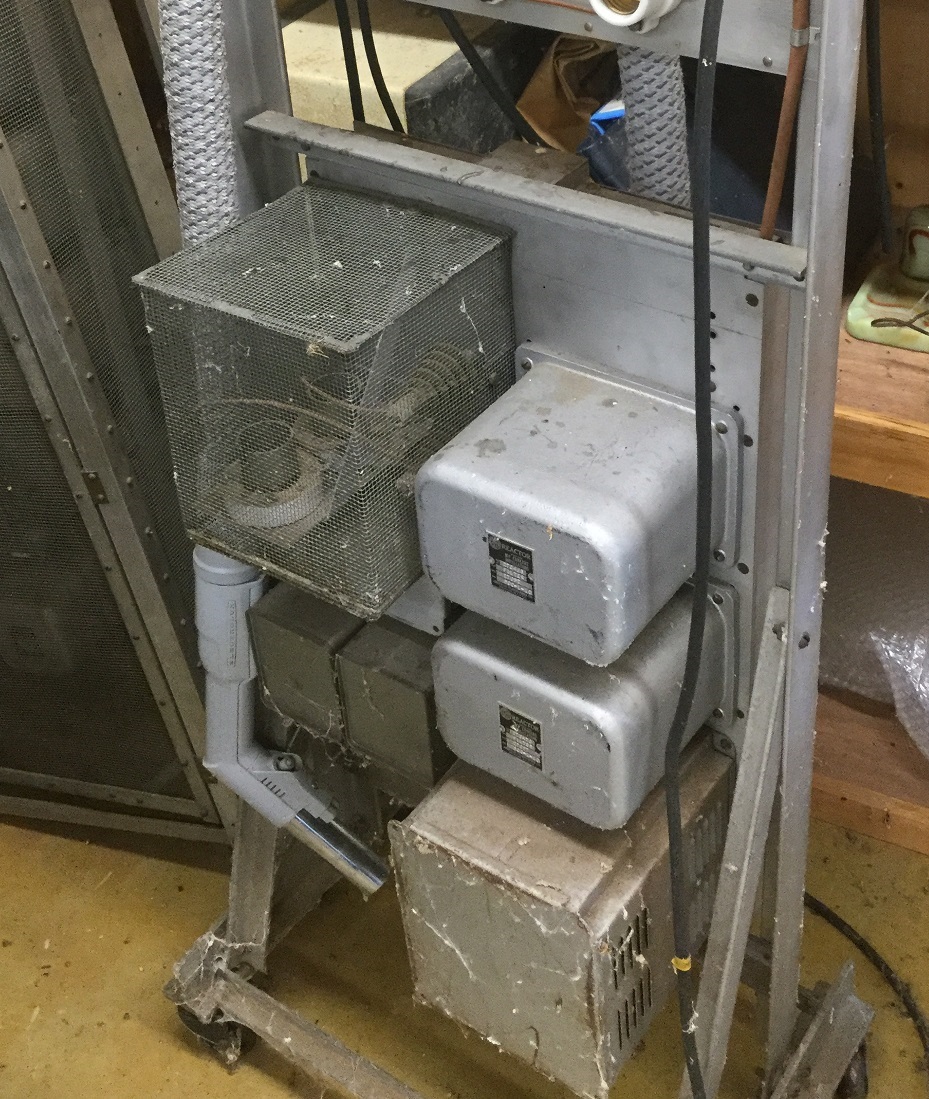

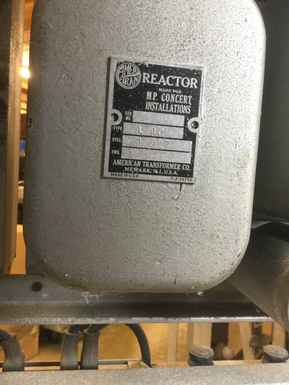

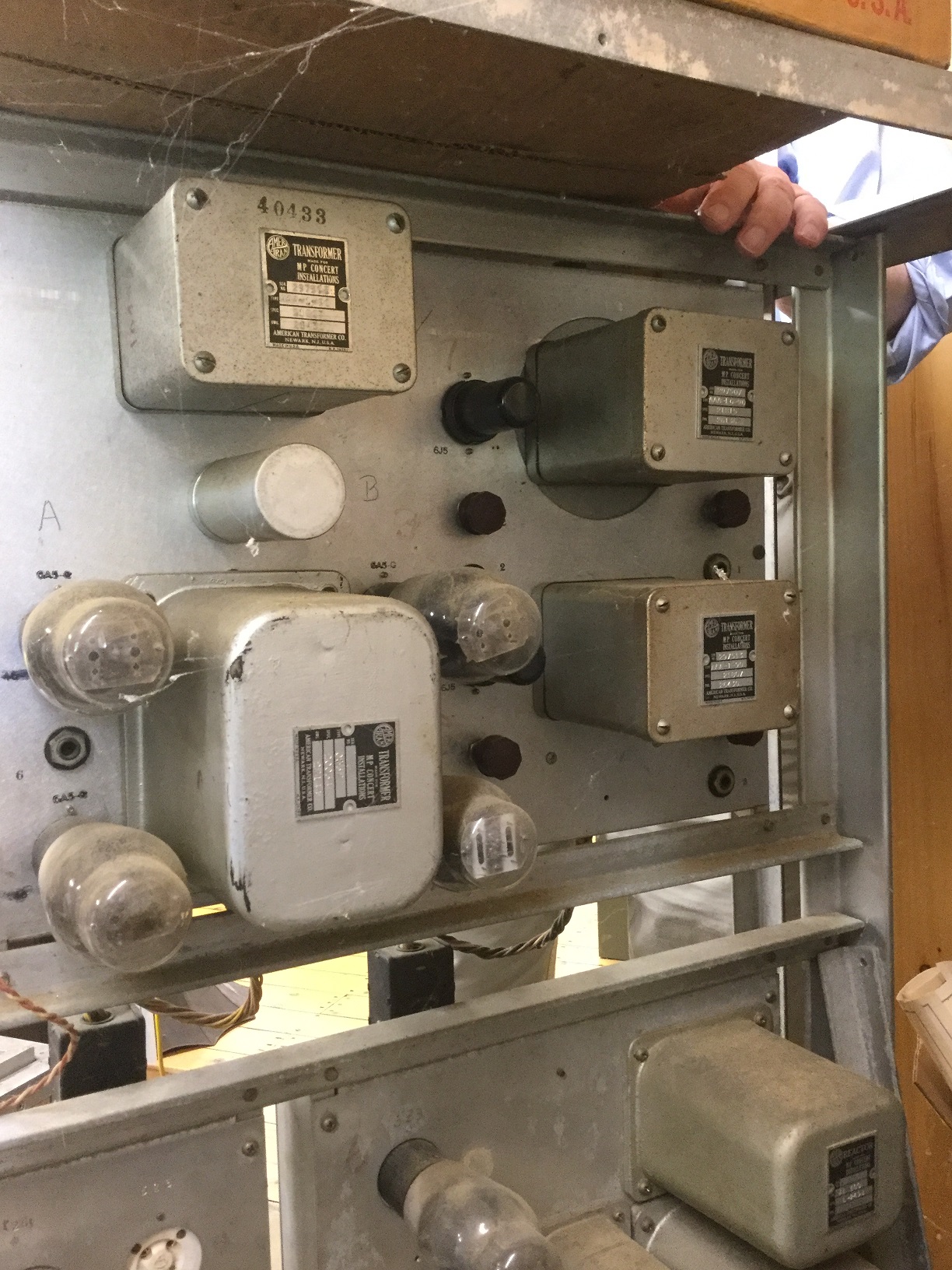

One of the photos I posted showed the amps as I received them. They had been in storage for at least 30 years and survived two moves. a few of the tubes were missing or broken.
The good news: I also received a 3rd amp along with the pair shown in the photos. Between the 3 amps I more than enough tubes to populate two amps. I also have been buying replacement tubes when I come across them.

Looking at the pics above, looks like Mirko really did use xfmrs abundantly. Hardly can find the tubes even. Would have been real interesting to have had a talk with him about his design ideas and opinions.

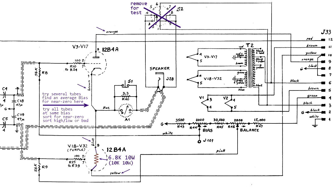

...I couldn't do any better that 3.4V....
Your plan to sort by pairs does not make enough sense to me.
I would rig a test jig. Actually I would rig the *amp* as a test jig: it's got the voltages and the trims.
Remove all 12B4. Find a handy "lower" 12B4 socket and tack a big resistor across it, to simulate a "tube".
It looks like upper and lower are identified by wire-color.
The "remove (timer) for test" is a brain fart. The timer will open quick enough, and the tubes do need to hot-up.
Now load one "upper" socket with a healthy-looking 12B4. Find a setting on the "Bias" pot to give near-zero DC voltage at the center-point as shown. Don't be precise yet. Grab another 12B4 and find its zero-bias. Do a few more and find their zeros. Set-aside any oddballs. See if there is a bias pot setting where they are all near-zero. Leave the bias pot at that position.
Test all the tubes........
I had thought: do you want an adapter to avoid socket wear? No, you have 15 identical upper sockets, rotate, you don't have to be in/out of each socket more than a few times.
Tubes within +/-4V of zero are fine.
Tubes that read + at CP are "hot"; tubes that read - at CP are "lazy".
If CP goes to -150V that tube is dead. If it goes to +150V, that tube is shorted and the test-resistor will soon smoke.
Tubes say +4V to +8V, and -4V to -8V, should be identified +/-V and, if possible, paired. Tubes outside that are dubious: mark and leave aside.
I think tubes well within 4V can all go in anywhere. They average-out to less than 4V deviation, and should bias-up and also "balance" OK.
If you have to use outliers, do it in pairs of "lazy" tubes: a -5 in upper and a -5 in lower. The "lazy" tubes may wake-up at FULL output, which is when you need it.

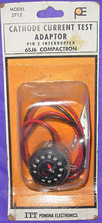

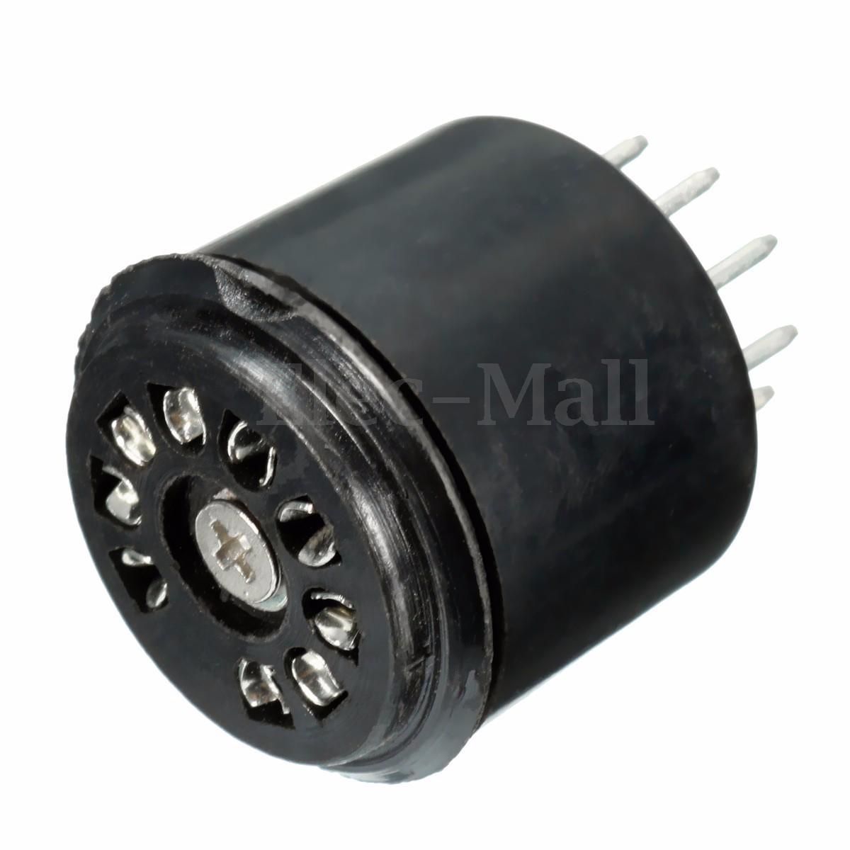

Pomona made plug in test adapters for measuring tube cathode current.
Although I haven't seen one for the 9 pin mini base. You may have to make one. There are 9 pin mini socket savers which could be dis-assembled to make one. Although I don't know how they secure the cut pin mechanically. Maybe use two of them with the pin bent out, taped together.

It is not clear to me how he set the bias pot.
RPP,
I seriously appreciate the amount of thought an effort you have put into this project ! This is all great info.
I understand (for the most part) the tube testing procedure that you have proposed, but, I need to clarify a couple of things:
The meter (M1) that is mounted on each amplifier is a DC current meter. It has a 500-0-500 Microamperes range.
Switch S1 is NC. When S1 is depressed (opened), M1 will display the current(voltage) across R40.
J101 is only used to read the BIAS voltage.
In my earlier post, where I talked about the offset voltage measurements, I was referring to measurements I had taken with my DMM at the speaker outputs on the fully tube-populated amps.
The following is the normal procedure for setting the BIAS and offset balance. This came to me in a note from Mathew Polk (he also owns a pair of these amps).
... If you get to the point of powering up the output section there's a small meter and a test point in the panel below the tubes. When you push the button below the meter it shows the DC offset in the output and should be set to zero. But, first check the voltage in the test point and use the Bias pot to set the bias to -20v. Then push the button to check the offset. Most likely it will pin the meter. If so, don't hold the button down, make a small adjustment with the Balance pot, push again and repeat until the meter stays in range. If you can't get the meter in range do not connect speakers as DC will be flowing through them.
I think your procedure can still be followed, we would just be reading microamperes instead of volts.
Here's a couple more questions:
What is "CP"? Checkpoint?
When we install the large resistor and first tube, then adjust the BIAS, we are adjusting the "BIAS" pot and not the "Balance" pot, right? So the BIAS voltage would not necessarily be at -20V, correct?
The value of the added resistor is not critical (something between 6.8K and 10K), right?
