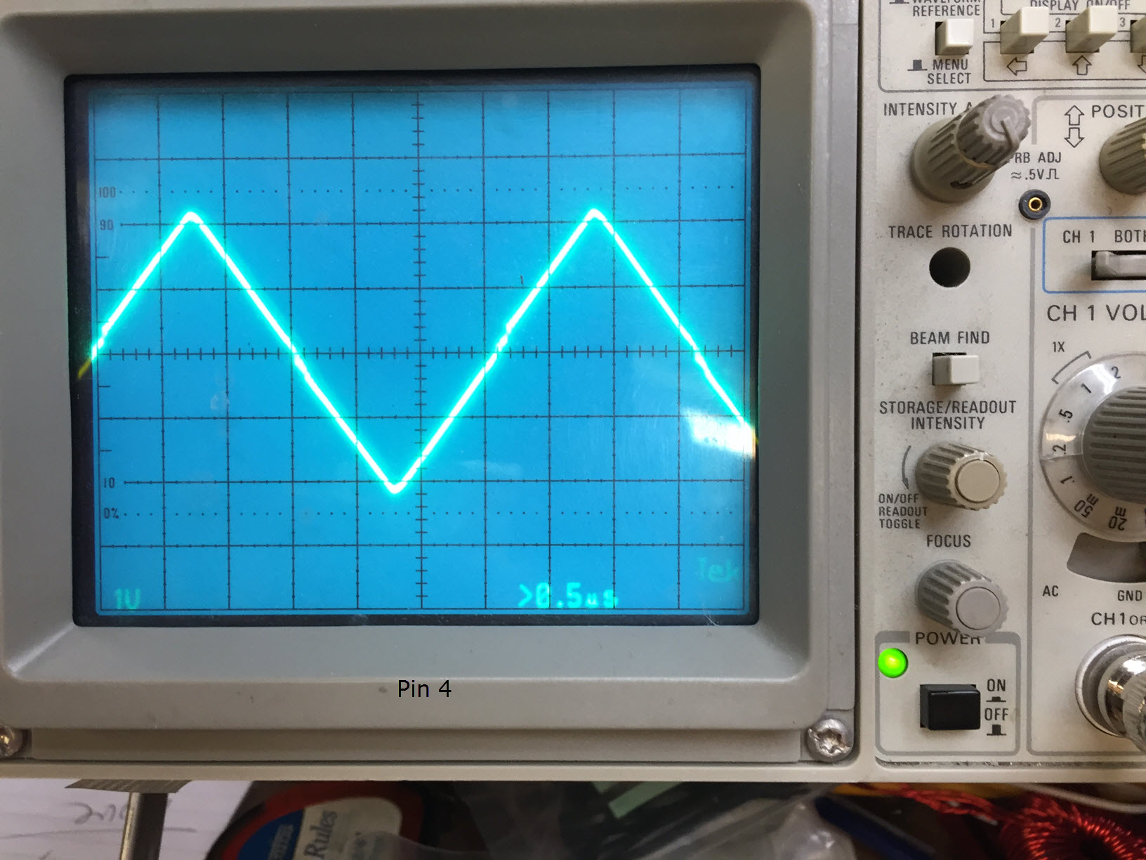

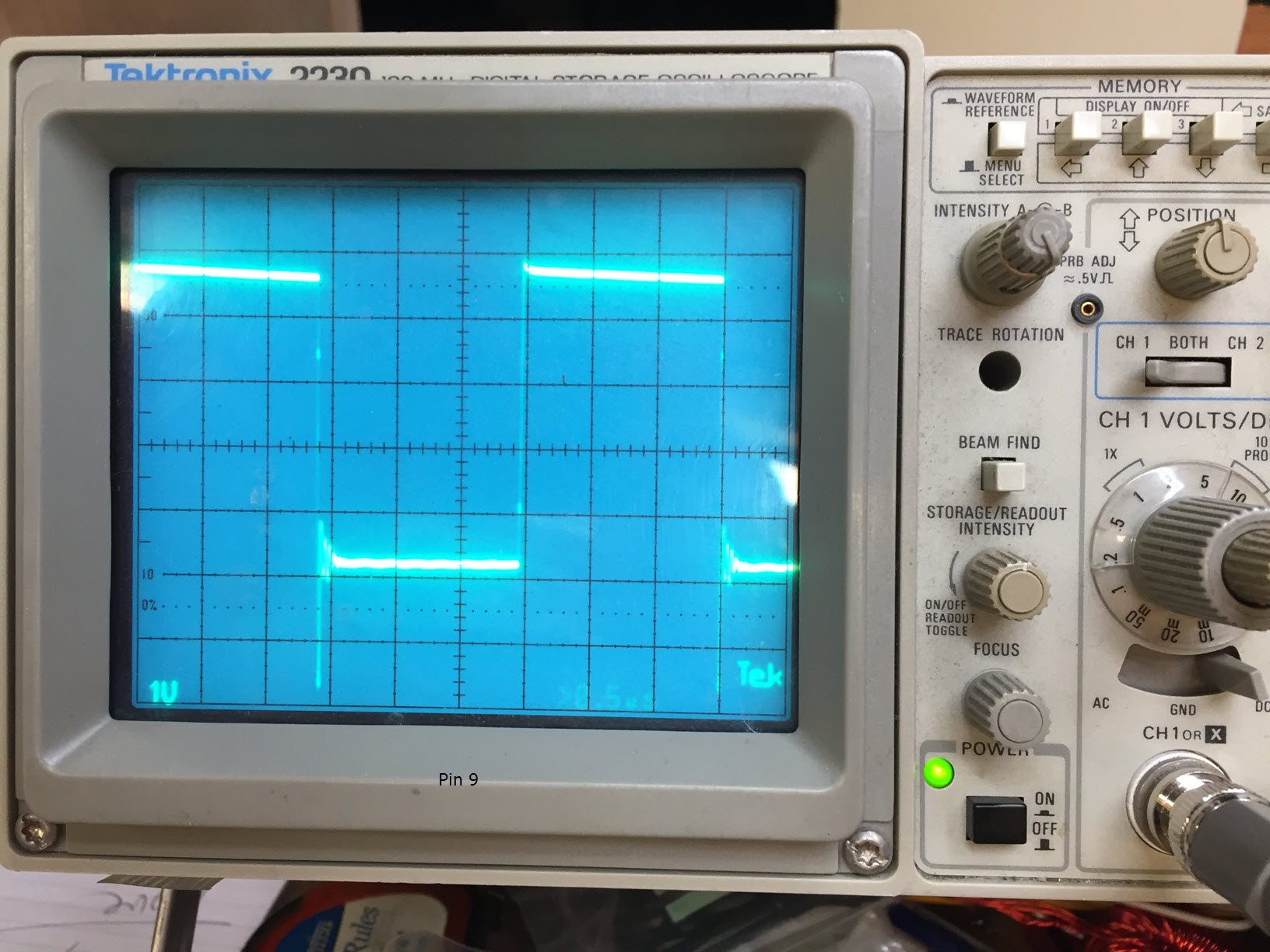

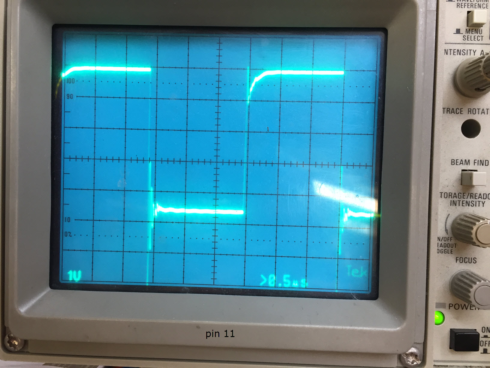

Also, check the DC voltages around the LM361 and waveforms on Pin 4,9 and 11 and list readings and post screenshots. Check DC voltages from Source to Gate on the IRF640's and IRF9640's and check the drive waveform to the Gates and output inductors. You will only need to check one output devices for each bank.

Lm 361
4: .04
9: .09
11 :56

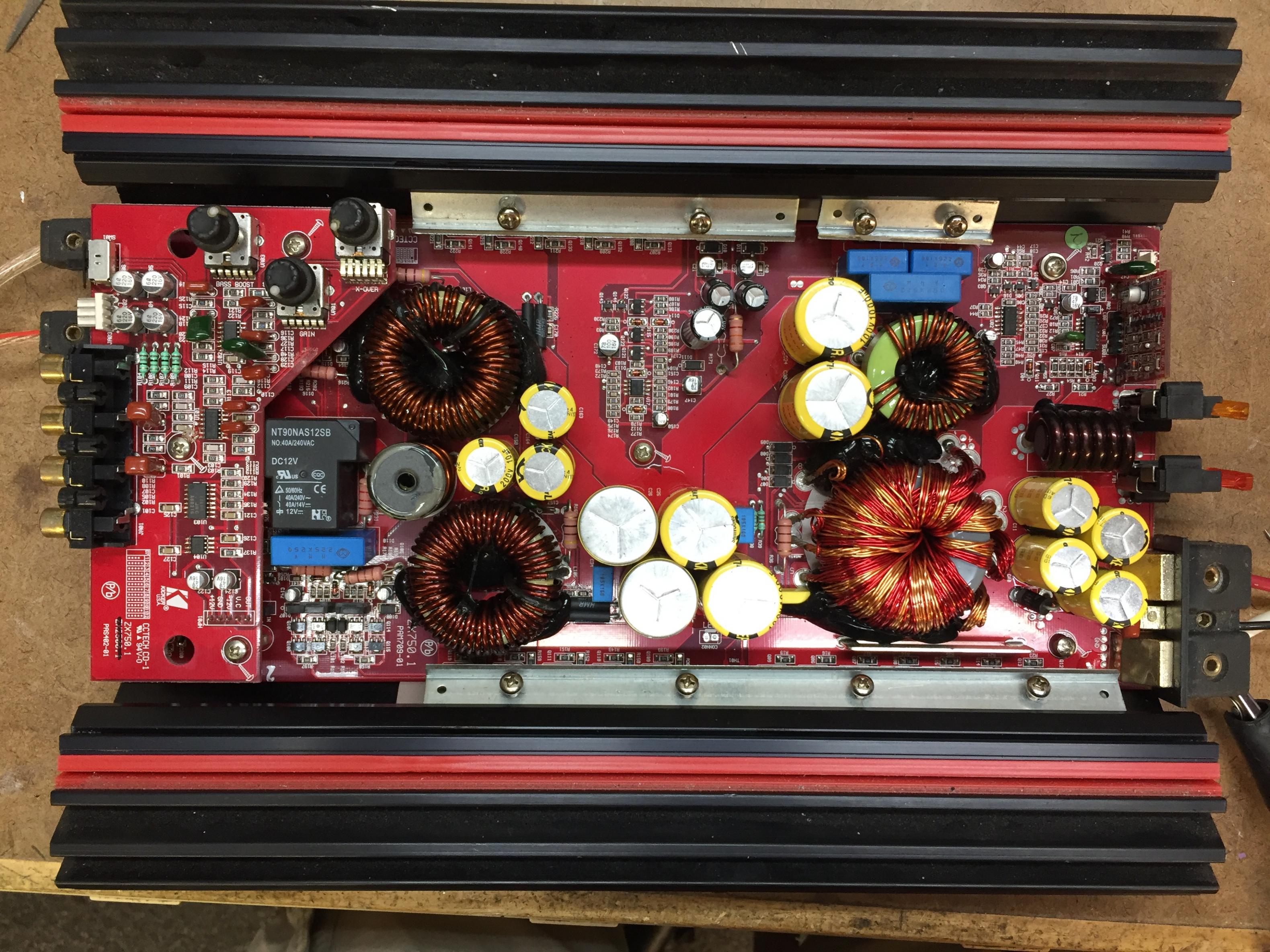

Attached are the images you requested.

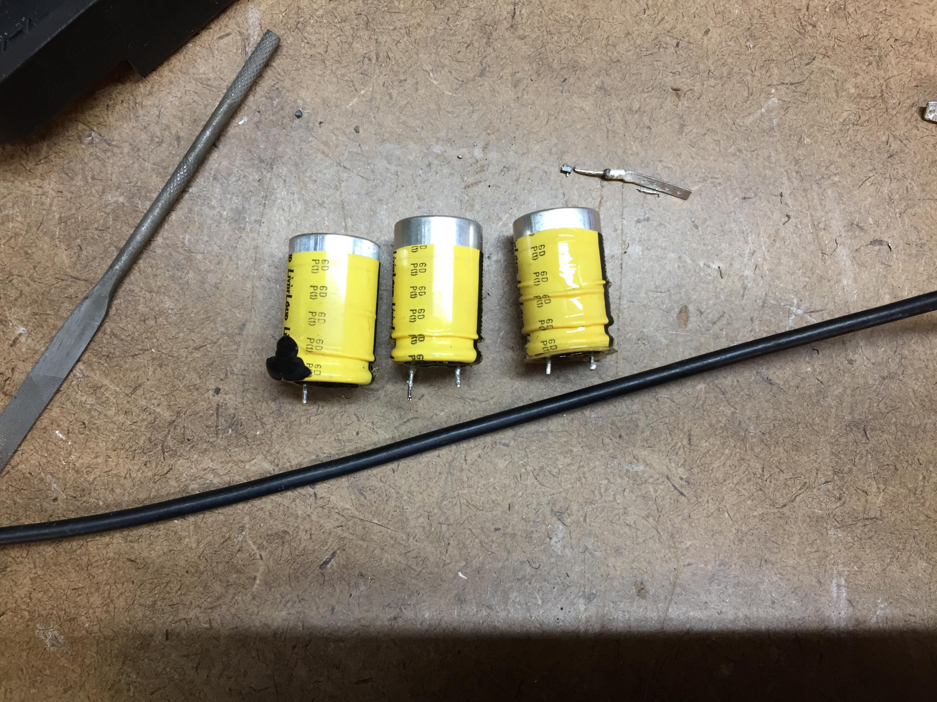

Note the capacitors that appeared overheated. I did replace them. It appears that it may have corrected the problem. But I am unsure, as I need to test more.
Looking at your last post, the Class D circuit appears to be working.
If the caps you pulled are vented as you say, replacing them may have fixed the issue. Which caps did you replace?
