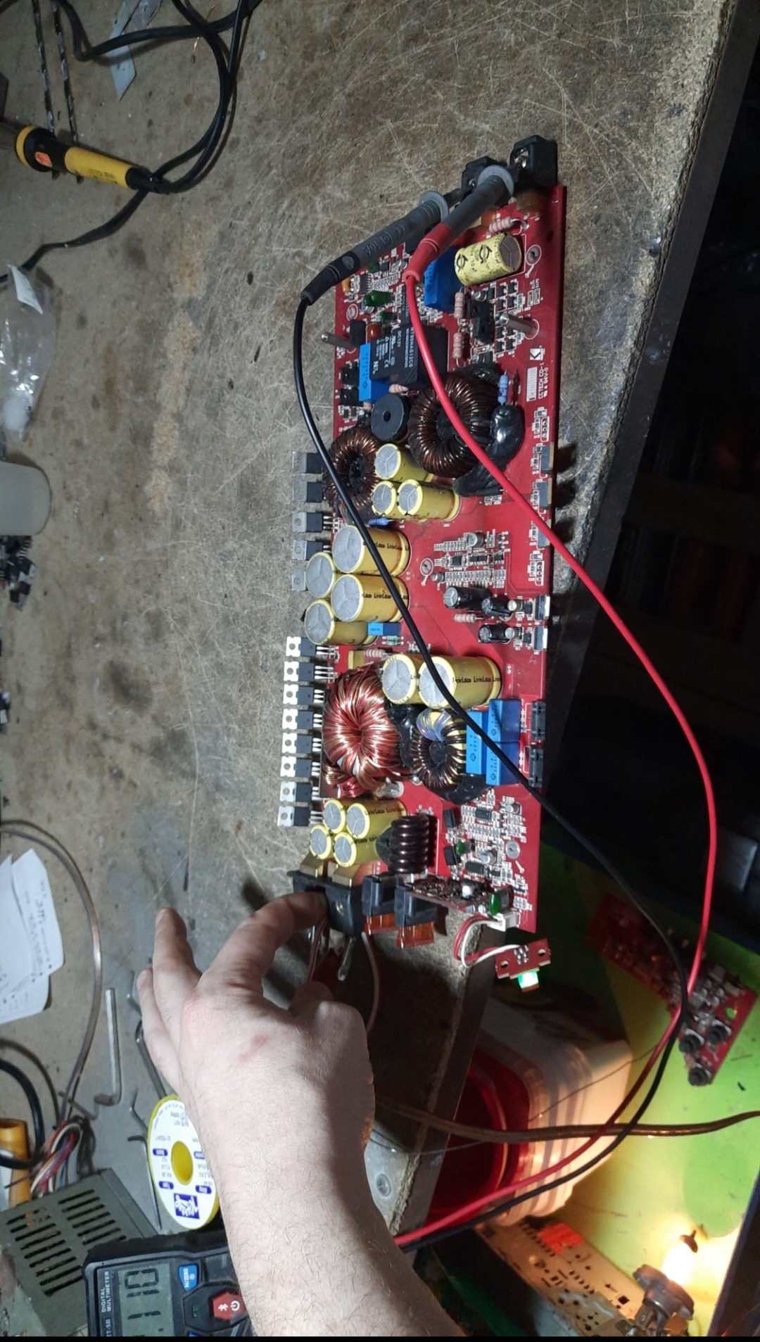

In my examination, there is no problem with the supply MOSFETs and output MOSFETs. The output driver transistors are solid.
The problem with my device is that when I disconnect the lm361n, the power led turns from green to red and repeats this over and over.
But when the lm361n is plugged in, the power LED is fixed in green and the relay does not turn on and the device draws excessive current and the supply mosfets start to heat up.
When 7912 and 7812 are removed, the relay opens.
I suspect LM361n, can you help me where else should I look?

Unfortunately I don't have an oscilloscopeDo you have a scope?
With the LM361 out of the circuit and pad 11 of the 361 connected to the negative terminal of C274, does the power LED stay on?

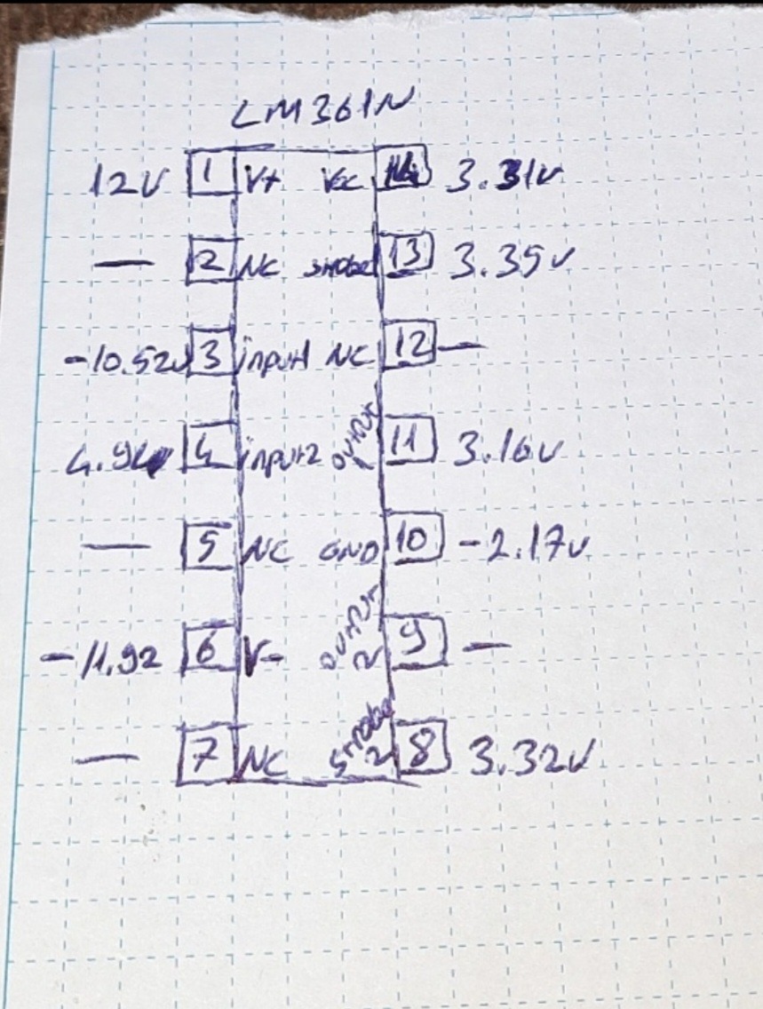

What are the DC voltages on the 4 power supply terminals of the LM361?
What is the DC voltage across the four 12v Zeners (D121 and 3 other similar)?

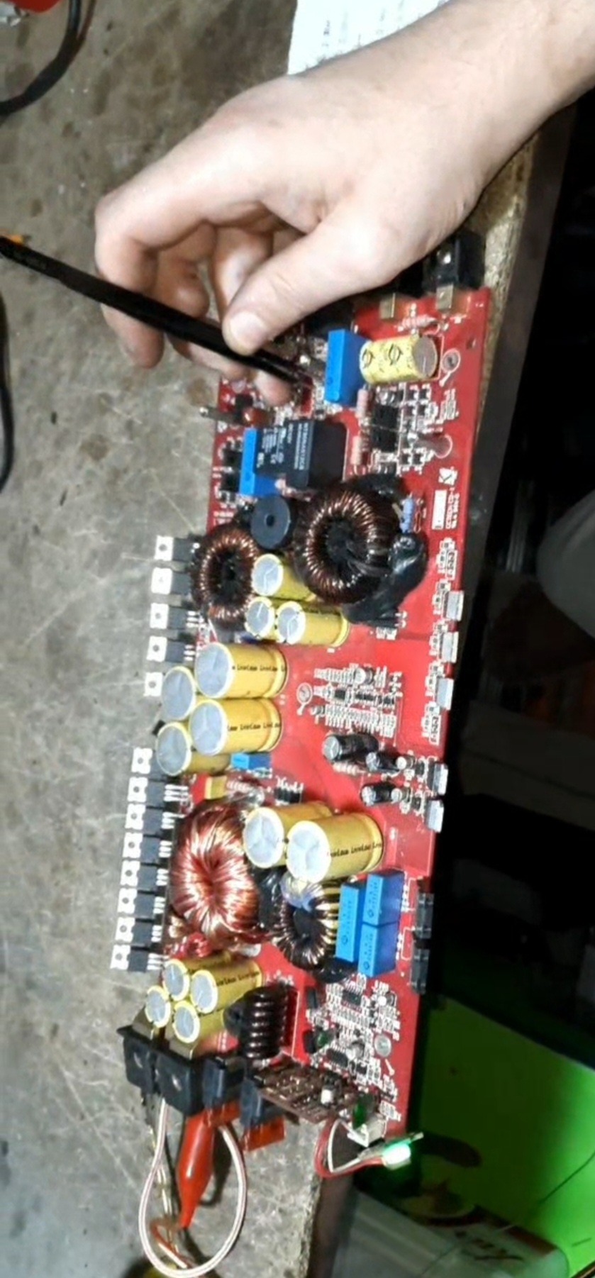

It may be worth noting the output inductors L105,L106 look to be discolored from excessive heat and possibly may have shorted windings. The sleeves on the inductor leads may have become perforated and at the very least should be replaced. We (Kicker Repair Department) use a braided rubberized fabric tubing. I don't know the vendor or product code, but will check Monday and reply.
79.64 khzFrequency on pin 4 of the 361?

Like he stated, at least one inductor appears to be in need of help and will need to be taken out of the circuit. Desoldering one lead may be enough to get the circuit to function well enough to test the drive out to the FETs.
Does your meter show duty cycle for frequency?
Did you remove the bridge from the op-amp?
I removed the bridge from the opamp, reassembled the LM361 into the circuit, a new development occurred, I noticed that the output stage was getting hot, and when I disconnected the A1381 C3503 from the circuit, the device turned itself on with the relay.
The amp has two parallel sections. One is working. I believe the old 361 was defective and would have needed replacement (as you have done).
Desolder one terminal of the inductor with the blackened windings and see if the drivers still heat up after installing them.
Do you see a darkened ring in the bottom of the circuit board under the inductor with blackened windings?
