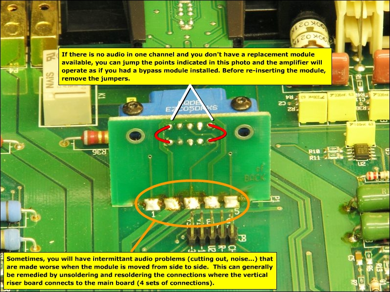

kicker zr series crossover modules: any way to bypass?
See attached.
