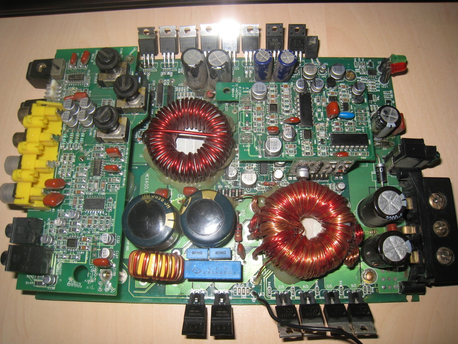

I have kicker kx400.1 amplifier. And it is in protection mode, sort of. Red protection mode led blinks alternately with green led. There is no visible damage on the board.
So i need help to find out what is wrong with it.
Leds blinks with the same frequency as voltage changes on TL494 pins 9 and 10 slowly from zero to 5 volts(square wave). And nothing happens.
When i take off smaller board where input signal goes in and out ( there could be oscilator on it. there are two ICs with text scrached off) and turn on amplifier, protection led dont light up and green LED lights. Voltage on TL494 pins 9 and 10 raises to 10 volts and relay is triggered (close the circuit).
Could problem be on that smaller board with two unknown ICs?

The KX400.1 has two IRF640's and four IRF9640's. It is common for the IRF640's to short. I believe this is correct but it's been awhile since I've worked on one off these amps.
The smaller board is the class D circuit and is also prone to failure and may need to have one or two IC's replaced.But don't worry about that until you know whether the outputs are shorted!
Please post pictures of the board when you can, one of the whole board and a close up of outputs and class D board.

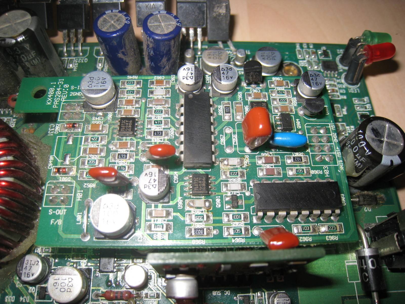

U908 is a weak link on that driver board (PAS204-31?).
Do not remove or install that driver board while the capacitors are charged or while the amp is on. Make sure that it's fully inserted in the connectors at all times. Failure to do so could cause the output transistors to fail.

And about U908. It is located on Your mentioned PAS204-31. Could that be the faulty one? Unfortunatelly I cant tell what kind of IC it is, cause text is scrached off.
When I took off PAS204-31 board of main board and powered up with out load and input, protection led didnt light up.
But with that board attached, voltage was oscilating.

It's an LM361. It commonly fails but you need to confirm that you have all marked supply voltages on the driver board.
If the voltages on the driver board are relatively steady, posting the DC voltage on all pins of that IC could help determine if it's the culprit.
If you attempt to get the voltage readings, constantly monitor the temperature of all of the heatsink mounted devices to make sure that none overheat.

Take another picture on the opposite side of amp board. The KX400.1 and/or the KX500.1 had a modification added to the opposite side for the SMPS (small power supply). You will see a couple of surface mount resistors and zener diodes if I'm right, which tend to get pretty warm and may need to be be replaced and solder re flowed.As I stated in a prior post I will consult with my schematics and dig out a junk board if I can find one, Monday.

remove power from amp, let amp discharge maybe 10 minutes. remove PAS204 board, remove solder bridge from pin 3 for now.
Find D4 (this is a 1N4148 diode) and lift one side up so that it is disconnected from circuit, this will disable protection. Return PAS204 board and power up, you should be able to check the voltages.
Use your mutimeter for the DC voltages and your scope to look at U908 (LM361) Pin 4 (triangle waveform) and Pin 11(squarewave with 50% duty cycle). As Perry instructed black probeand scope ground on negative speaker terminals.

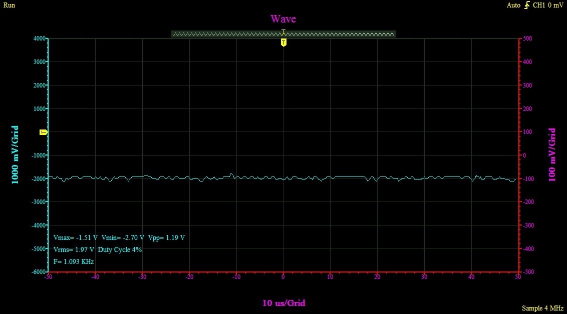

When D4 is removed, voltages can be measured easily.

Waveform on Pin4 is nice triange shape, but on pin11 there is nothing close square wave. On output pin 11 it is more like flat line with distortions.
Later I will add pictures.
So, if output of lm361 is not right, than it could cause all that trouble to amp? Or need to check something else?
Before I disconected D4, voltage on +12 and -12 rail was oscilating too. And i started to think that something is wrong with power suppy side.

The LM361 has 2 sections. The side of the IC with the ±11v operates much like common op-amps and comparators and can operate from higher voltage supplies than the other side of the IC. The other side operates at lower voltages (commonly associated with digital circuits, 5v is the max supply it will generally have -- sometimes +3 and -2v, other times 5v and ground).
Pins 3 and 4 are the comparator inputs. The square wave output on the 'digital' side is determined by those inputs. The triangle waveform has a fixed amplitude. The instantaneous output of the square wave (pin 9 or 11) is high when the input (on pin 3) is above the instantaneous voltage of the triangle waveform and the square wave is low when the input is below the instantaneous voltage of the triangle waveform. The output of pins 9 and 11 are 180 degrees out of phase (one high while the other is low - differential comparator).
If the input on pin 3 is straight DC and above or below the top/bottom of the triangle waveform, the output on pins 9 and 11 will be straight DC. One will be very near the +3 and the other will be very near the -2v supply voltage.
Pin 11 is used to drive the driver stage for the outputs. When it's near 3v, it drives the high-side FETs on. When it's near -2v, the low side FETs are driven on.

replace the solder bridge to Pin's 1 and 2 of U907-TLO72.
Check for a squarewave on U908-LM361-Pin 11, also Pin 9 is not connected, but should have a squarewave as well.
If you don't have a squarewave, replace U908.
If you do have a squarewave U908 is good and U907 is suspect. If changing U907 doesn't fix the problem, there is something deeper in the circuit, that will require further steps, which I will get into after you posts the results of the current steps.
