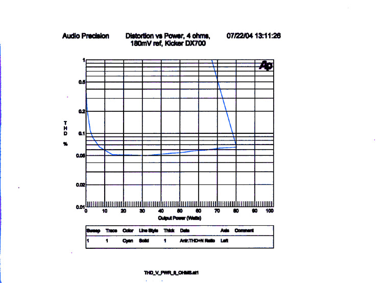

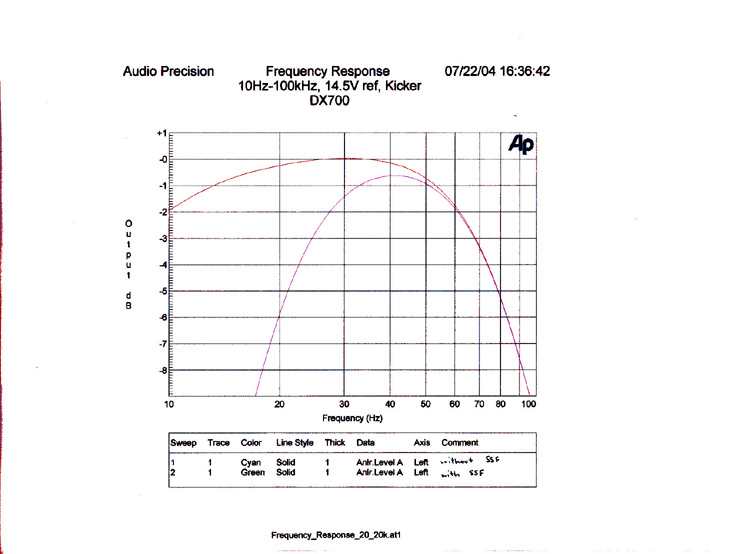

As promised, I finally got them scanned in. I had to Photoshop a bit to get the plots to show up better which is why the colors no longer match and it's blurry. I am no Photoshop master :D
Frequency Response
