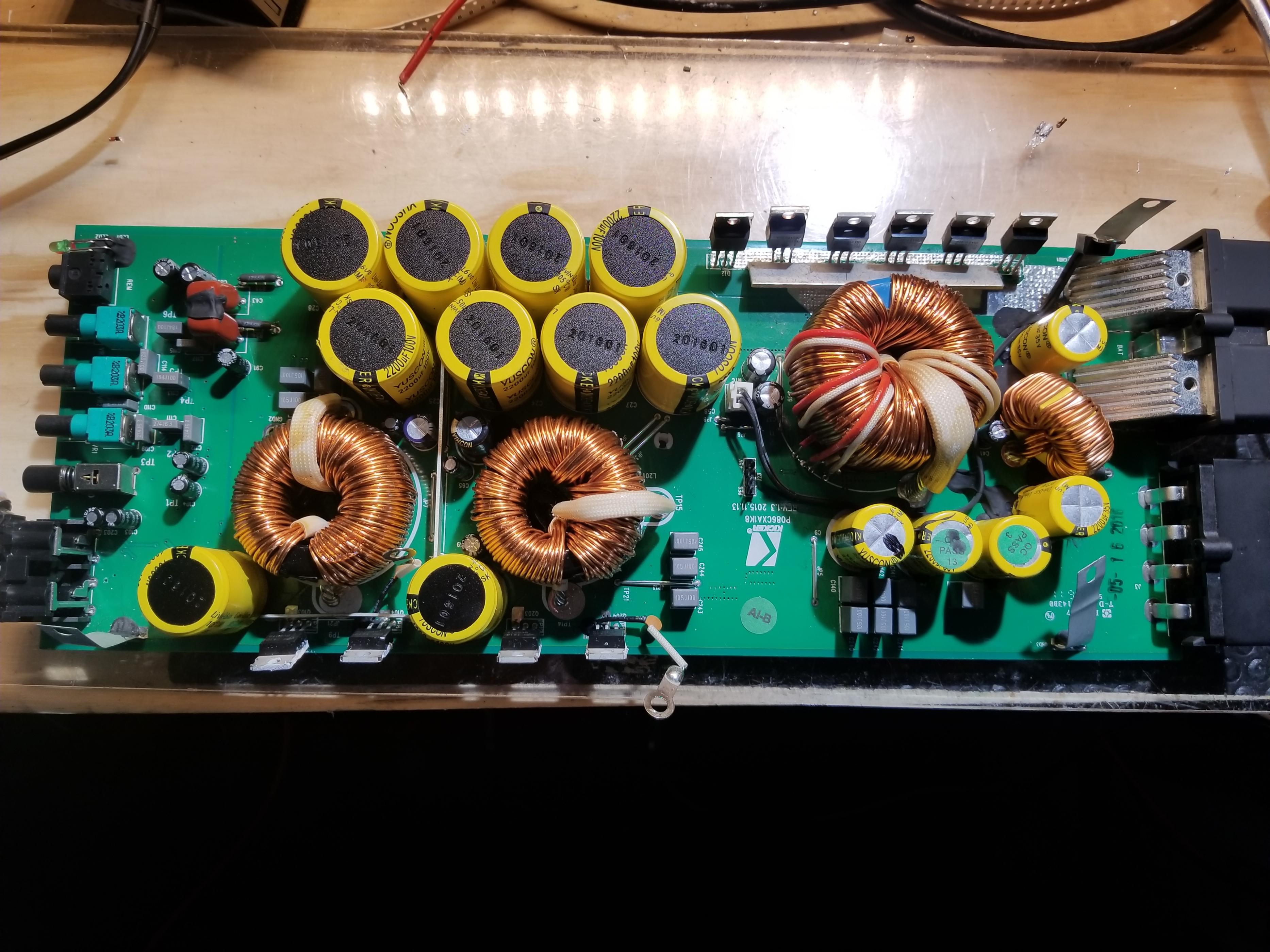

I have a 2017 kicker CXA1800.1d with a low audio problem. I am not knowledgeable with fly-backnpoeer suppy systems. However I have +-15 on R23-R24, drive is present on both output and power supply mosfets just low audio? Any help anyone can give me would be most welcomed.

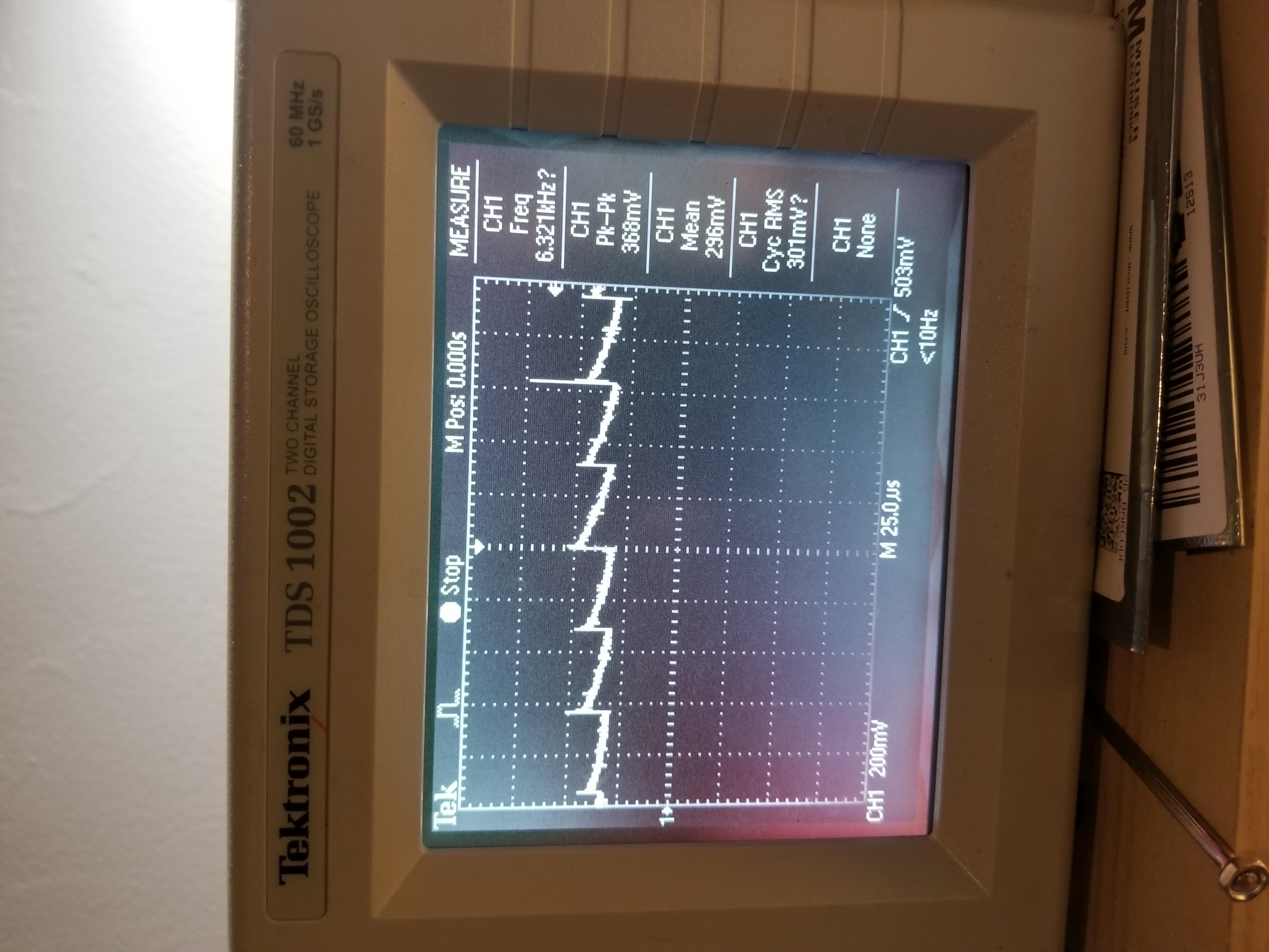

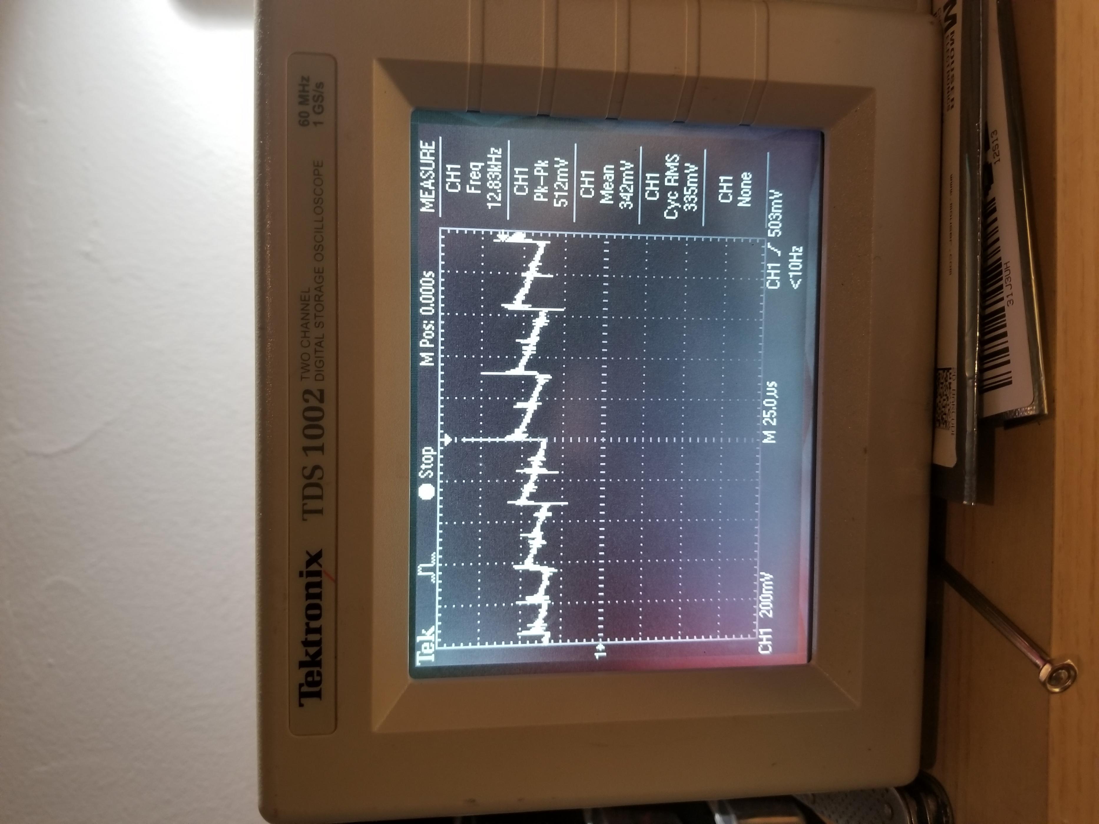

Probe pins 3 & 5 IC11-LM393 with your scope. You should see a fully formed sawtooth.

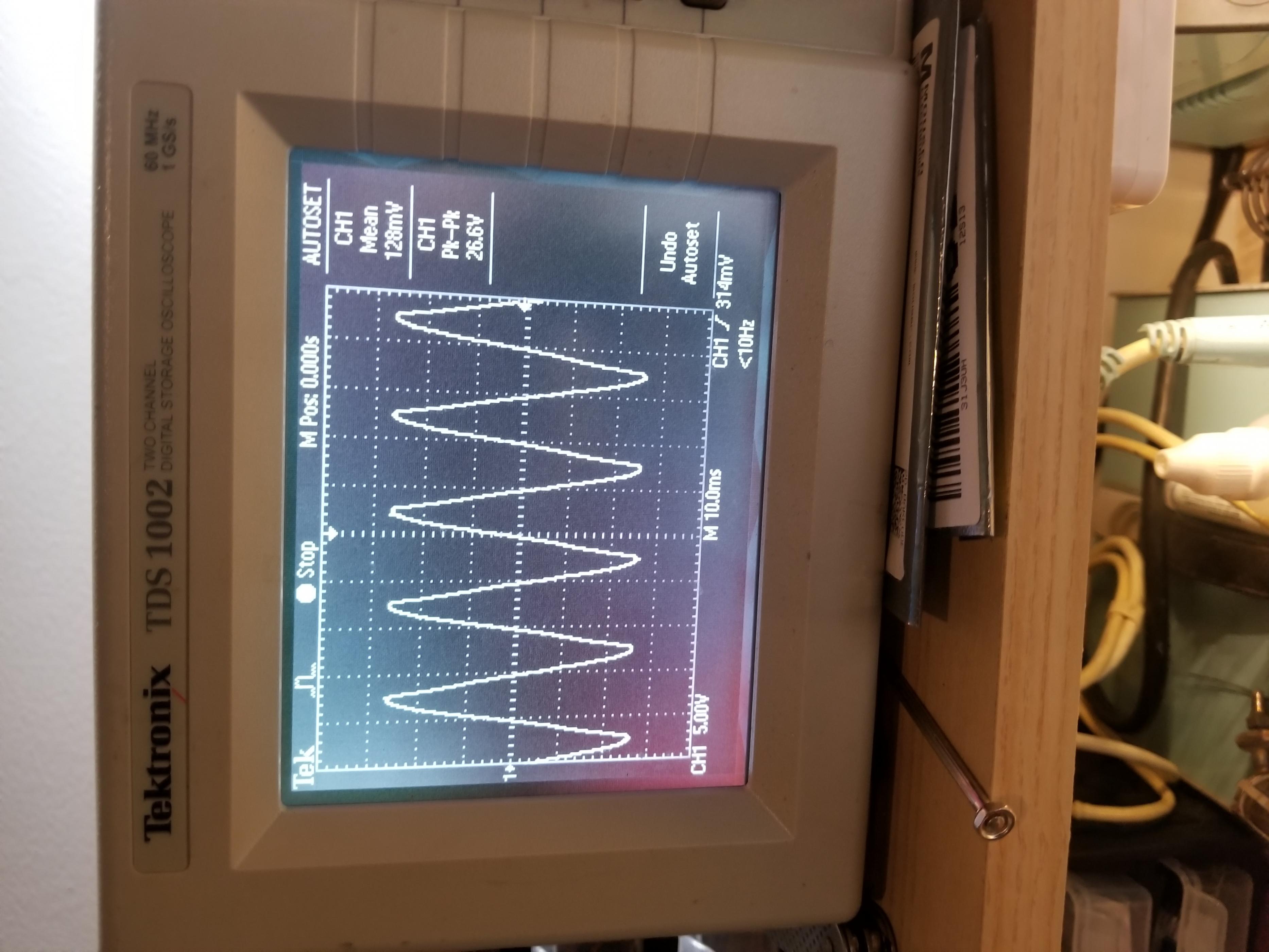

Use a 50hz test tone if possible. Post the screen shot for either waveform.
If you do not see the 50hz test tone at IC10, start at the RCA's and follow the signal through the preamp IC1 through IC6.

This amp doesn't require a sawtooth to oscillate.
Measure the DC voltage from power ground to the cathode of ZD5-12v, ZD4-24v and ZD3-12v.This is a voltage ladder supply for IC9,IC10,IC11.
If any of these zeners show less than expected the problem most likely is a failed 100nf sm capacitor in parallel with the zeners. C61,C62 & C63 are each across two of the zeners and will cause the voltage drop to be significantly low in that parallel bank and shutting down the IC. My guess is IC9 the sawtooth generator has no operating voltage.
