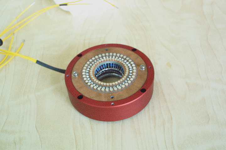

I have used Arek's pot a couple of times now. With friends we designed a preamplifier which uses a pcb layout designed around the Khozmo pot.
In total we bought 26 pots. Two have shown flaws that are no problem to correct simply by adjusting the wiping contacts accessible once you have removed the small pcb with the shunt resistors.
All wipers are fixed with little metric size 1 Allen-screws.
There have been reports about failing Khozmo pots that either started making clicking noises when switched or even went 100% open (these are the two cases I mentioned earlier). The latter is the worst case scenario especially when you have an active preamplifier design with some notable gain capability and some very powerfull monos connected to the preamp...lucky my diamond tweeters are still alive...
If you have problems with clicking, you may want to consider disasembling the pot, clean the contacts and preserve them with Deoxit products. Reassemble the pot by assuring that there is just enough pressure on the wiper not to lose contact but not so much that it groves it's way into the contact tracks.
MBB is achieved by bridging two adjacent contacts by one single wiper contact. With enough pressure it will provide the MBB function.
The mechanical assembly is quite rigid and the axle held in place by a front and a rear ball bearing. On one pot I found that just enough pressure on the axle by pushing from the front was enough to unseat one contact giving 100% of the signal a pass. Here again a quick readjustment of the wiper by increasing the pressure is resolving the issue.
I habe tried these pots with Dale resistors and Mills shunts as well as Z-foil shunts and finally Takman carbon type resistors (still waiting for the metal film version to show up). I have never had any pot to come anywhere close to these pots in regards to sonic performance. Which type of resistors you use is very much a matter of taste but compared to other products on the market they did excel!
Arek is improving his production with all feedback given and I have never had any problems communicating with him. He is a polite and easy fellow to deal with and he offered to replace the defective pots.
I don't see to do any product bashing even when some difficulties arise. Sonically this product is great. Mechanically it may need a caring hand once in a while but thinking of a Harley or a Ferrari...top performance need some maintenance every once in a while.
...and NO! I am not affiliated with Arek! I just meant to give some useful feedback to a great sounding product now that I have had so many of them going through my hands and over my workbench...

Guys, I have a Khozmo stepped attenuator for sale if anyone is interested. It's a 48 step 50K stereo.
So let me know if you want it :D I will ask €50,00 for it. That is a bargain! Shipping not included.
