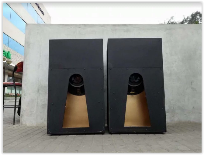

Hi Art,
By Jesperino, Post #1040:
Hi Art,
Perhaps a porno block kept Jesperino's phallic exit shape from "coming" on my computer screen.
IIRC, I did test the variant Jesperino chose, but the Keystone shape I tested and determined to be optimal was based on audio, not visual measurements.
The reduction of fasteners on Jesperino's units compared to the Keystone may be a concern, but the audio results between the phallic variant and the original Keystone Sub exit were minimal, so "whatever turns you on" :sax:
Art
Art
That whole post cracks me up but for some reason I find the sax the funniest!
Plan to try the phallic variant on the B-low? :D

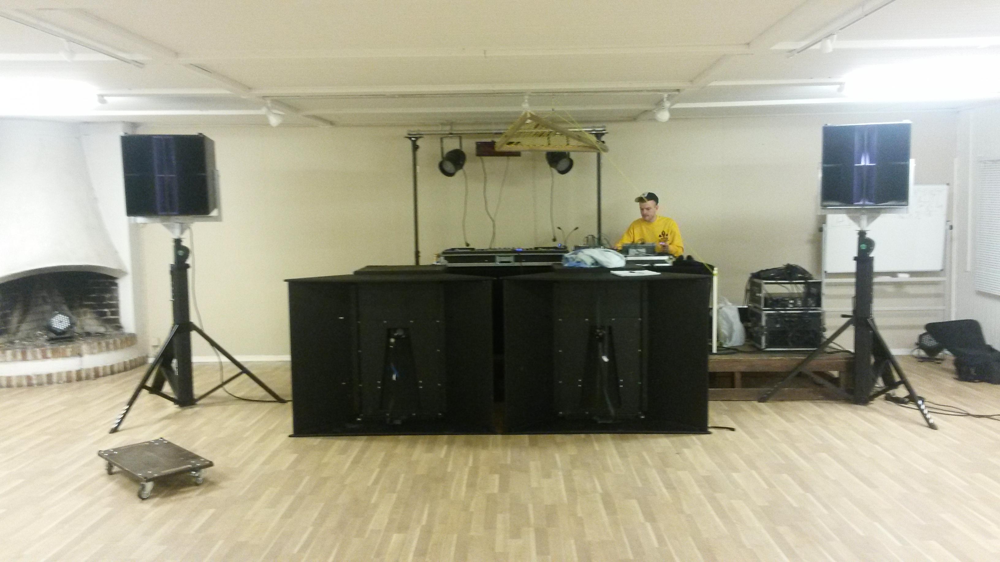

How did it sound with those extensions?
Could you feel/hear a big difference??
Looking good (Y) :)
And what tops are those?
Thanks!
This was the first time I run them with extenders, and as we encountered a bit of electricity problems(we blew what seemed to be a 3x16 amp cee form circuit and had to run the whole soundsystem off a single 10A/230v) I did not dare to run at full throttle so I could not really get a grasp whether and how much they gave. The system however delivered plenty of SPL from a single 10A phase.
The tops are BFM DR280, great cabs!
