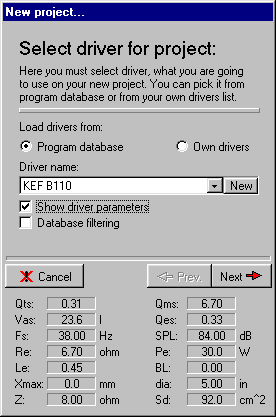

kelticwizard said:Here are the parameters for the B110 taken from the database of WinISD.
That is data for the SP1003.

Be careful with the B110 parameters. All B110's are not created equal. For full identification you need the SP number. The SP1003 is not the same as the SP1057 or 1380.
For example, the SP1003 was a very early unit, with doped bextrene cone and PVC surround, whereas later units used polypropylene and rubber. They all have different T/S parameters.
