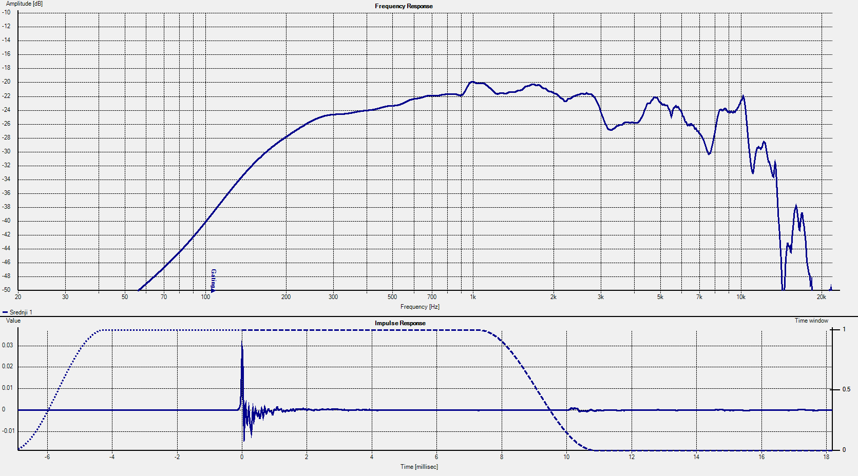

I did some measurements of Kef R300 raw drivers. Rain prevented making full set of measurements but i found quiet enough neighbourhood so yesterday at about 01:00am some sweeps were heard from the parking lot.
https://s15.postimg.cc/5exyq4gu1/image.png
https://s15.postimg.cc/ivux8zyvd/image.png
https://s15.postimg.cc/8lsi9rgpl/image.png
This amount of quasi anechoic resolution makes it much easier to simulate the crossover between woofer and midrange.
https://s15.postimg.cc/y5cvgw7l5/image.png
I've managed to get about 9ms of gate time. I'm quite satisfied with consistency so here are files for simulators.

Measurements are done in factory cabinets, gated, at 1.03m distance mic at tweeter axis - gate is good to 100Hz. Holm-impulse, calibrated ECM8000, M-Audio Fast Track II USB interface, Dell Inspiron notebook.

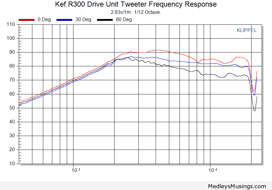

Medley's site can be reached through wayback machine but i don't find it representative because they are colapsed beyond any practical use. He did it with 10dB resolution with grid being about 90dB high. Mine are quite more revealing with 2dB resolution with grid height 40dB or less.
Here are Medleys measurements. Very low resolution in my opinion.
Thanks, I had mistakenly thought you were building DIY speakers rather than fixing the R300 crossover. I agree the Medley Musings measurements have less resolution than one would like. I think I might have been confusing them with the Soundstage measurements which have sufficient detail to see what is diffraction and what is not but, obviously, include the crossover and baffle. Look forward to seeing a full set of measurements.

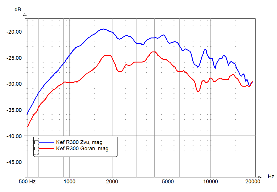

Here are gornir's measurements of the R series coax in test baffle. Looks much better than in the the R300 box. www.audioexcite.com >> KEF SP1632
I beg to differ. I think that Kef did much better job regarding diffraction than Goran with his test baffle, which is kinda expected given that he positioned R300 mid-hi on the center of the baffle. Problem is that low resolution on X axis and low resolution on Y axis (the way Goran showed his measurement) leads to wrong conclusions.
When i see 5dB or (worse) 10dB resolution on Y axis and i see, what i believe is, a problem - it always magnifies when i bring measurement resolution to what Geddes proposed: 2dB resolution with 40dB high Y axis grid.
Look how Goran's measurements look now...

Well I and I suppose may others are more accustomed to looking at scales with 5db grid. In your measurements we can see obvious baffle diffraction ripples at 8kHz and "positive effect" by baffle step around 1-2kHz.

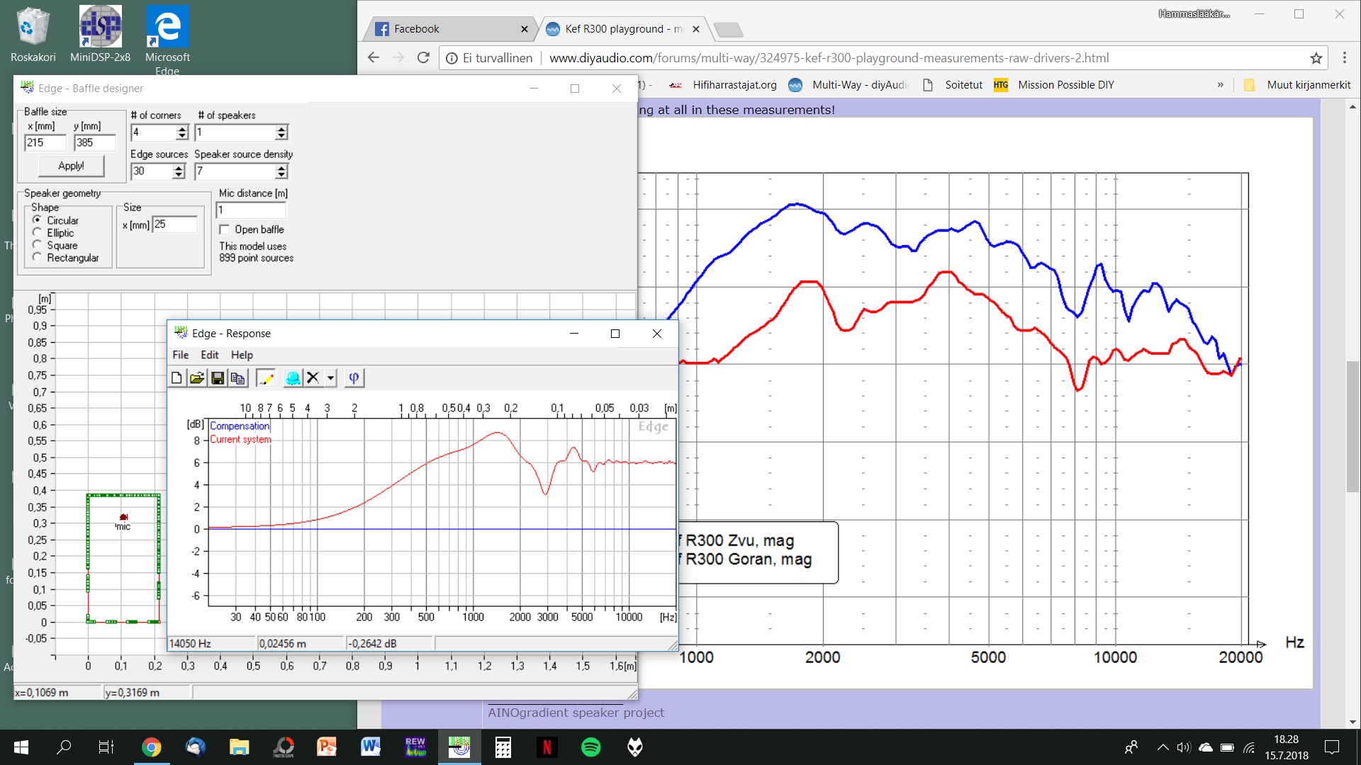

That would be a tiny baffle if the effect shows @ 8kHz.
Imo it is more likely that it is a speaker resonance.
Dip at 8KHz is simptomatic (more or less) for most of the new UniQ drivers and is a product of tangerine phase plug diffraction. LS50 has it, R300/500/700/900 mid-hi has it, even Blade 2 has it but is somewhat masked and milder, which is understandable if we take the price into consideration. It vanishes completely off axis.
But there is vast difference in ripples 7-12kHz, from same driver. If it was just the tangerine plug, they would be identical - so I bet they come mostly from baffle edge interferences/diffractions. A shallow waveguide can't prevent them. All KEFs have quite the same baffle width. LS50 and Blade's baffles are curved which helps.

There isn't a vast difference. Bare in mind that all measurements are done with different mics and equipment and most of the variations in mesurements happen bellow 150Hz and over 15KHz but can be under 15KHz very easy. There is also unit to unit difference due to different production batches. Wavelenght at 8KHz is arround 42mm and has nothing to do with baffle width. Remember how Kimmosto's measurement of the same UniQ were different when he ordered replacement driver for LS50.

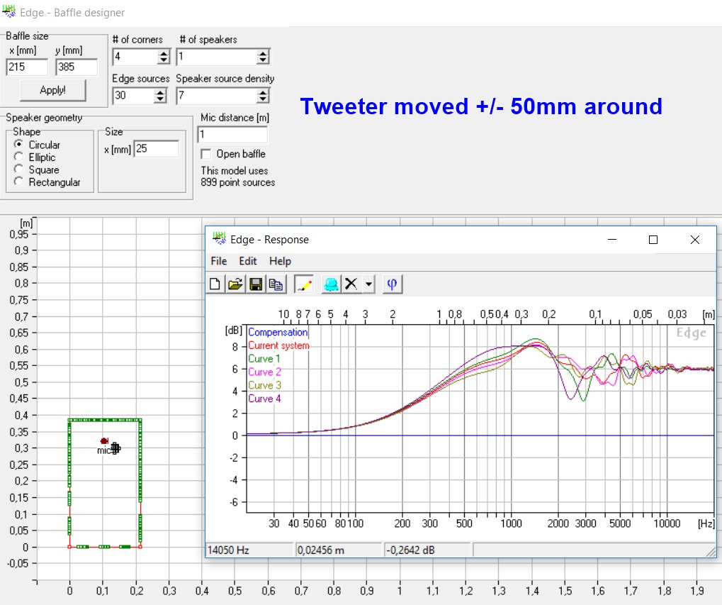

OK, edge difractions happen mostly below 8kHz, in a baffle like R300
This is actually irrelevant here. Crossover is more important and we can change it. Very small margins to tweak diffractions in upper treble...

Of course. That's why i uploaded measurements at arround 45deg off axis. When ever i made sim for R300 crossover that was flat on axis, i got a bump at 2-3KHz off axis. So, little irregularities on axis is quite acceptable if the dips fills up off axis. Since it is a diffraction issue there's no need to try to solve it on axis.
