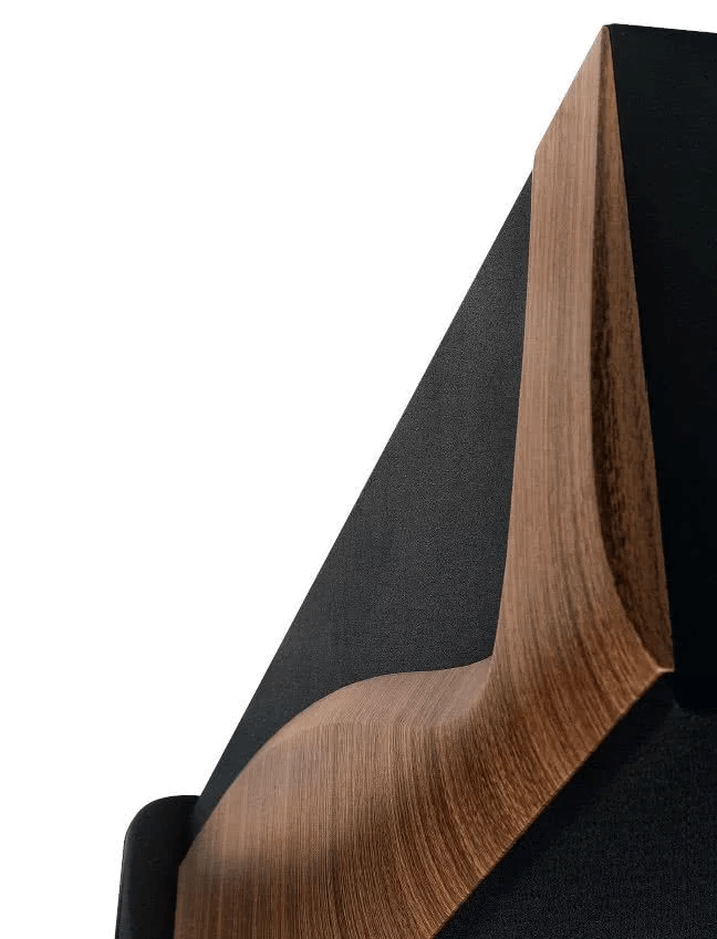

By the way I just read a review of Morel Avyra speakers. Box has nice roundovers, made with CNC... Some kind of wooden laminate or paint finish look fantastic!
https://audio.com.pl/testy/stereo/kolumny-glosnikowe/3890-morel-avyra-633

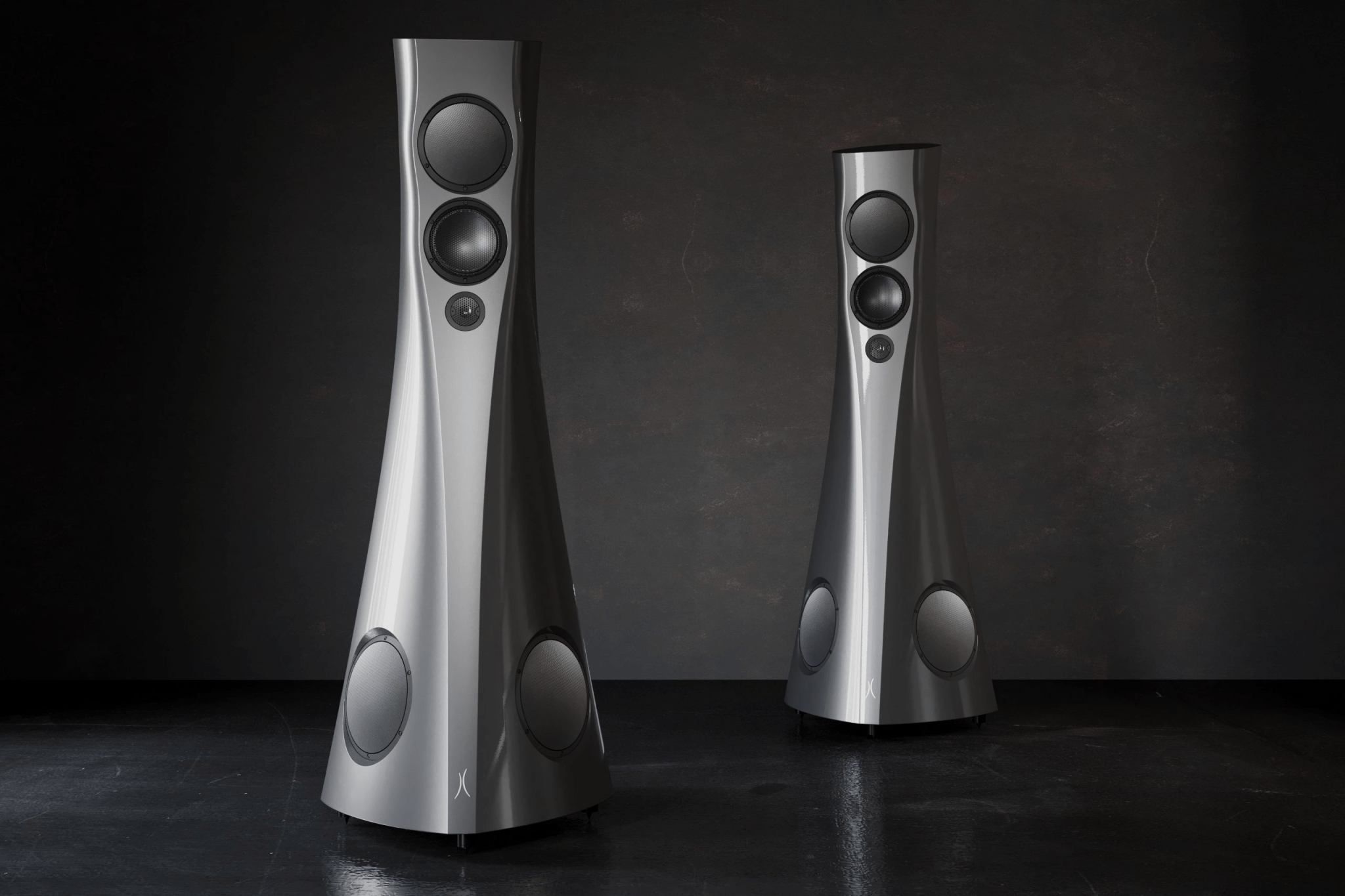

Estonian Estelon speakers look fantastic too!
