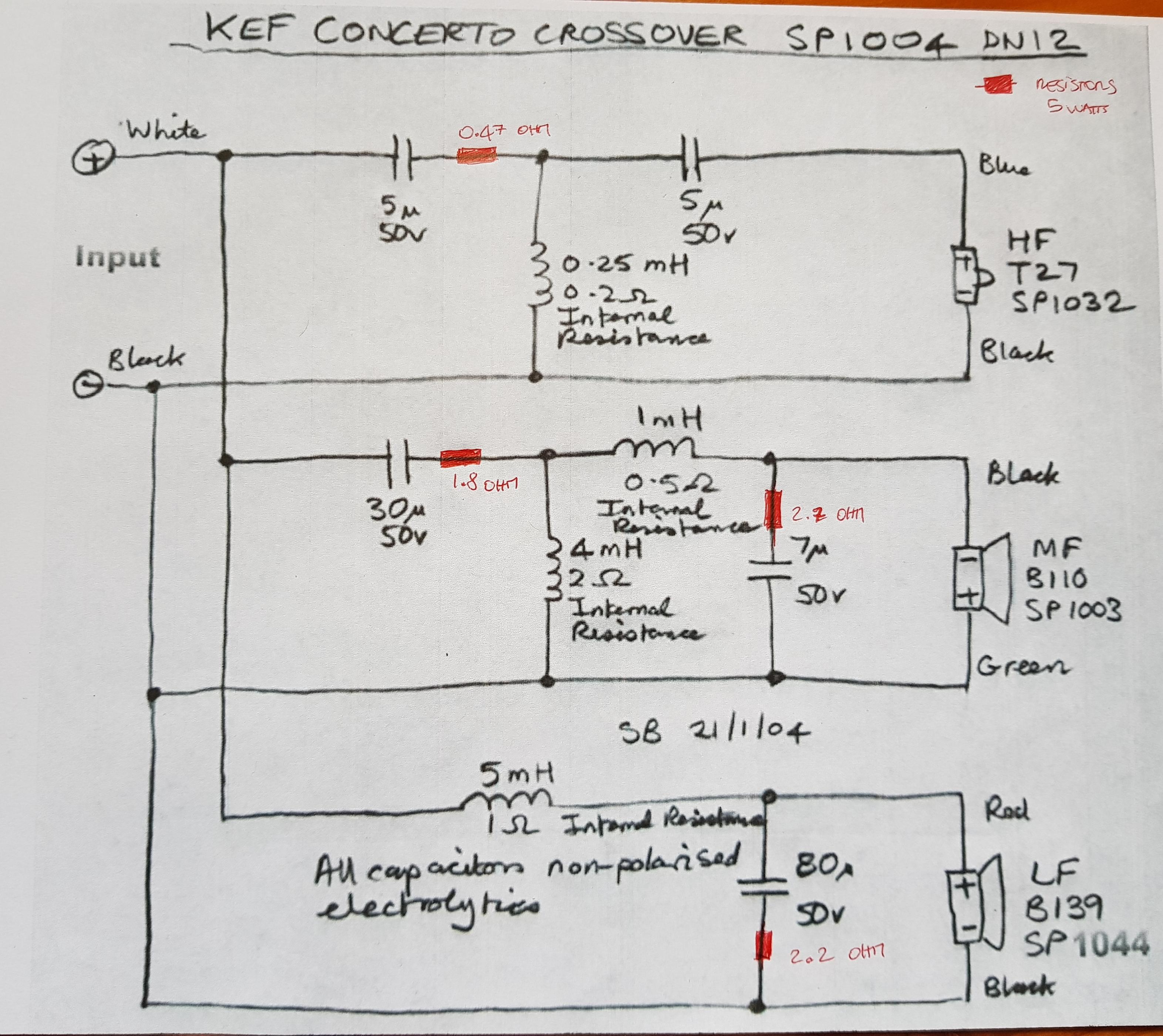

I updated the crossovers on Kef 104'4, Concerto's and on the 101/2 some time ago.
I discussed with Kef ( they were still around then ) the possibility of replacing the electrolytic capacitors in the mid and treble sections with plastic capacitors. Kef replied that the Kef crossover calculations took account of the electrolytic capacitors series resistence and good electrolytics were recomended by Kef as the replacements. If I changed from electrolytic to plastic capacitor then I was advised to add a resistor in series with each changed capacitor. The value being 1 ohm per 10uf of capacitor. I did that and it worked well.
If you do not include the extra resistors I imagine you will change the crossover frequency/profile.
Don

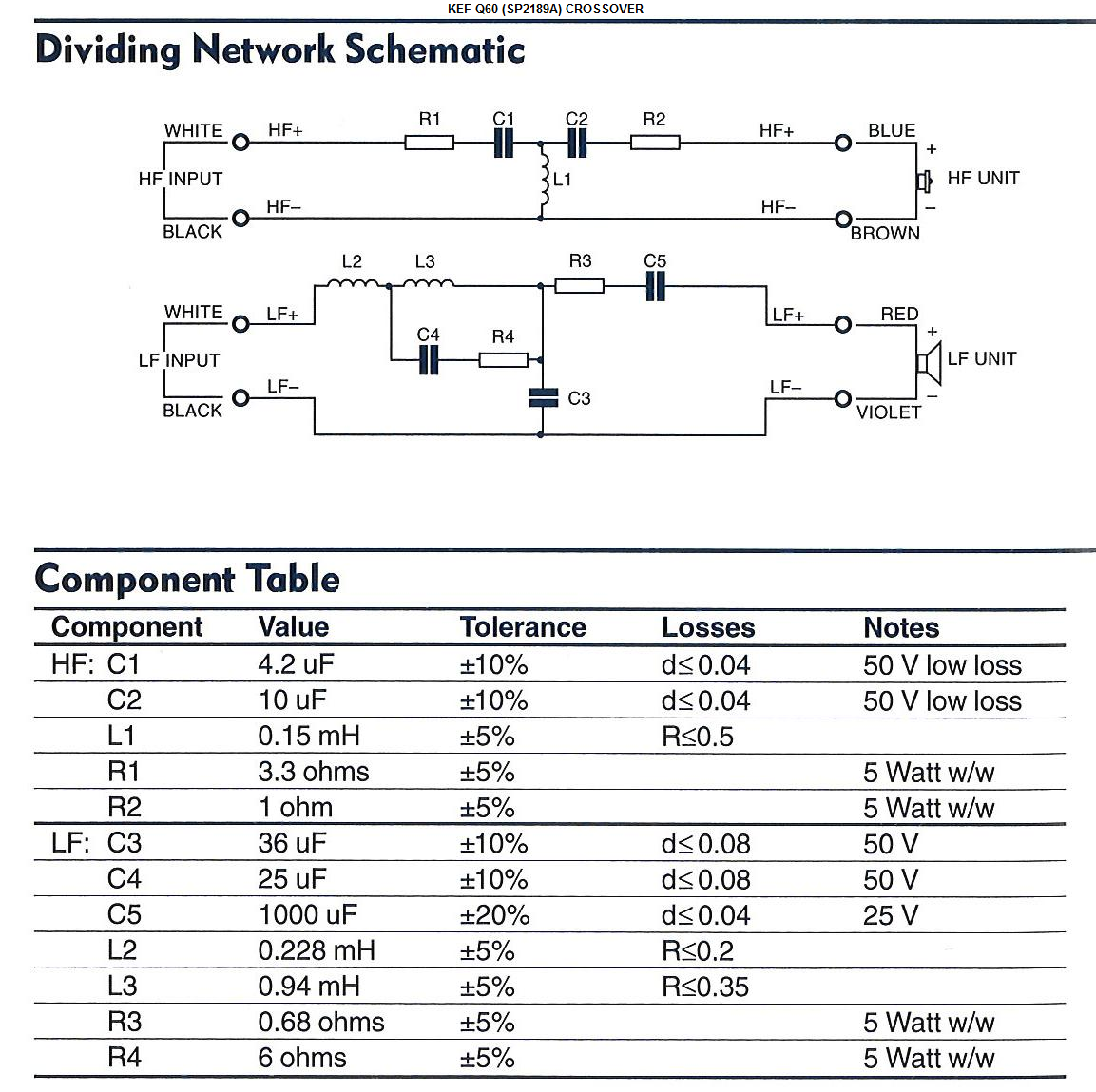

Say I change C1 thru C4 in attached schematic for MKPs.
I just need to change R2 (1 ohm->2 ohms) and R4 (6 ohms ->8 ohms)?
Cheers!
It's very questionable to me whether these capacitor "Upgrades" are even worth bothering with. The 1R per 10uF adjustment looks reasonable for MKP replacing NPE. But it's a lot of cash, and hard to fit the replacements, since MKP is so much bigger. More of a case for buying new 50V NPE types, if you must.

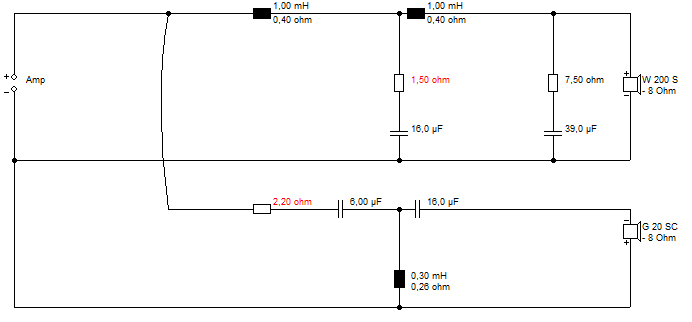

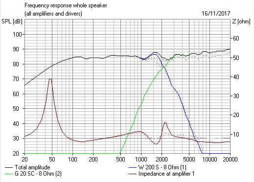

I have been looking at my new/old Wharfdale Shelton XP2.
Usual Elcap NPE types there. I just simmed what would happen if I just replaced with MKP without taking care of NPE ESR resistance changes. The dotted response is with NPE. It all goes horribly wrong!
What does seem to have smoothed things out is turning the bass units 90 degrees and rolling the wadding up and letting it press against the back of the chassis to damp any chassis ringing. It's a good old trick with old bass units, which can sag with age, and rub voicecoil. The sound is very good.
