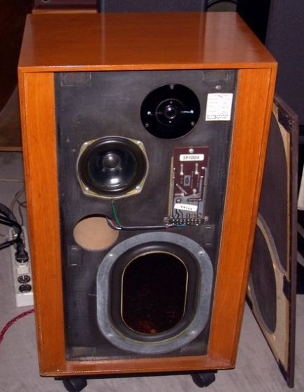

Hi guys
Here are two photos of the old girls. They are on some open-frame stands I got with them. The veneer on both has become very tatty and loose, in fact I got a nasty splinter from the one the other day, so this is also part of the motivation to build new cabs. I did a quick calc, and I'd be able to put the Leaks in sealed cabs of about 75l - 80l. Maybe more if I extend the depth a bit. What do you think?

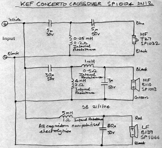

Hi there
Can anyone explain why, in the crossover schematic in Post 4, the B110 midrange is wired in inverse phase to the woofer and tweeter?
Ok, so since no-one seems to want to answer this one, I'll take a stab at it. Just note that I am not technical. As far as I understand it, it is due to the fact that the 2nd order crossover reverses phase at the crossover point. Therefore the phase of the mid is reversed to compensate. Others may have a better explanation.

Hi guys
Deon
Those Concertos are nice speakers.
Falcon Acoustics do a £35 replacement crossover (No. 5aB) which is claimed to make a significant improvement to them.
Alternatively Dr. Bailey published a DIY transmission line design for them in Wirelesss World in May 1972 which is supposed to sound fantastic.
