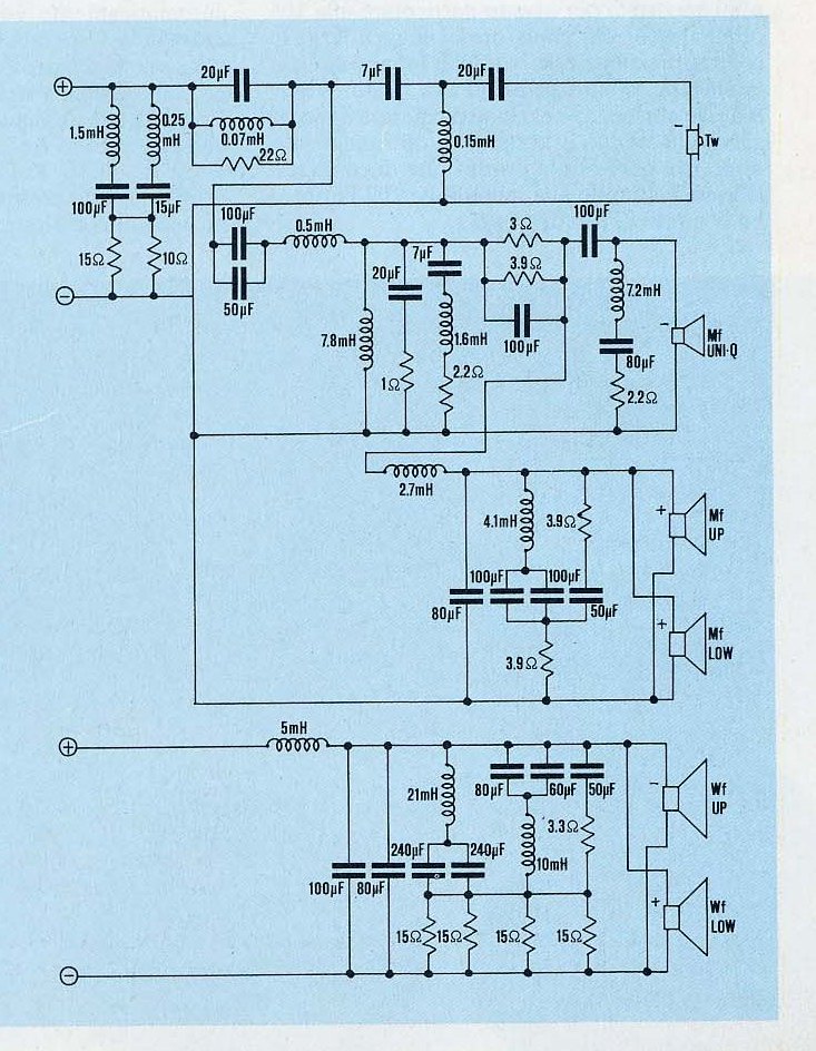

sbx,
as there are so many capacitors, and a lot are high capacitance values, it is going to be expensive to replace them all with new high quality,
long life capacitors.
I you are able to Post the Schematic of the crossover, I will advise you which ones are the most critical to spend money on,
and which ones will be OK to replace with lower price caps.
Either the KEF printed schematic, or your own hand-drawn, will be OK,
but do show which cap values are where, and show all inductors' and resistors' positions, and the connection points for the drivers.
Toolman,
I'll comment more on yours after we see what sbx can Post here,
though you can look in the other 105/3 at its crossover to see what is printed on the equivalent position cap there
-the one which corresponds to the burnt cap in the missing highs' 105/3 - and Post that information here.
The melted cap has likely gone Open-Circuit and is no longer passing signal.

Alan, and Inductor, thank you for the information. I have done a bit of testing and determined that the tweeter isn't working. (applied signal directly and no output). I then applied signal to the HF board and there is output. The cpa may not be toast but I will replace it any way as it has been exposed to excessive heat anyway. I include a photo of the board in question.
Toolman, when using components (new) for repairs, always make it with a new matching pair and repair the other speaker too for a perfect match in sound output. Unless it's the same exact component/tolerance. (As someone said before, there are exceptions, like a pair of speakers fine-tunned different from each other to achieve for the same result/sound footprint).
KEF 105/3 crossover
Inductor, good point ref the balance of new components. I note as well that the schematic you directed me to shows the capacitor in question to be 15 mfd, the one on my board (and confirmed on the other cabinet) is a 16 mfd.
As I have eliminated the board as the source of no output I now have to figure out how to separate the tweeter from the woofer without causing further damage. There is a nut in the top but when I turn it so too does the whole tweeter. Any thoughts.

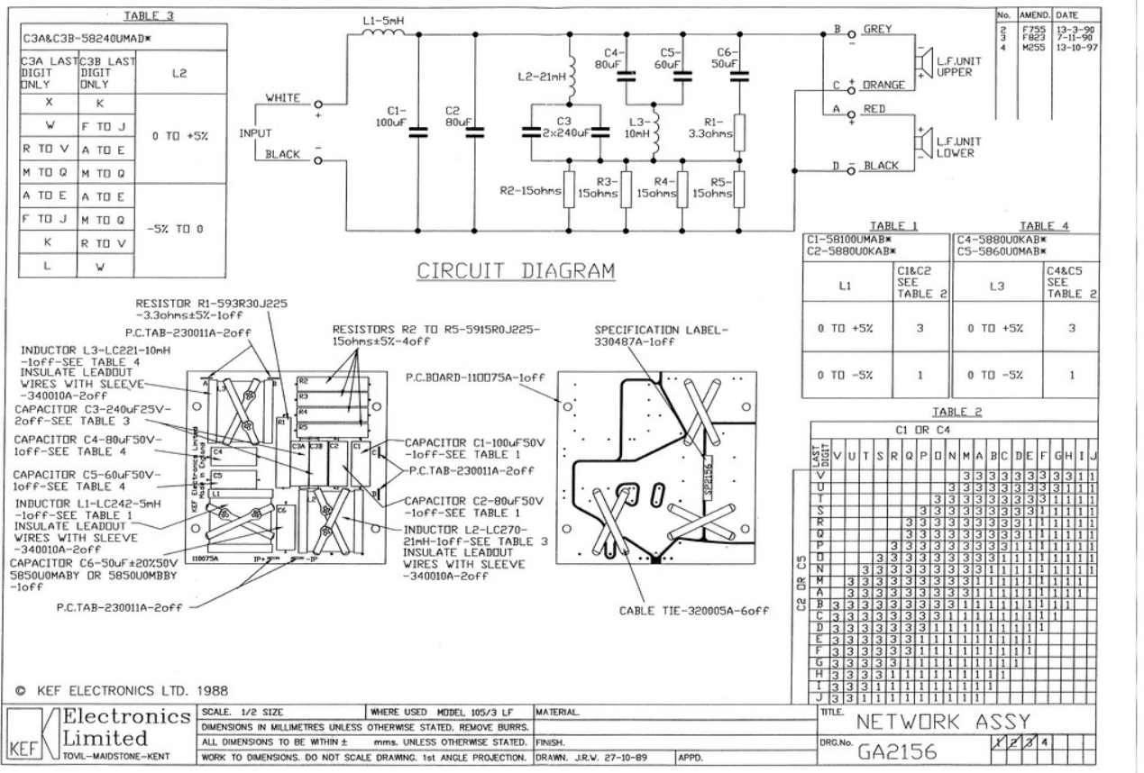

Not to rain on anyones parade but be aware that KEF Reference Series models achieved high matching within a pair by "customizing" each crossover to the drivers used.
I worked as an engineer in the Maidstone factory in the early 80's. The practice was to buy fairly wide tolerance capacitors, sort them into a number of tight groups and then match up each group with slightly different value inductors. That means that any crossover schematic is likely to be slightly at odds with the values you see on your circuit board, and the values on the capacitors may be the nominal value while the exact value was chosen to be off nominal!
It might be a good time to leave well enough alone, unless you had a good reason to believe that capacitors had degraded. I think the best advice would be to unsolder one end of each cap and measure its value. If it has a value within the printed tolerance on the cap then you are better off leaving it alone rather than replacing with an exact nominal capacitor. New close tolerance capacitors will actually degrade the pair matching.
David
David
Hi David, cheers for the info, I had read something similar somewhere else but was not too sure until now, its good to hear info like this from someone who has actually worked with this kit. I am happy with the way my pair perform but was just exploring the possibilities if I decided to refurb the cabinets. I have purchased a pair of the 4th generation Uni Q from Kef as an advised upgrade, I thought they might be getting scarce but when I ordered them I was informed there were still over a 100 in stock , I haven't fitted them yet. Will new tweeters have any bearing on the matching? Saying that,mine have very slightly different serial numbers on the back so I don't know if they were a true matched pair, there are two very old black labels on top of the white label stating 18697a and 18897b which could have been a mis print or some else has tried to make them look like a matched pair. I would find it strange if they weren't because where would one cabinet come from?
Anyway thanks for your input
All the best
The pair matching and crossover adjustment only pertained to the Reference Series systems. They would build drivers in batches of 96 units and let the computer sort through and find the best 48 pairs. Then 48 woofer pairs would be linked up to 48 tweeter pairs, based on sensitivity, etc. Crossover capacitors would be balalnced against inductors as I described before.
If you blew a tweeter then they could send you a second one matched to its mate, by pulling up the record of the one you still had and sorting it through a batch again. I think after a couple of years they found the process too tedious though and started sending out middle-of-the-batch universal replacement tweeters.
Replacing tweeters with new ones will effect exact pair matching, but really, when a product is over 20 years old, its just nice if it plays!

Hello, I just wanted to link to another copy of the kef 105/3 crossover schematics, just in case the one linked before disappears. Also there is the official KEF schematics for the woofer. Unfortunately, I haven't found one for the medium treble.
Le topic des amateurs de pure hi-fi - Page : 1162 - HiFi & Home Cinema - Video & Son - FORUM HardWare.fr
And here are the characteristics of the woofers and the official xover schematics.
Still looking for the same for the other drivers. Will keep you posted.
