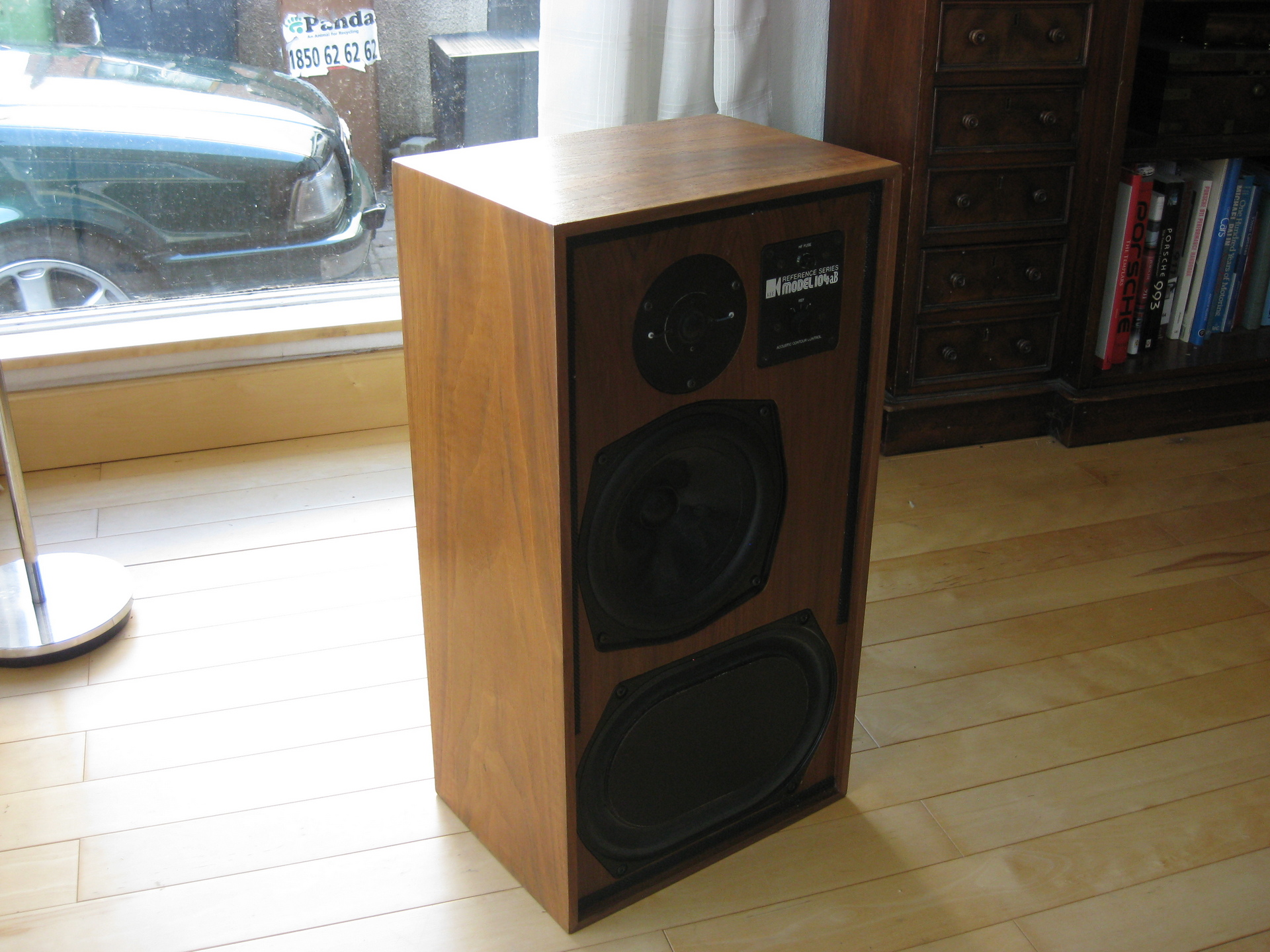

Bit of a thread revival here as Deano replied to a post from 2016...
Have used my 104ab's daily for about six years now, great speakers. Little known secret is they make a fantastic near field setup in small rooms.
Was perfectly happy with them until recently when i stumbled upon a pair of 104/2's a price i couldn't refuse. That's my next project to restore those and move into the 1980s :)

Thanks for the reply, I don’t know why I considered rebuilding without the PR’s.. Maybe to get smaller boxes ?? Never got round to really rebuild a set.
Anyway, I still use the 104 aB’s in the studio, now with a Yamaha s501, sounds great!
