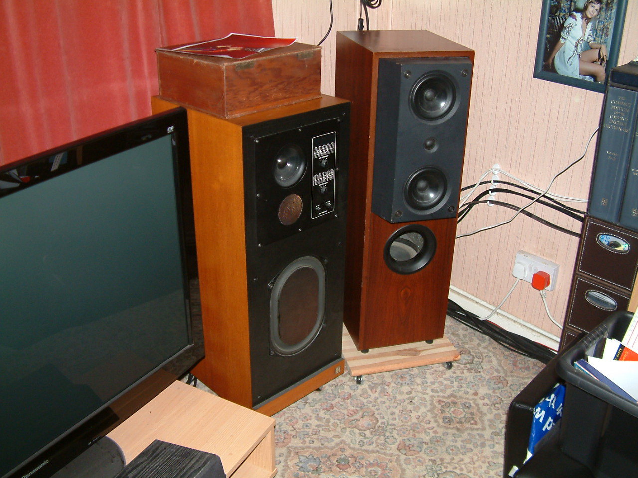

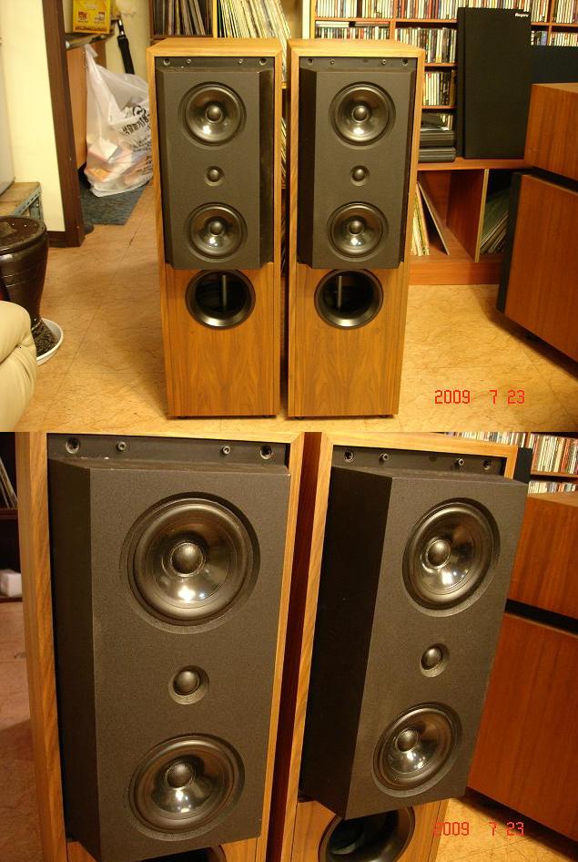

Hi mlloyd

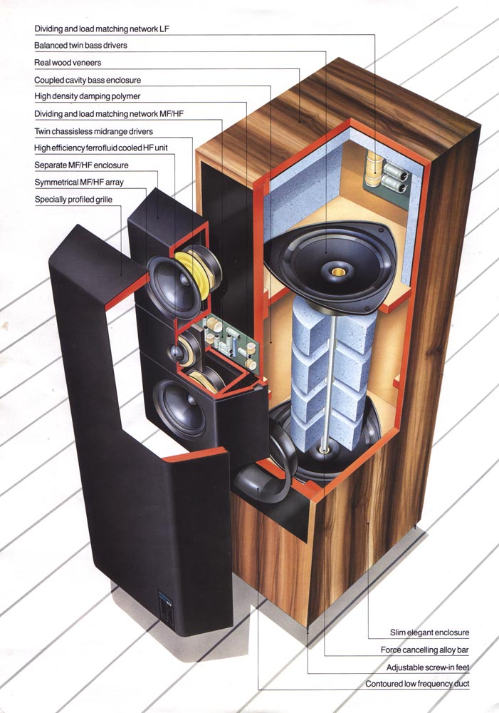

Oh, woe! As I look at at my 104/2 KEFs I see something different to above descriptions. Maybe they refer to 104/AB from earlier times?
104/2 dates from 1985 and has B250 bass drivers coupled as you describe but has D' Appolito arranged custom 150mm rubber mount mids and 30mm tweeter. Sadly, these are constructed as part of a bolt-on assembly and no separate drivers exist (in my version and a later one I am aware of) with what appeared to be bi-amp connections .
I'd be interested to know if KEF did revert to component construction.
I was thinking of this unit (see pic) which is a 104/2 rather than 104 or 104aB. These have the mids built into the cabinet module. Surrounds are glued to the wooden baffle. Magnet structure is bolted to the back of the cabinet and there is only enough chassis to mount the inner suspension. (It seemed like a good idea at the time.)

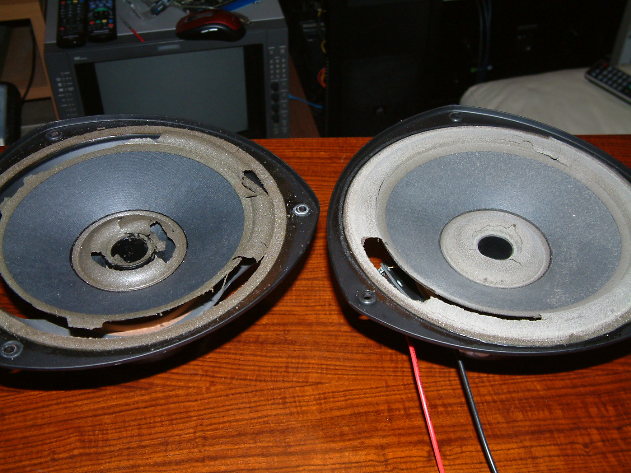

KEF 104.2 bass driver replacements
The Monacor SPH-210 is often recommended as replacement for both the earlier (SP1188 with rubber surround) and later (SP1256 foam surround). However, they are not 'triangular' mounting (they have four mounting holes) and the force cancelling rod can't be used.
I successfully re-foamed my SP1256s'. They tested well on the bench but disaster struck when fitting the lower unit: The magnet slipped (became un-glued) when tightening the cancelling rod. 'AudioLoudspeakers' in the UK are rebuilding the unit for me.
AudioLoudspeakers
The system was being driven hard when the LH speaker failed (the worse of the two drivers is shown on the left in the photo) Much to my surprise, both units of the RH channel are still absolutely intact.
AudioLoudspeakers

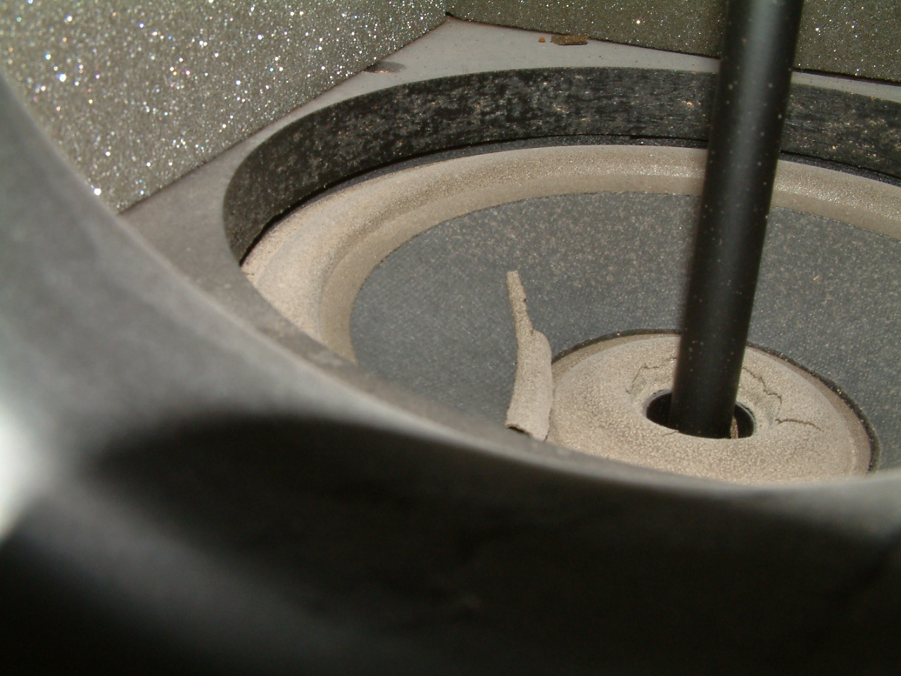

Is the inner suround really usefull for the sound result (more bass as i readed on an EBay shop above where they refoam) or is just a protection against the dust around the rod for the voice coil ?
I have the outside rubber version wwith a standalone amp input (screws)... never succeed to see and acess to the upper mid ! Passive filter hidden somewhere Inside th main cabinet !
Hi, the inner cap is just a dust seal for the voice coil. It's loss won't affect the sound unless dust (or foam debris) has entered the critical gap between the coil former and magnet assy. The coaxial design is to accommodate the the force cancelling rod.

I removed carrefully the inner foam surround as it was really near to dust ! Outer rubber surrounds are in very good condition (as the little mids ones !). Great speaker, never have the luck to find a cheap 107 ref on the second hand market !
