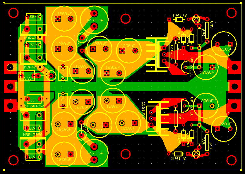

I have designed a K-Multiplier PCB in ExpressPCB to be used as my Marantz SA11S1 pre-regulator. The board includes transformer secondary snubber, rectifier diodes, diode snubber, a CLRC filter and the K-Multiplier. It is designed for handling 300mA constant current with 1.4V voltage drop only. It can tolerate at least around 7,000uF (tested) at it output without damage by the inrush current. With a single 1200uF at its output, combined with the heavy duty CLRC filter, it is simulated to have ripple rejection of -61dB at 20Hz, -74dB at 100Hz (mains rectified frequency), -156dB at 10kHz, -174dB at 100kHz, and -143dB at 1MHz. So noise above 1kHz is basically non-existent. My simulation included parasitics.

The board size is about L94mm x W66mm. It is a low profile design so that it can comfortable fit in a CD player. Capacitors are expected to be all Panasonic FR 25V 1200uF. See the attached image. The design featured a 2 layer PCB with small power and ground zones / planes to reduce inductance. Note that the current loop is made very small after the bridge rectifier.

I like the grounding layout with the strings of stars from noisy to quiet.
I also like the overlay of power planes over grounding planes.
BUT !!!!
there is a mistake. I see the resistor passing across a gap in the ground. Where is the return route? It should be directly under the resistor. Maybe just delete the resistor and connect the ground plane between the two nearest caps.
Similarly rotate the two power transistors so that they stay very close to the grounding link.
Thanks, Andrew.
The resistor is the R=0.22R within the CLRC. It is there to provide damping so that there is no peaking in the CLC circuit. 0.22R is chosen after extensive modelling, as we want the smallest resistance without peaking so that the voltage drop is minimized.
The ground planes are surrounding the 2 Cs. The R is in between. It is mounted vertically to save space therefore its corresponding "ground area" is very small. To do it correctly, this resistor must be moved to the middle ground line. But this is not practical and can cause other problems and definitely require more space. Note that the "entrance" to the C and the "exit" from the C forms a "line", so that current can be shared between all 3 Cs. In this way, the inductor and the resistor must be positioned where they are currently positioned.
So unfortunately, somewhere somehow we must make some compromises.
I extended the ground area to cover the area of the emitter of the transistors. I have not covered the collector output copper area which would have further reduced the output inductance. If I did so, the voltage reference of the KM would have higher capacitance. So it is all about compromises.
At the end of the day, this is supposed to be a pre-regulator. It has achieved very outstanding line rejection up to some -174dB at 100kHz so a little bit noise in the impecfect PCB layout is not a big deal. There is the next stage regulator which will provide further noise reduction, and finally, there is the actually circuit that provides PSRR. The most import consideration is to keep the current loop after the rectification short, and this has been achieved very well.
The purpose of the CLRC and KM is to reduce higher frequency ripples to basically nothing. This makes the next stage regulation much easier and much more stable with far less chance of oscillation.

I understand compromises.
I also understand Ott's "rule":
Never have a component current or trace current passing over/across a split in a plane. That split forces the return current to find an alternative route that MUST have a HIGHER impedance.
You are right. But in this particular case that higher impedance route is the extra 17mm track of more than 5mm width. Putting it into a calculator shows Z=0.00022R + j 0.048025R at 10MHz and Z=0.00279R + j 3.44235R at 100MHz. The wires between boards will completely swamp this.

Good suggestion. This may be a product I may use next time.
I rarely thought of noise at such a high frequency because a 20cm wire would have 143R at 100MHz. It is necessary for small device such as mobile phones. But then these days I can never know as I can't rely on my cheap 100MHz digital oscillioscope to tell me anything at this frequency, and all the wireless networks may create a lot of noise. Fortunately I don't live near a transimitter.
That 47uH inductor on the PCB is for the one made by Wurth (7447471470). It has a fres=9MHz and is shielded. 9MHz is pretty good for 47uH.
