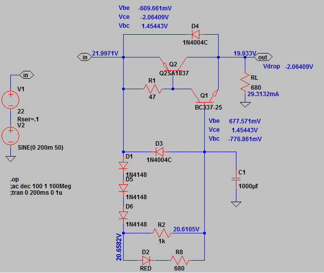

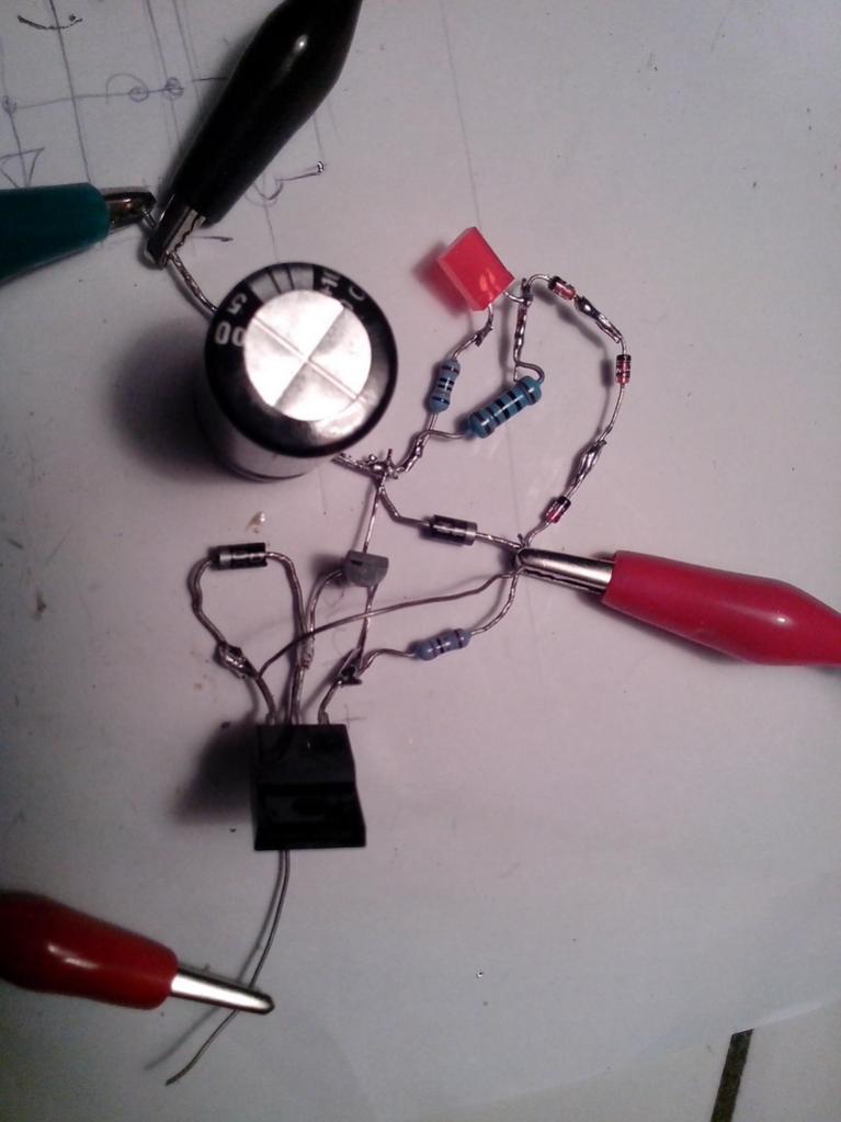

Okay... Getting there. Vbc(Q2) is lower than the total voltage drop which must mean there is another broken joint? What is the voltage across R1? Vbe of 1.15V for Q1 means it is probably dead... But I don't know why that would happen. Q1's pinout is CBE looking at the flat side.
The layout appears to be correct based on my guesses of where the pins are.

do you mean Vce(Q2)?, i try to simulate with ltspice and Vbc(Q2) is less than Vdrop
Vce(Q2) = Vdrop
something wrong with my part,
here my real measurement
Q2
Vbe -0.62mv
Vce -2.4 v
Vbc 1.43 v
Q1
Vbe 1.15v (???)
Vce 1.46v
Vbc -0.7v

Yes, I meant Vce.
Okay... Vbe-Vbc=Vce. For some reason this doesn't hold up in your measurements. In any case a Vbe of 1.15V means Q1 is fried; replace it, or test it for Hfe in case it really isn't bad, of which there is a remote chance.

That all looks right, except your input-output DC gives 1.4V whereas Vce(Q2) is -1.8V... And output AC is still way too high. And how did Q1 get fried!?
I'm sorry this is taking so long. How long do you wait after turning it on to measure it?
Measure again with 1k resistors in series with each probe, and the probe wires twisted. If this doesn't make the measurements consistent, then I think your meter must be flaky.

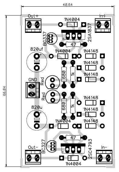

Actually, found this in another thread. Is this the one you're using?

q1 dead when i try to add elco paralleled to R load and i forget to power off. i measured rigth after turn it on and wait 3-5 minutes.
In that case Q2 may be damaged as well, so you may want to check. The rugged BC3x7 has a surge SOA of 1A, and drawing over 1A through the base of Q2 could be an issue...

replacing Q2, twisting wire and adding 1k resistor on each probe
here my measurment
DC in 23.01v
DC out 21,3v
AC in 0.170v
AC out 0.126v
Q2 (change to SA1943)
Vbc 1.29v
Vbe -0.569v
Vce -1.87v
Q1
Vbc -0.73v
Vbe 0.476v
Vce -1.38v
I think my meter was flaky when measuring small AC signal.

A flaky meter is totally unacceptable. I would get a new one. The measurements are a bit more consistent this time.
