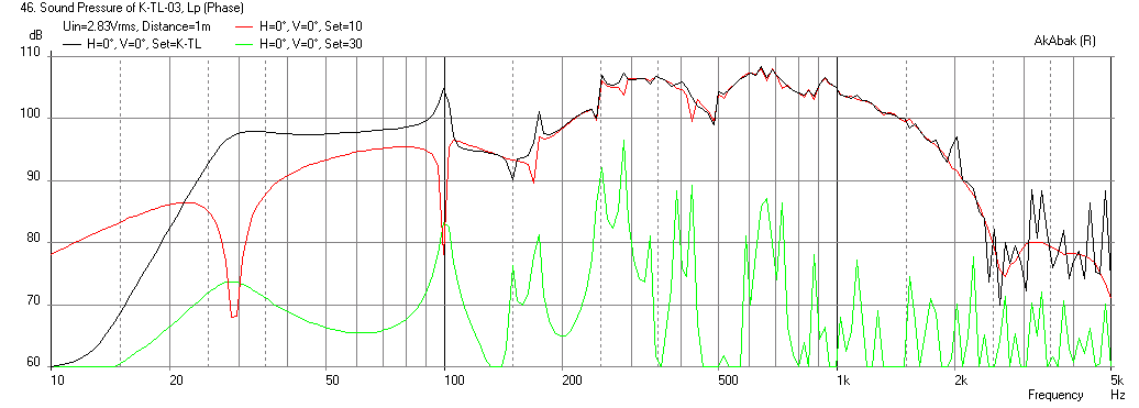

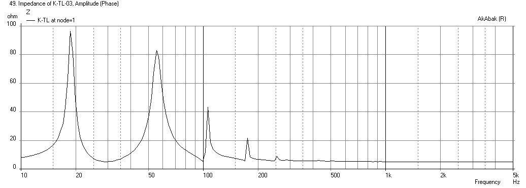

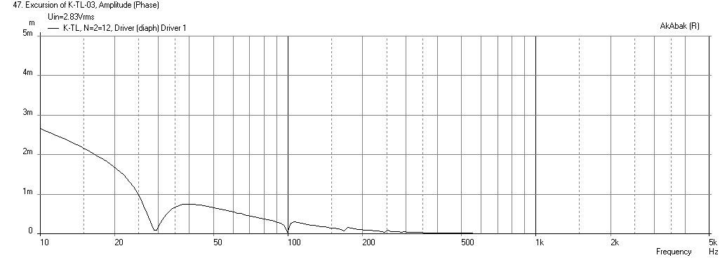

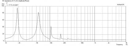

1.5X Scale Karlsonator with a pro audio 15 inch coax
I ran a sim with a pro-style B&C 15HCX76 15 in coax PA driver (98dB Efficiency) for fun and scaled the K'nator simply by 18/12 with a vent scaling of 1.35X and it worked like a charm with a flat bass shelf around 98 dB at 1 w 1 m down to 30 Hz (before any falloff). I think this is a 13.5 cubic ft box though. If you want a smaller box, maybe a 10 or 12 in driver would be better?
There is a price for performance both from volume of the box and cash. In this case, the B&C coax will set you back $550 ea. My sims with the Betsy K 8 in yielded some very nice bass in a relatively small box. It almost went to 30 Hz and costs a lot less. But you won't get 98 dB.

15:12 is 1.25x, so like it or not volume goes up 1.25^3, or about double. Depending on the specs, something in the 8 cu ft range might work OK, but of course you'll give up something.
Regarding a hypothetical Karlsonator 15 vs a K15, mostly you'd get more bass extension and hopefully a little smoother midbass FR.

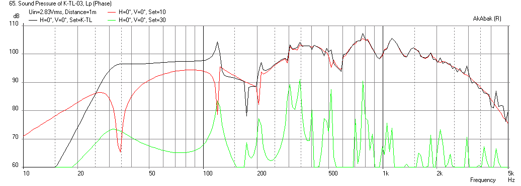

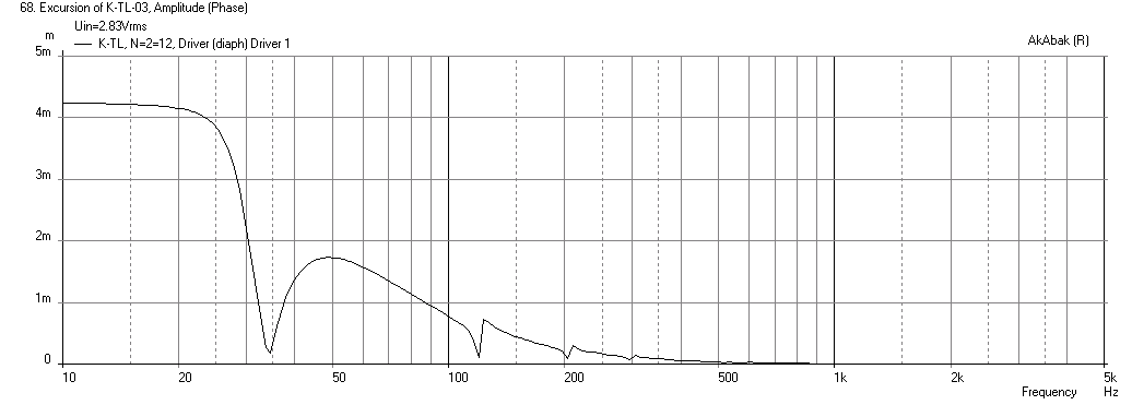

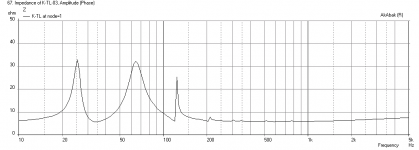

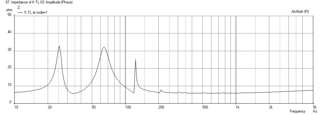

Betsy K in 1.25X Scale Karlsonator
Larry,
Here is the sim of the Betsy K in a 1.25X scale Karlsonator with the vent scaled up by additional 1.2X. You can get some pretty impressive bass down to 30 Hz from a cabinet that is about 37 in tall.
that's really low bass from BetsyK! X - do you think there's any point to making a sub-only Karksonator with perhaps a 12" which can move some air vs other enclosures? my TSG coax for "fullrange" has a healthy 4.6mm one way excursion and 4" coil for regular duty. Perhaps the best value for a wide range Karlsonator would be Eminence's Beta 10cx with ASD1001 compression driver.
