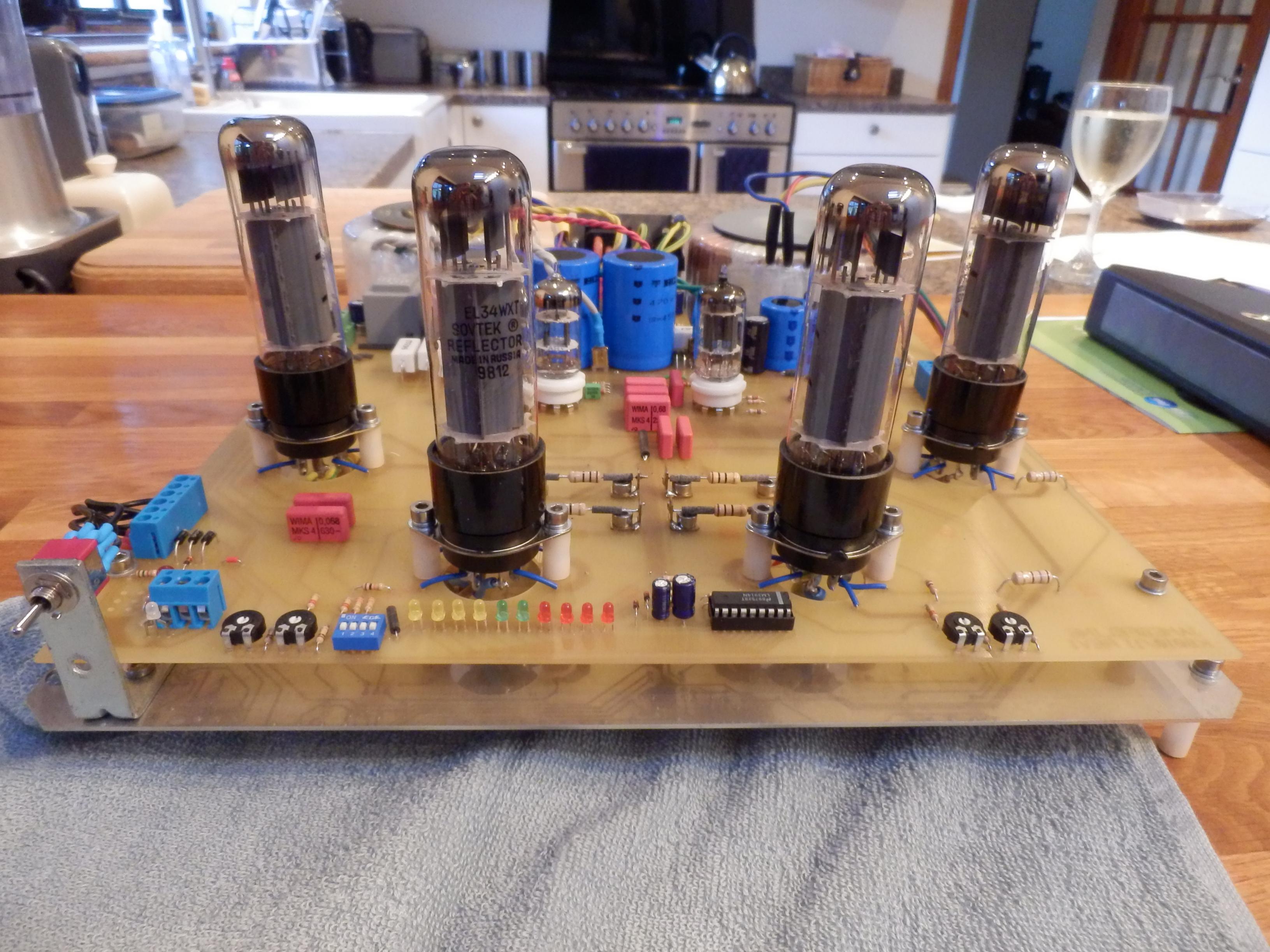

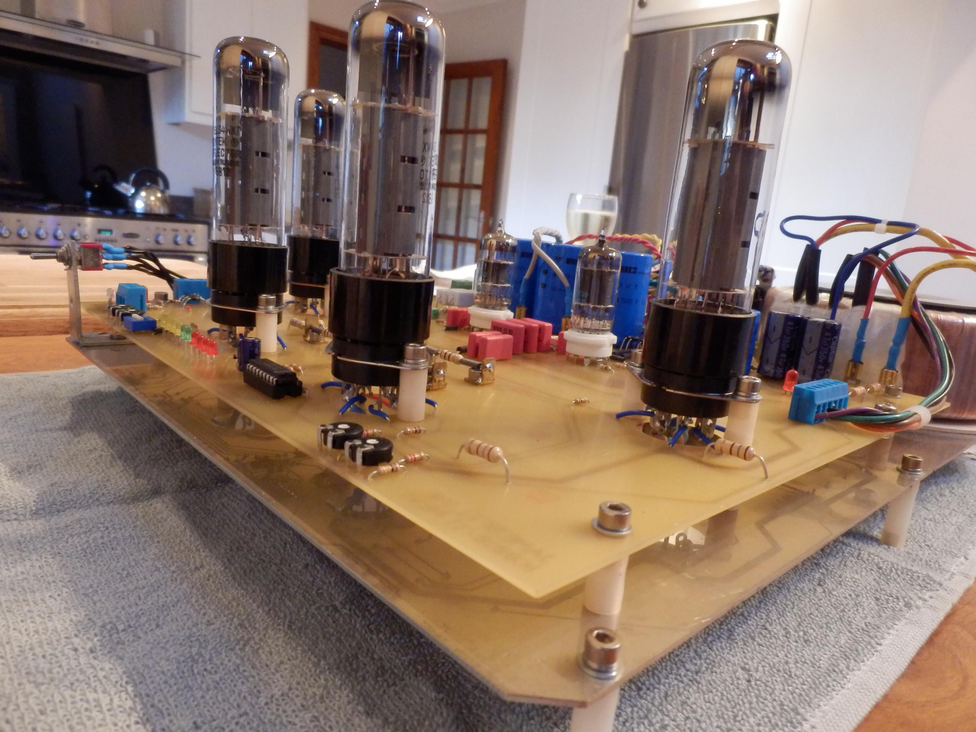

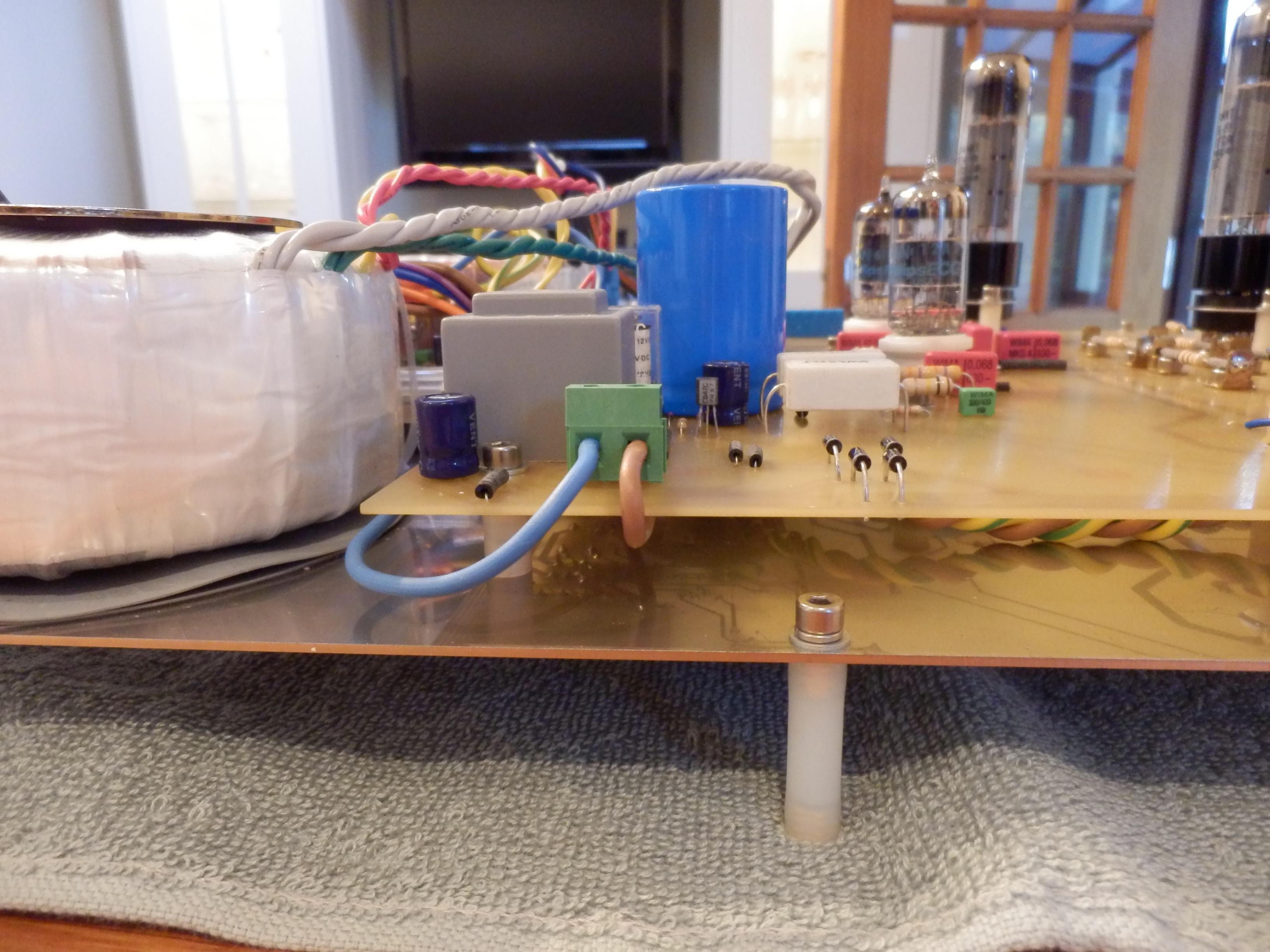

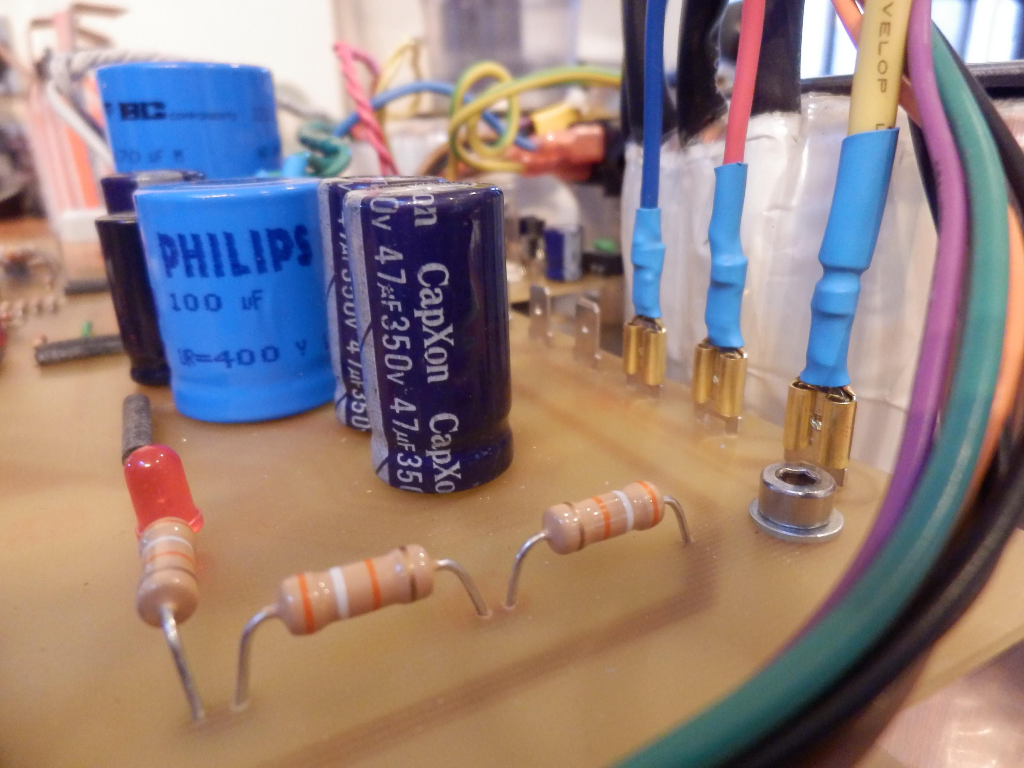

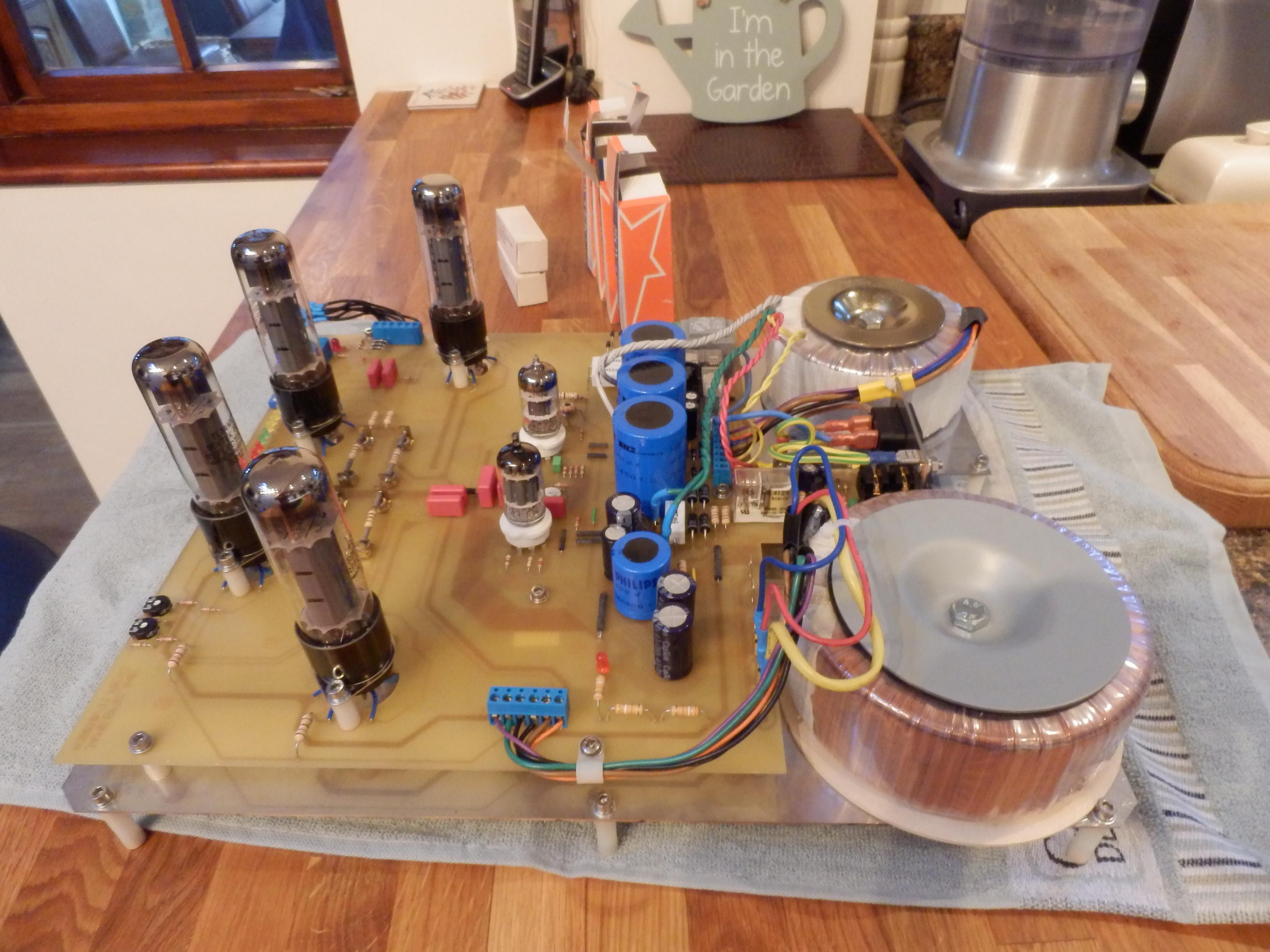

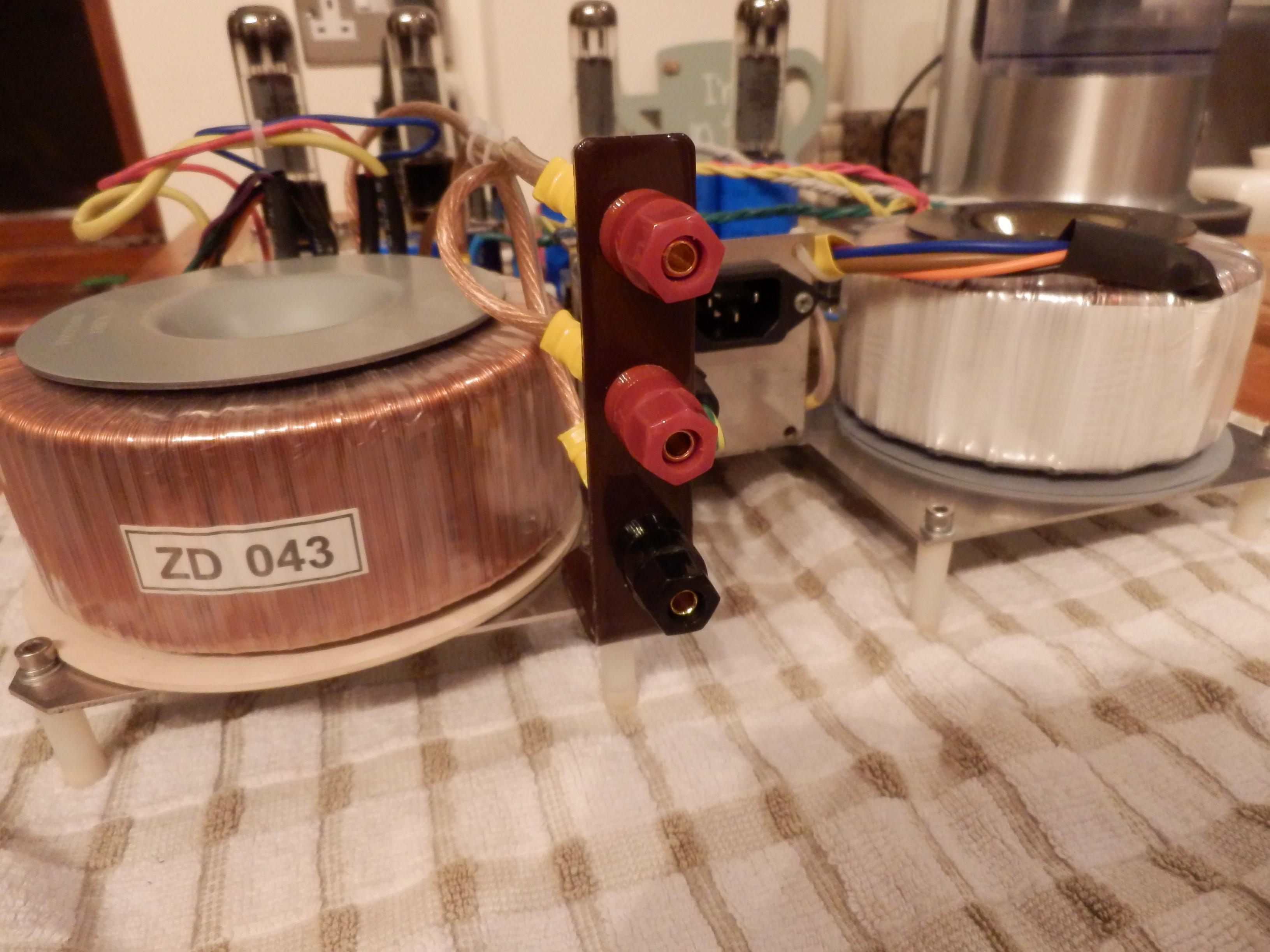

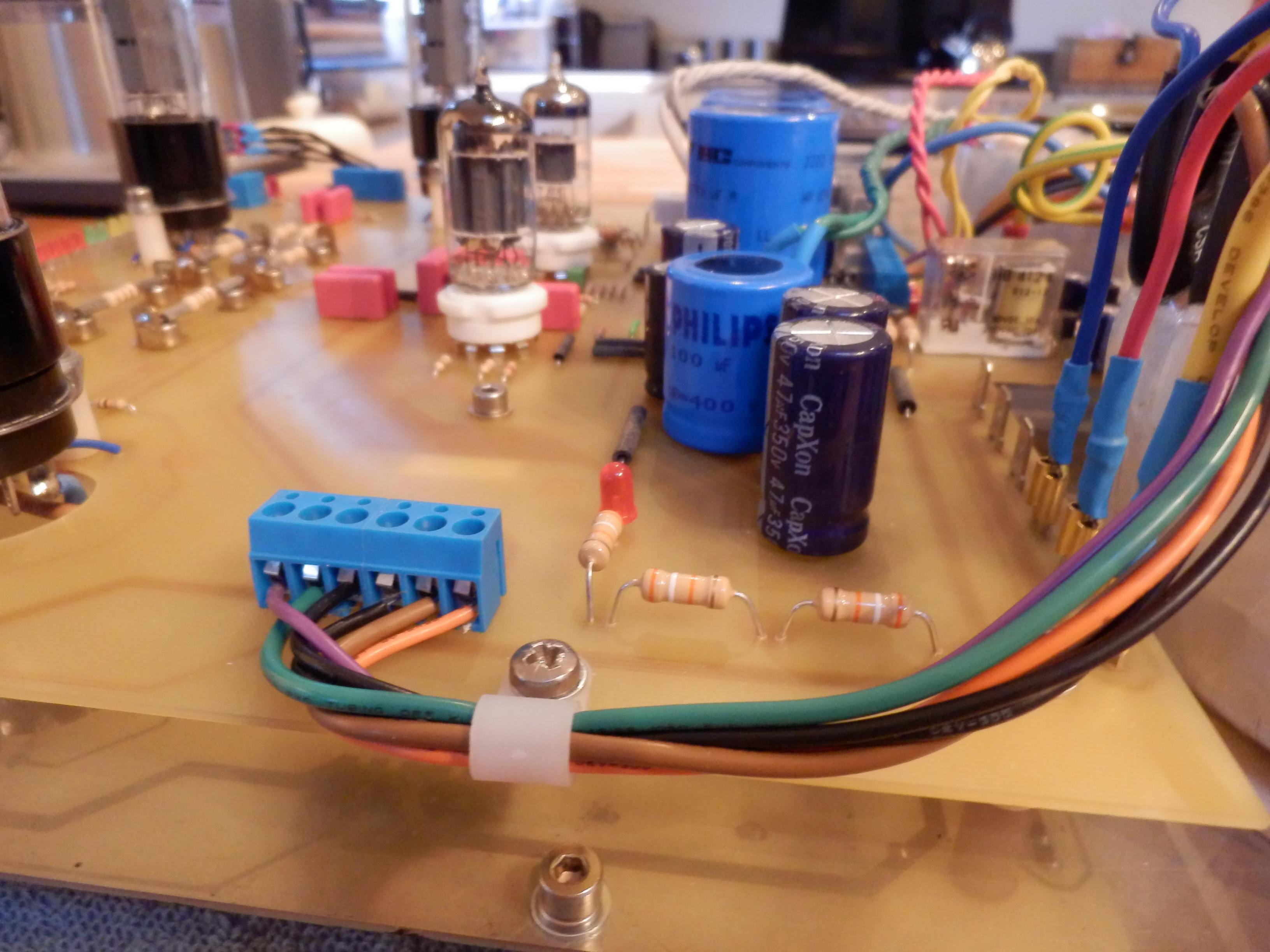

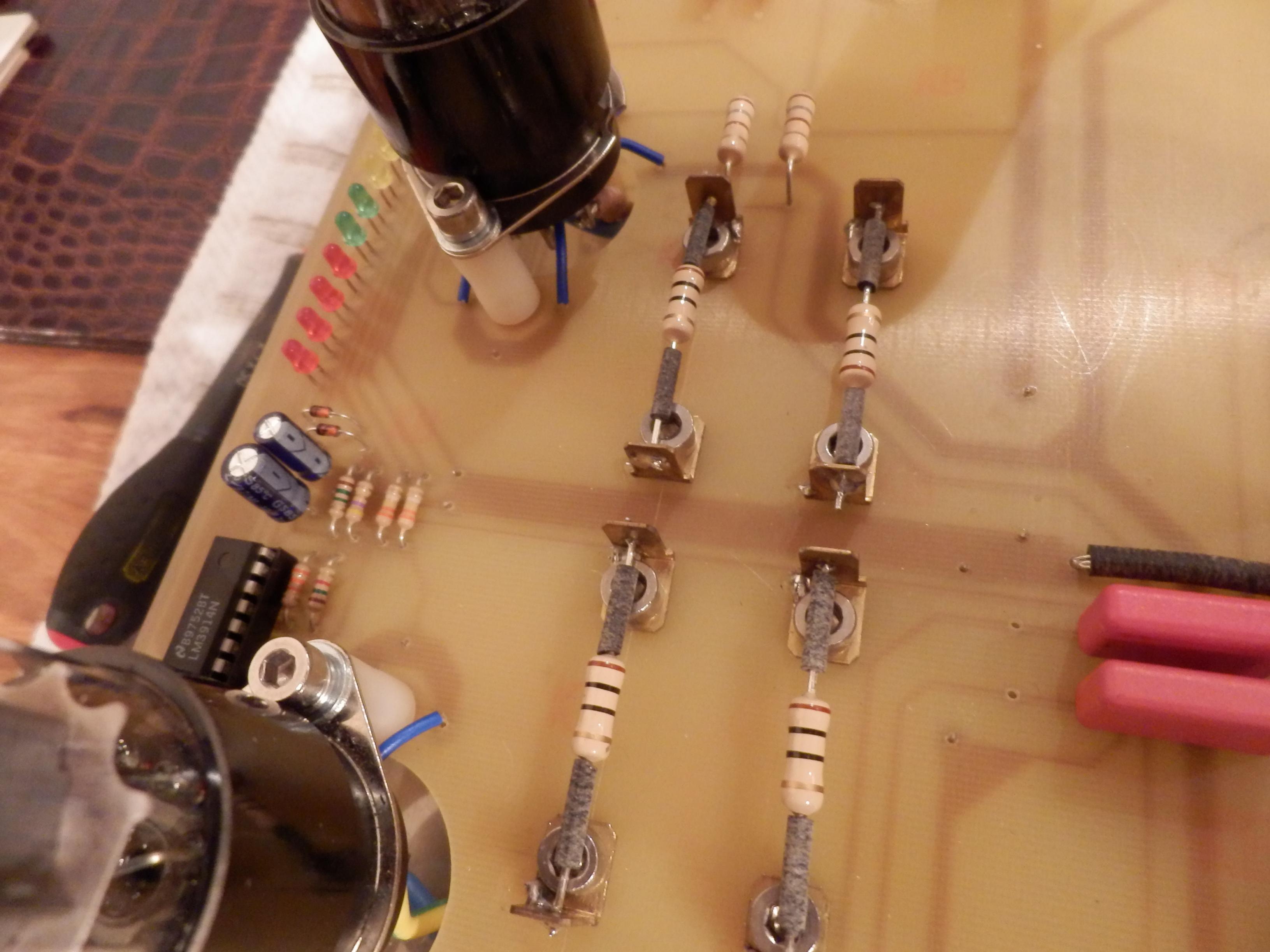

Nick again the board is now complete ready for the 1st fire up. Just need to make a bracket for the speaker terminals etc.
This a 1st attempt at a gerber file conversion from artwork, the PCB is 2 oz copper tracks ... nearly complete, then onto a full stereo version (monoblocks) then a kt88 class a version.
this has been a long project .... anyone else interested?
enjoy the pics

Very nice work, indeed!
The original output transformers can be found at Plitron homepage:Toroidal Audio Transformers

Yes, quite a feat you pulled there - making a copy of the Velleman PCB, very impressive.

nick,
as i told you i have modified my 8011,
I have replaced the chinise original output transformer by the LUNDHAL
1623 P-P well known. Result is good and it is a plug in replacement.

the lundals LL1623 need some customisation to your exact need.
Your have to select on the lundhal site the amplifier configuration triode or ultralinear or pentode... this gives you the wiring to do on the transformer
For myself it is the C' wiring.
As it is a triode configuration you will have 3 wires in and 2 wires out.
It is not difficult but needs some attention.

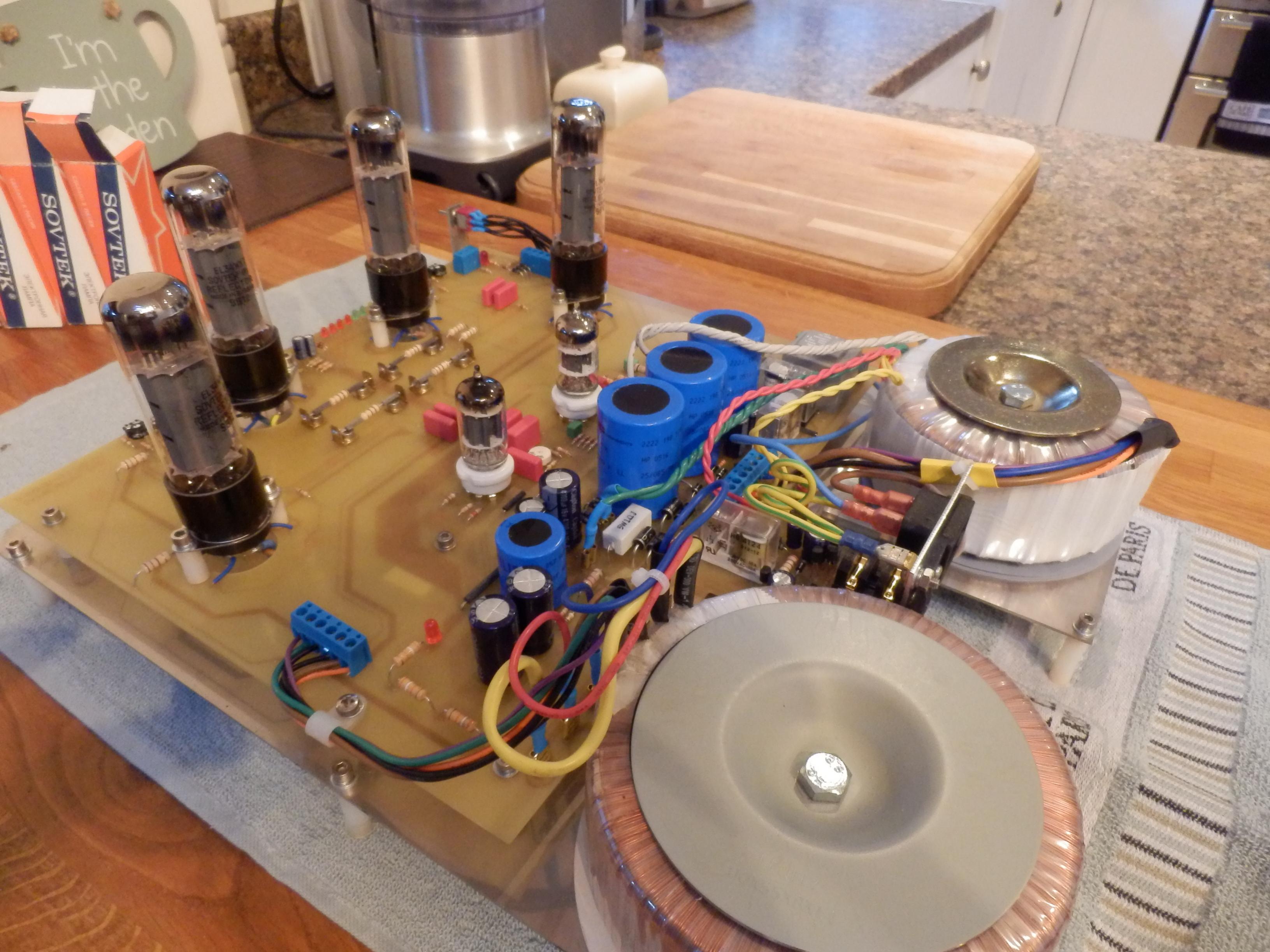

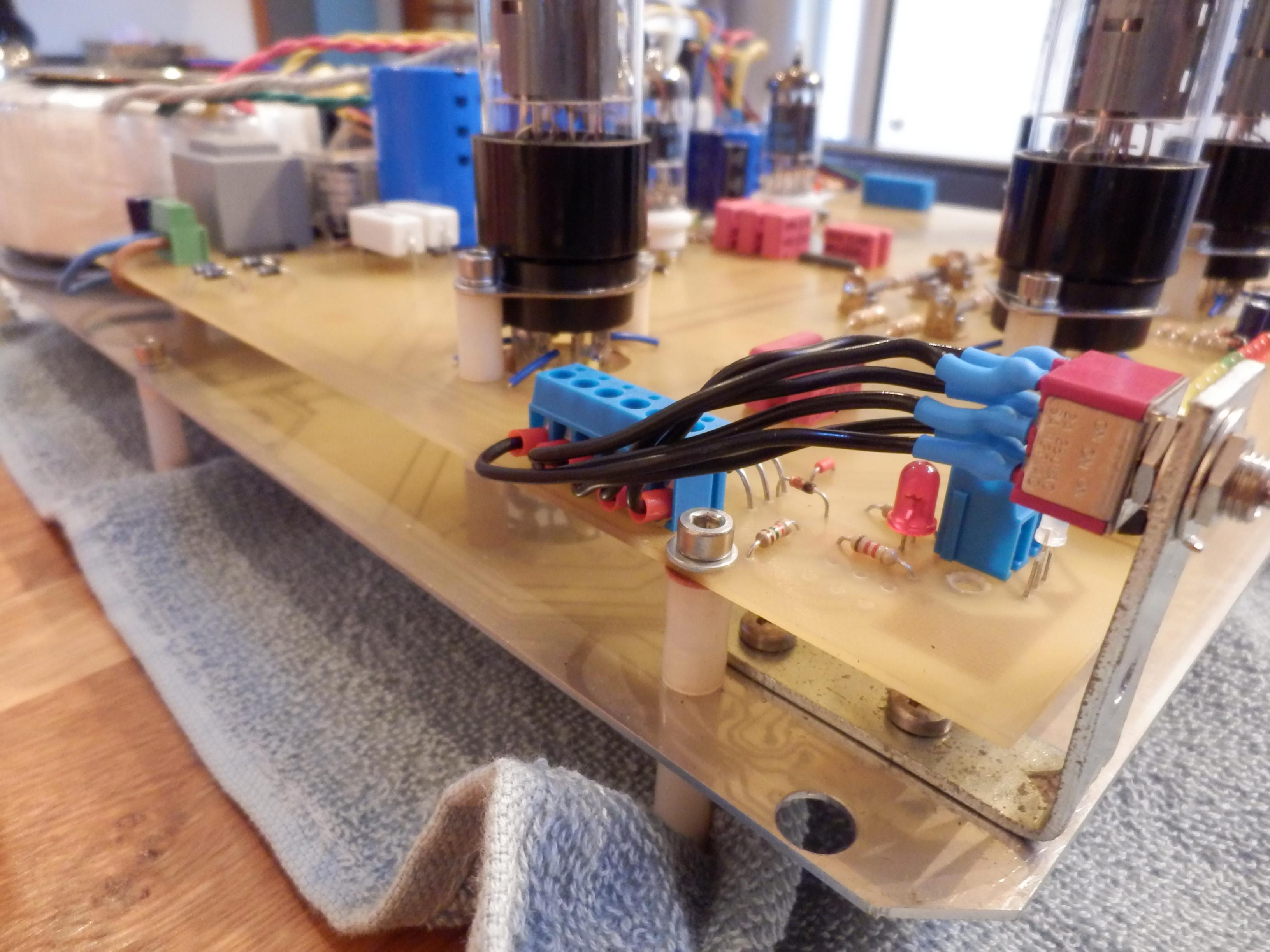

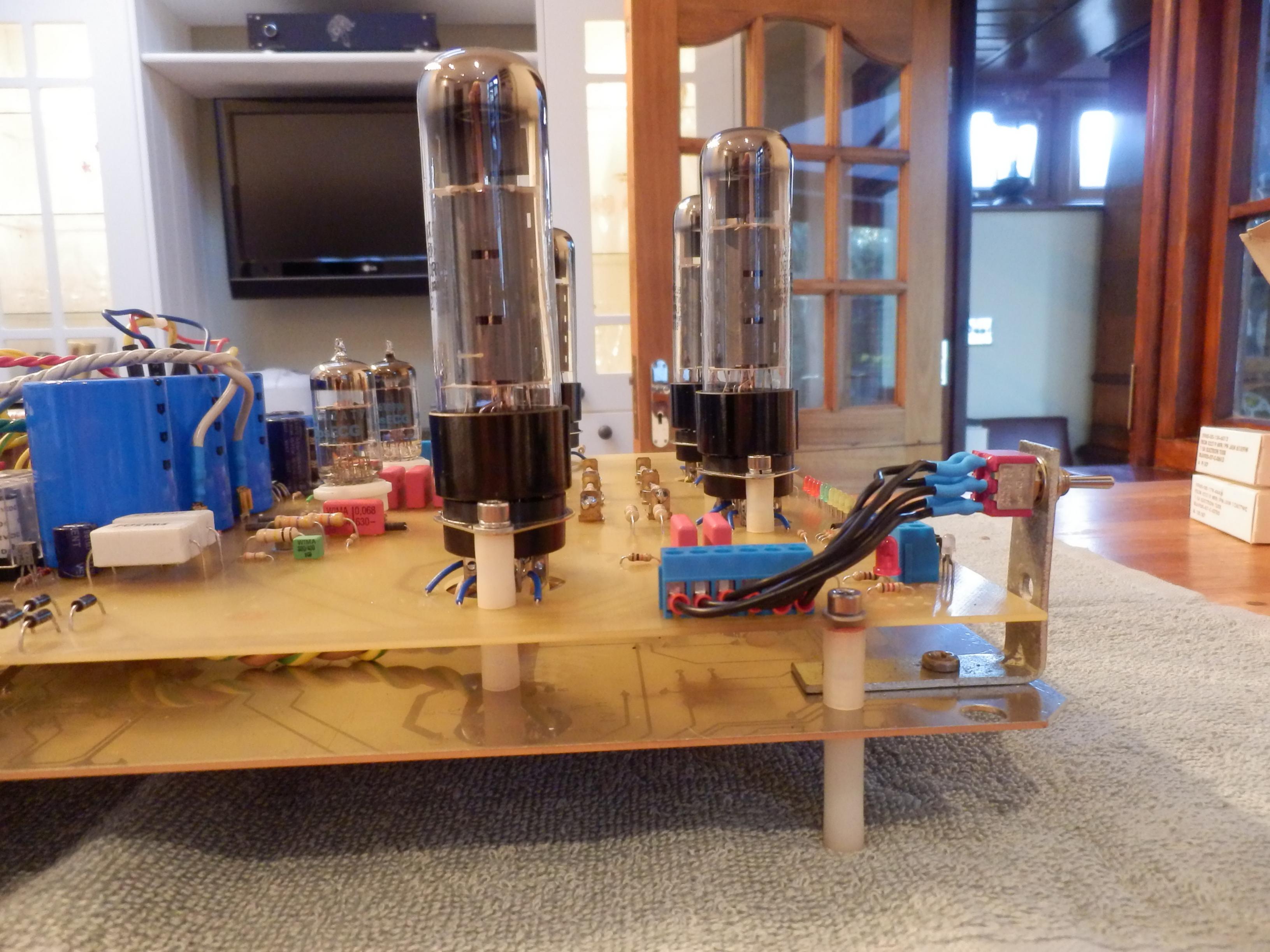

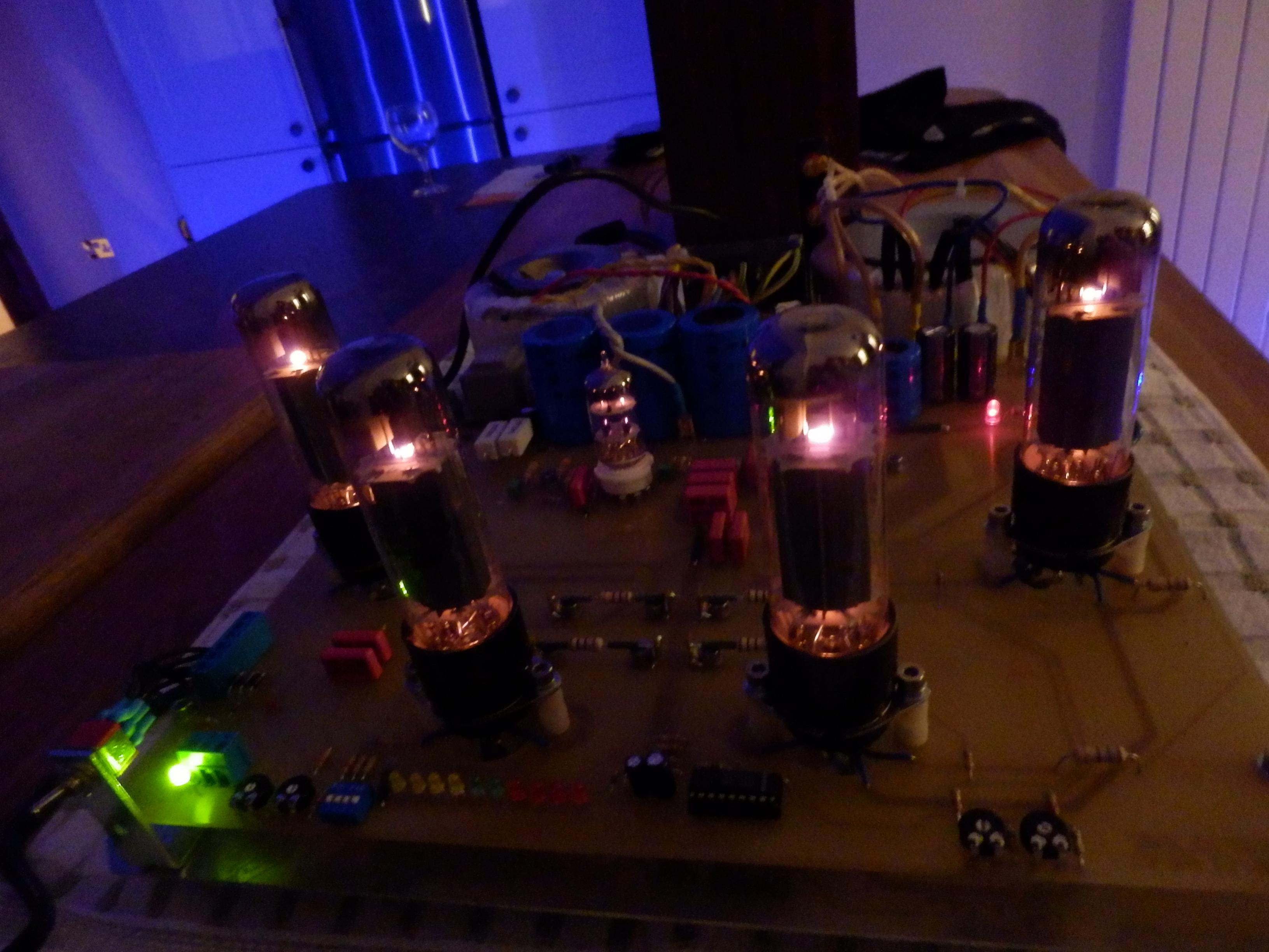

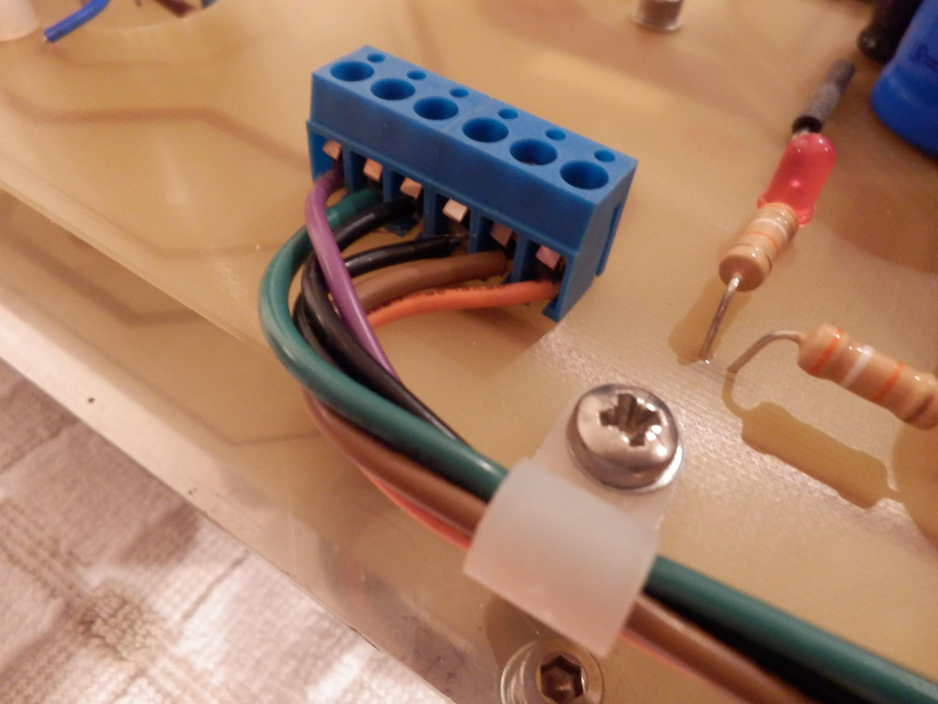

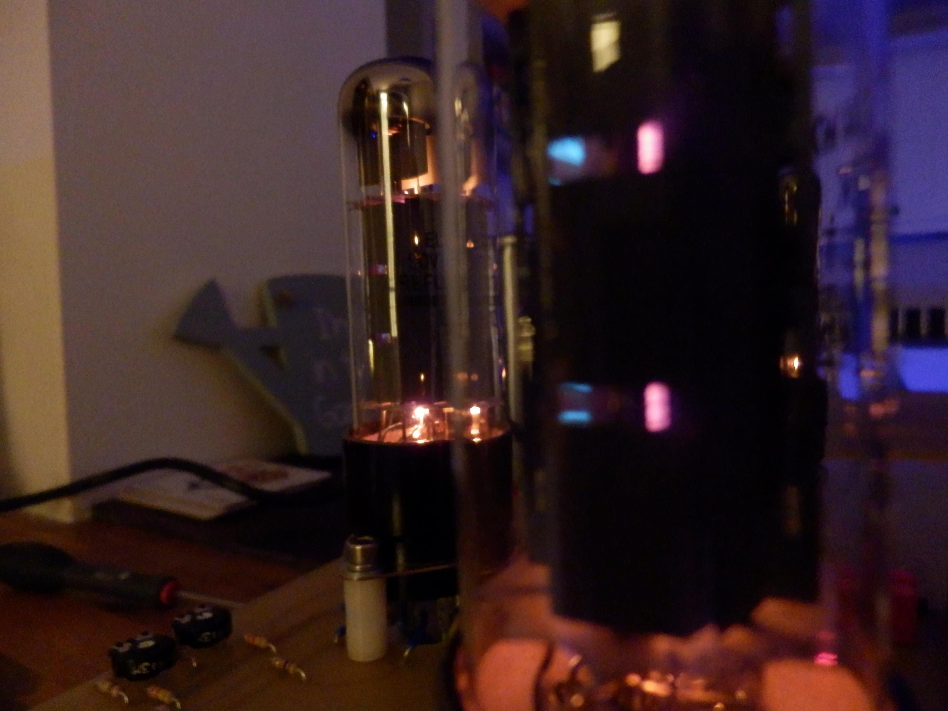

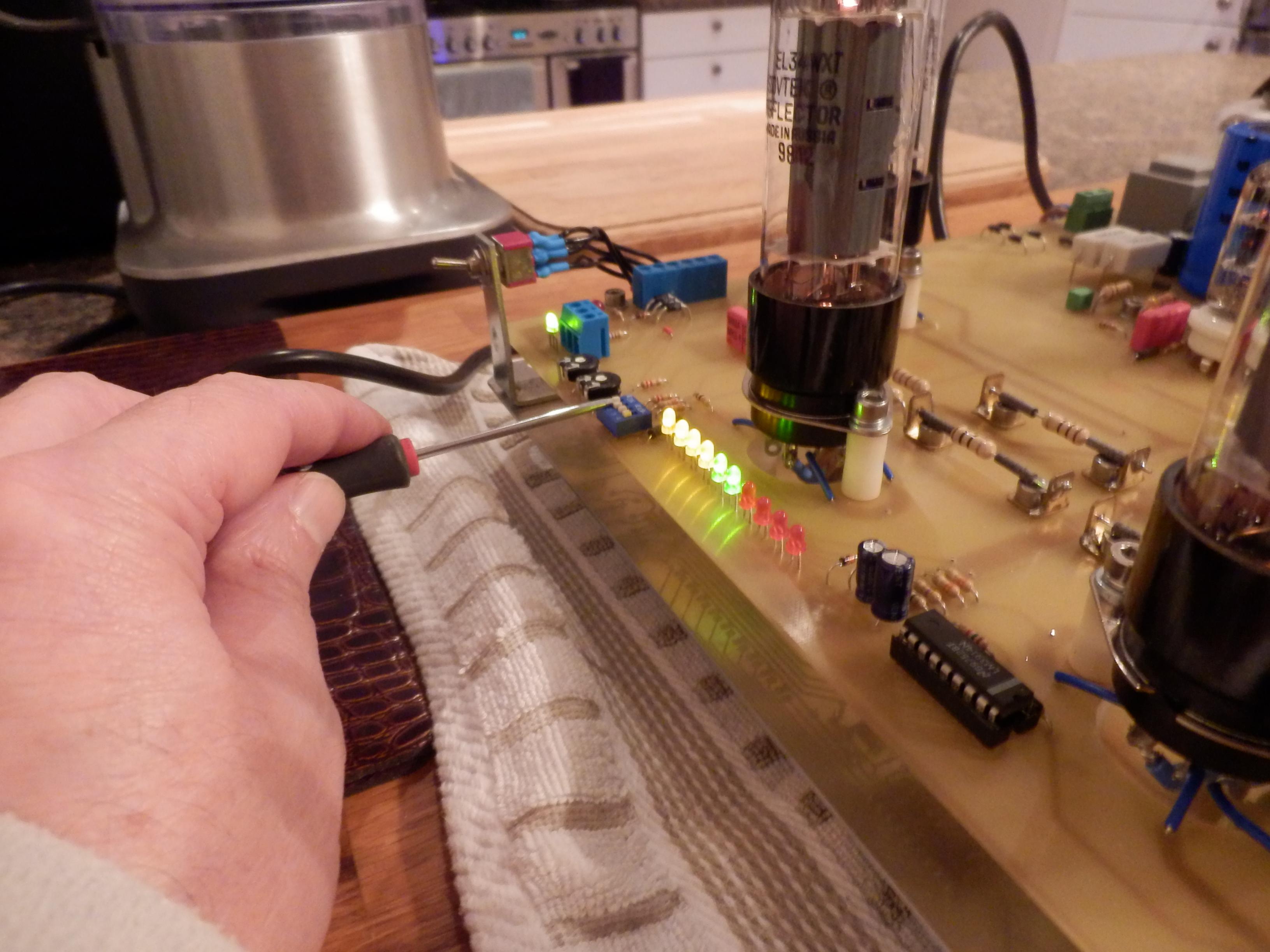

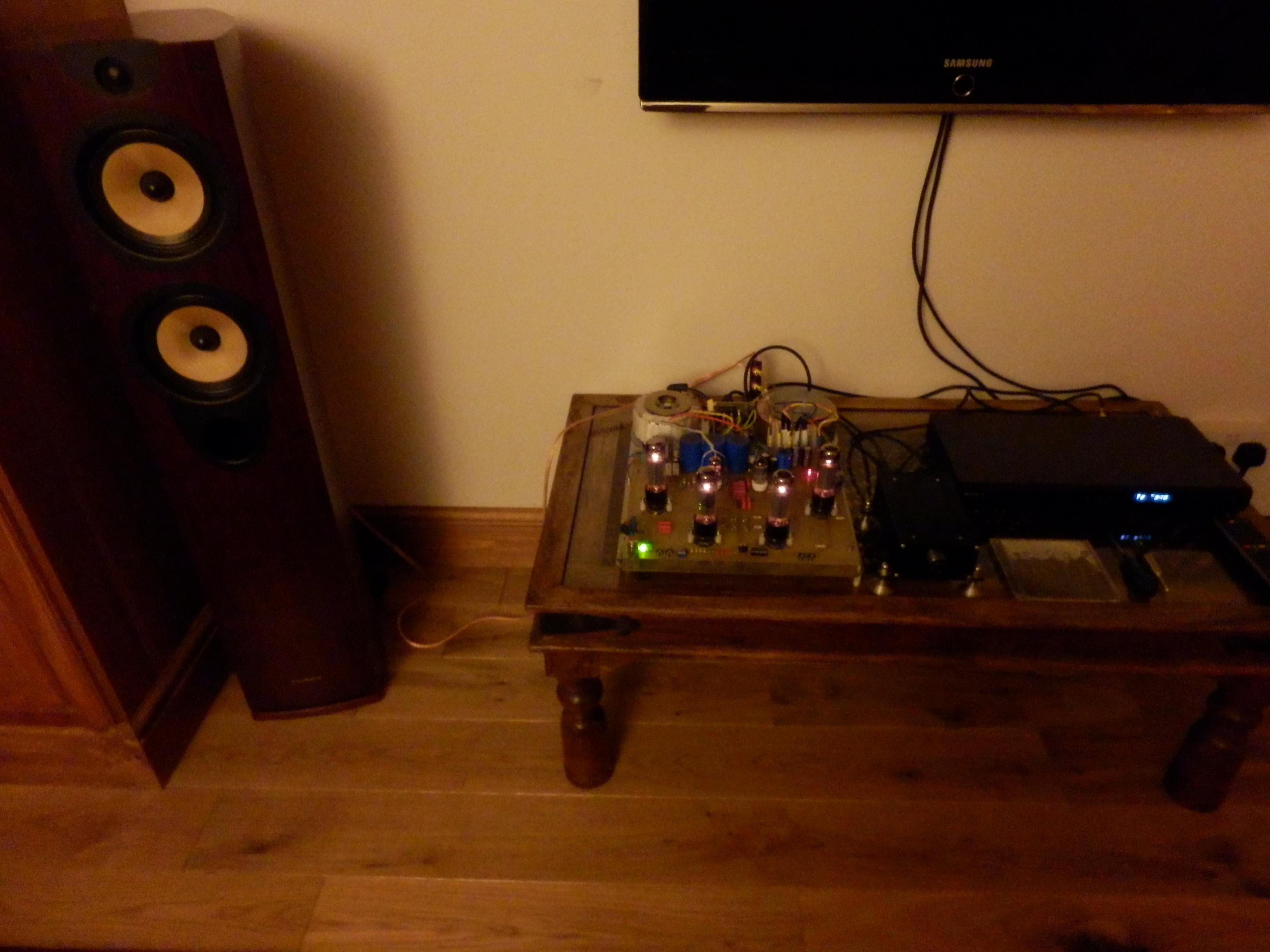

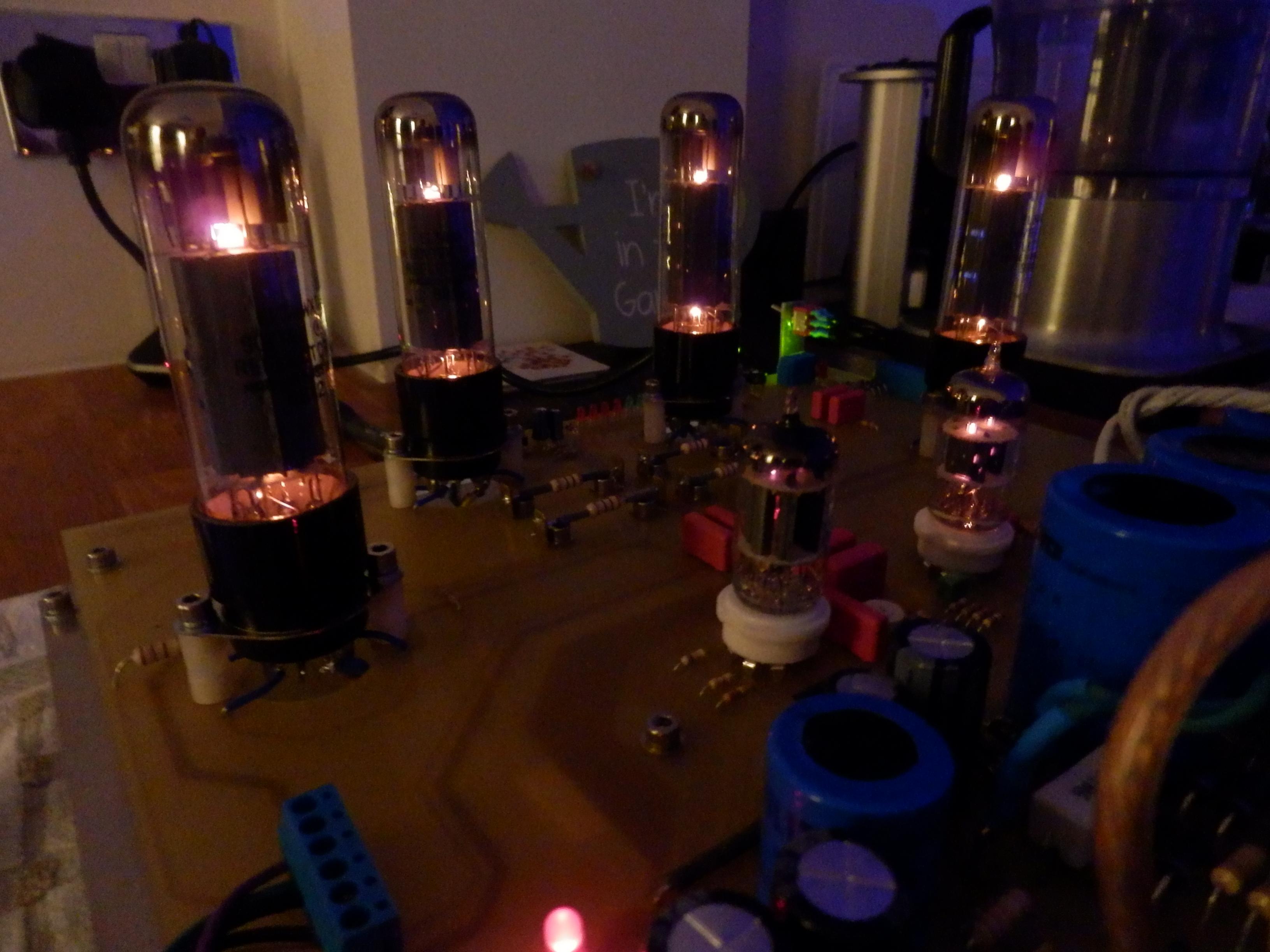

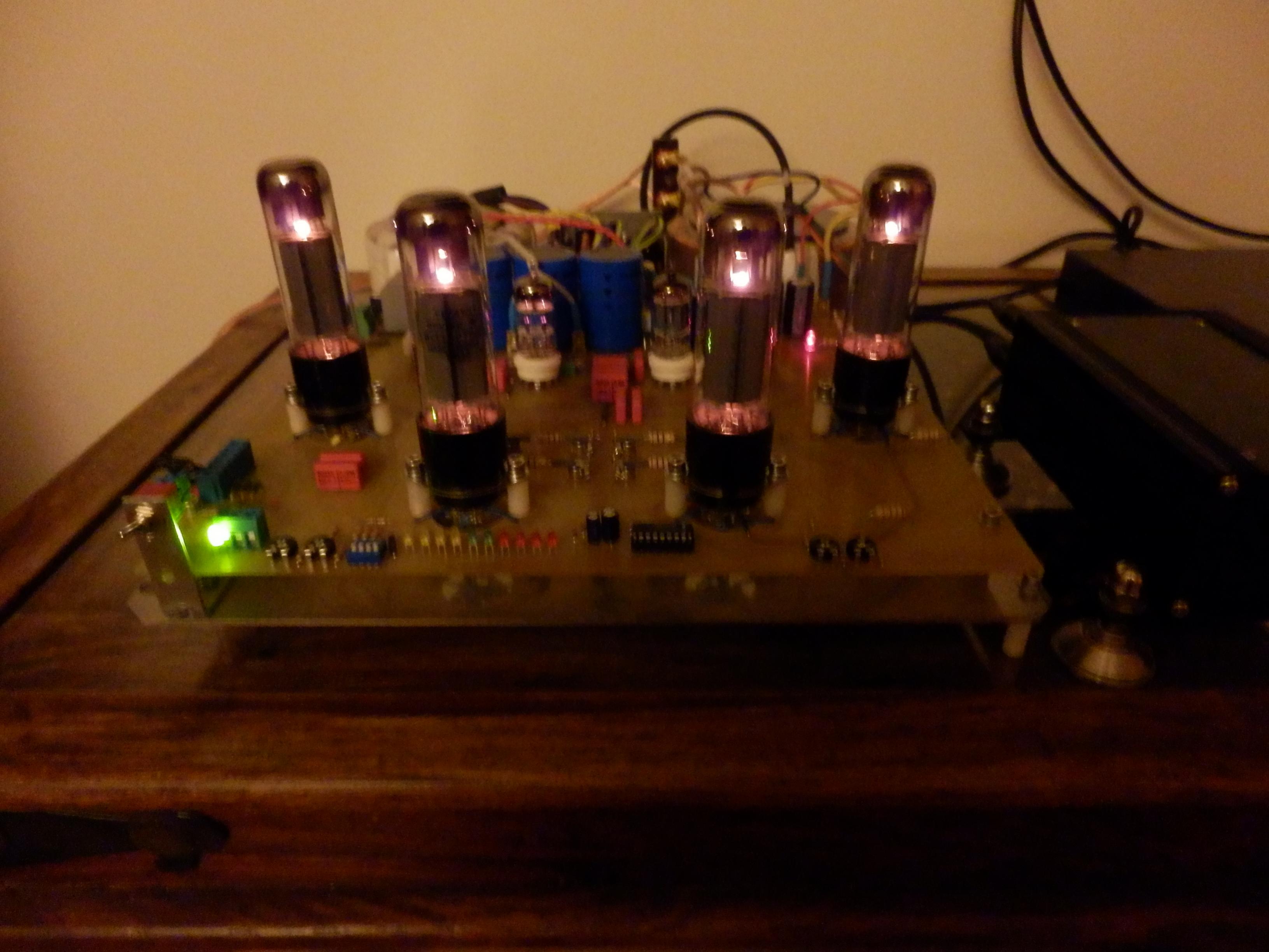

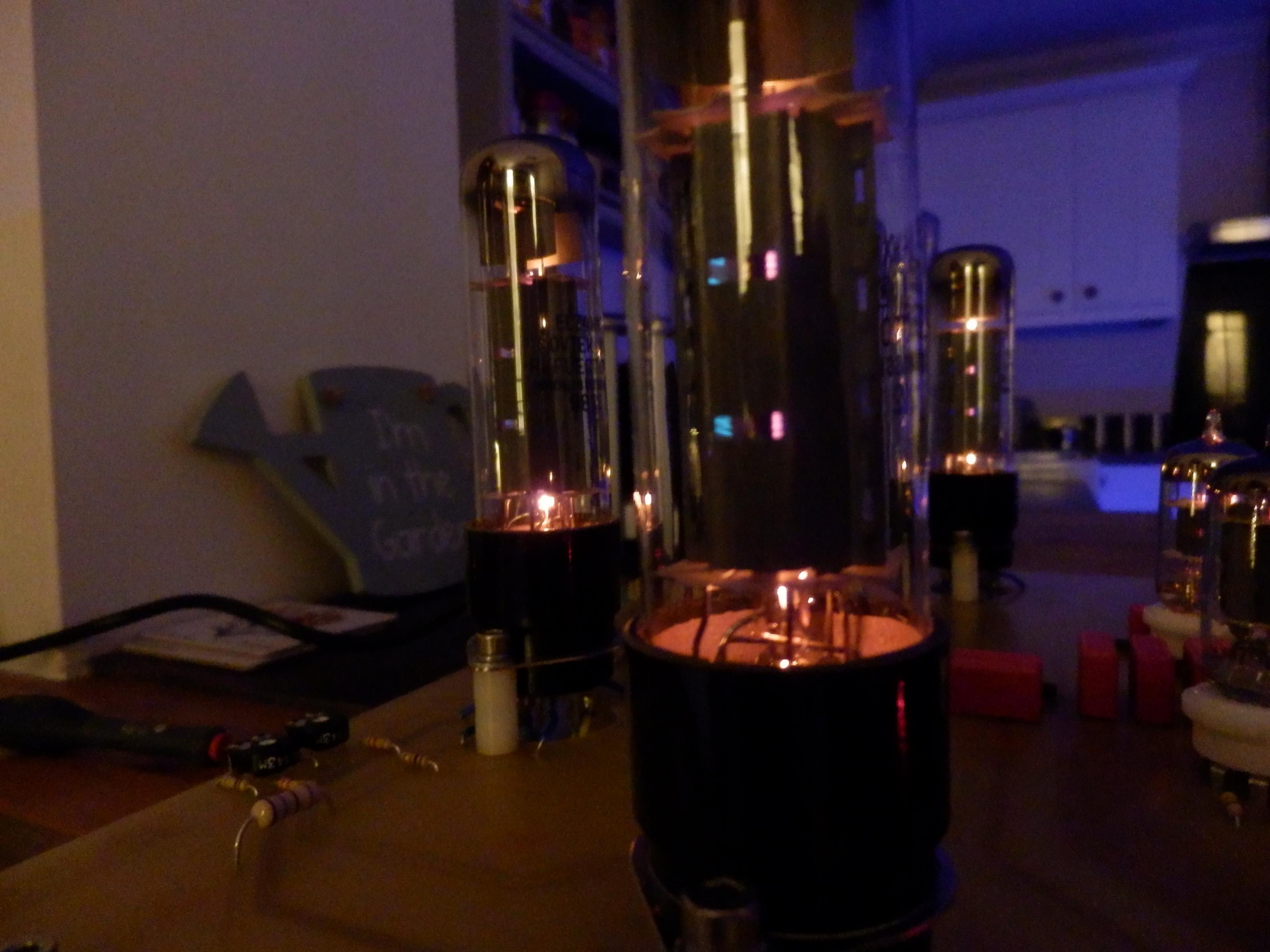

Hi Please find some attached pics of the K8011 being fired up for the 1st time.
The only fault I found was that one of the bias leds was the wrong polarity, apart from that all seems ok
will check today with music .. the only true test

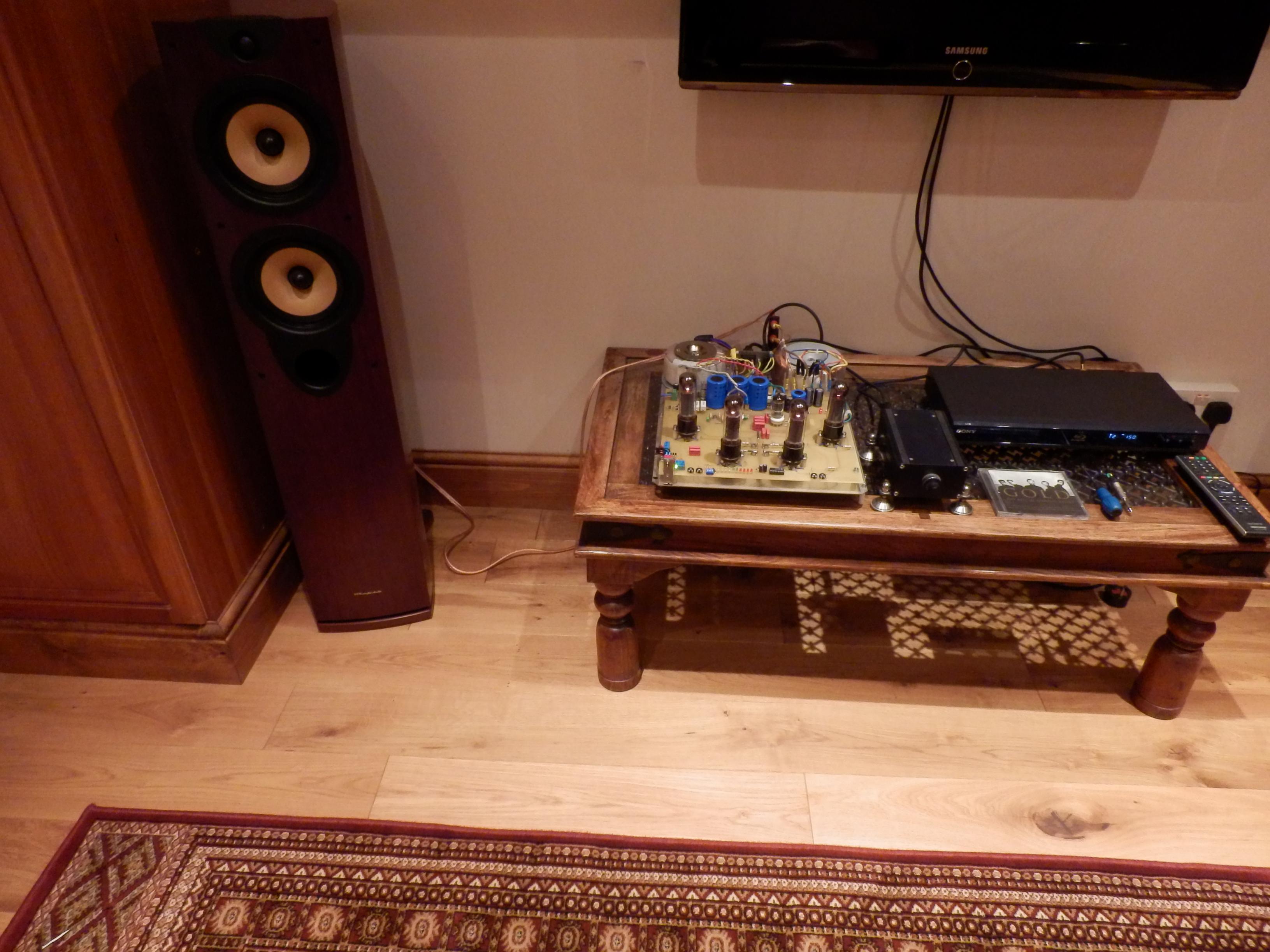

Hi
well end of a journey, it all works and sound great, treble clear and bass well controlled
Just need to put in a case and make the other channel .. then on to a KT88 version, currently using sovtek valves .. sound ok to me
regards Nick

Hi

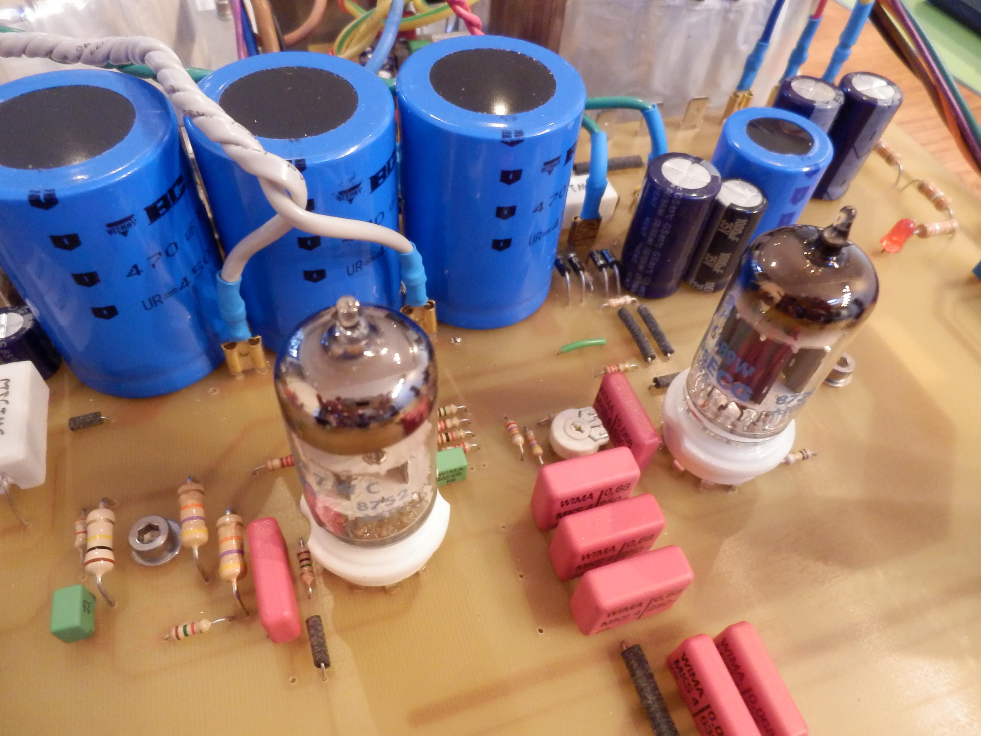

Nick again .. just to note that the main benefit from the newer PCB (apart from the fact that I now have a full set of Gerber files)
is that the board uses 2 oz copper tracks, this allows diyers to remove parts and not so experienced people with regarding soldering skills .. not to worry to much about the tracks lifting away from the board.

nick,
you are right about tracks lifting in the original board
i have experienced that myself as i have improved the circuit and that mean soldering and desoldering the same components a few times.
But in the same time for people who deal with the k8011 for the first time the original has the benefit of being engraved with the components positions
