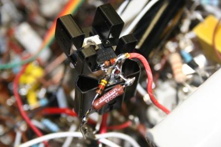

Only thing I don't care for with the design is they thermally bond the two FETs together on the heat sink. By keeping the lower FET isolated and in free air (it doesn't dissipate much anyway) you reduce long term thermal drift. The upper FETs current is dictated by the lower.
You can even just wire it up lead-to-lead with a couple little Allen-Bradley 1k stopper resistors and a set resistor, and screw it to the unit through the heat sink. Nice and compact.
