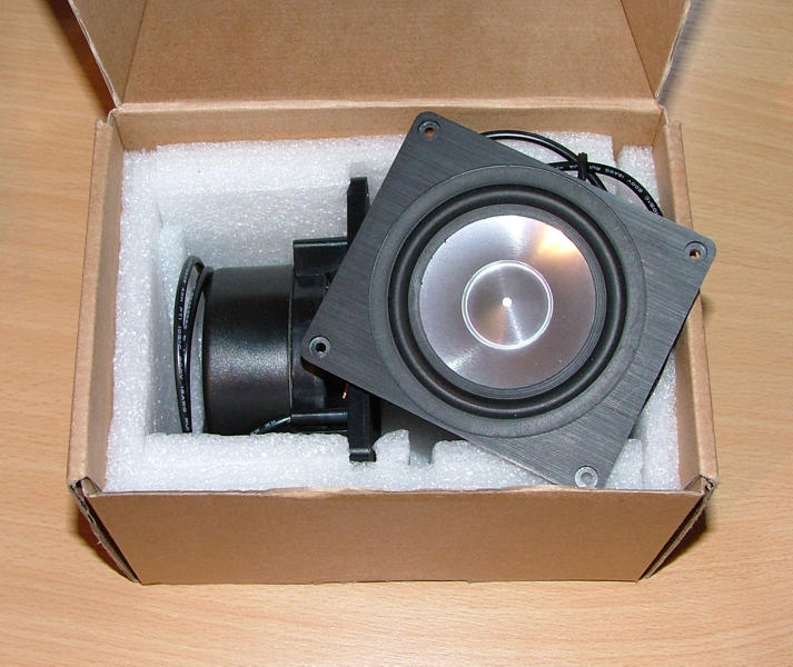

I don't know about spec. improvements, but I sure hope they have solved the fluid leaking problems...
From what I can gather, it's a known problem and one of the things being addressed ready for the next run. It hasn't occured to all the drivers (mine seem to be fine). One of the perils of going from relatively small batch production of the JX53 to longer production runs on the JXR6, I guess. If the driver is leaking, get in touch with the Jordan distributor and they should be able to sort or replace it, I'd have thought.
Colin, I have already done as you suggested and did contact the distributor a few months back. The replacement drivers suffered the same fate. Maybe something is happening in the shipping process from China to the US. The last pair of replacement drivers received was bench tested for a whole day to ensure leak free status. I hope to return the 4 drivers I currently have once the new units are available. I assume the distributor I purchased these from will agree to this request. They have been really great to deal with by the way.
Aside from the leaking fluid, I really like this new driver. I have been playing around with a new design the past couple of day. I will post more on this when I have more data, but here is a short summary.
